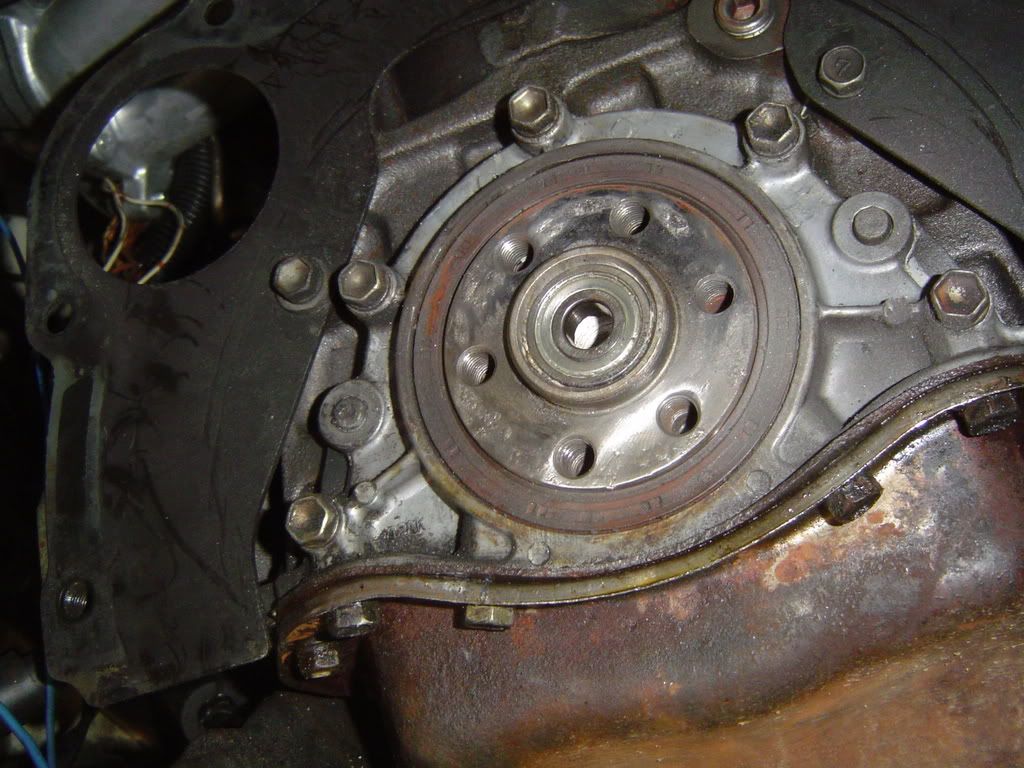

Here's what my crank looks like...

That looks pretty boogered up. Can't really tell if you can smooth it out by the pic. Towards the bottom it looks like it's dished out, like something has ground it out. You'll proably have to put a straight edge on it to find the high spots and see it you can salvage it in place, check it with the flywheel if you grind any on it to see if it will set flat aganist the crank. That looks like it's going to be hard to save it in place without pulling the motor. You will proablly need a pilot bearing either way.

I'll take a pic of it the flywheel later, But It looks the same as the crank, kind of boogered up. On the bottom of the crank is where toyota attempted to repair, but they decided it needed a new crank.

I think I'd try to take the high spots off with a flat file. Yes, its slow, but if you take off to much, how are you gonna fill it? Don't take a grinder to it, it'll cut to fast, making it very difficult to control, and it'll also get the steel pretty hot. Take the flywheel to a machine shop, and have them resurface both sides.

Sounds like this is where your problem originated. When the flywheel bolts were loose, the shearing force of the crank vs. the flywheel probably stressed the bolts. There's also a good chance that the friction of them rubbing against each other is what caused the damage to the crank and flywheel. The high spots on the crank do look more like metal added to the crank, and not gouges with built up ridges. I'm wondering if maybe the loose bolts didn't stretch the holes "out-of-round", causing them not to hold correctly? Don't really know if this is possible. Maybe someone with some engineering experience could chime in?
I'd get new bolts at the very least.....
