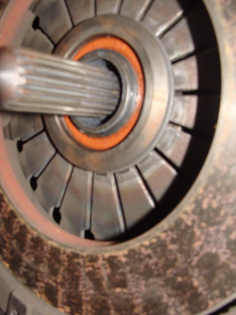

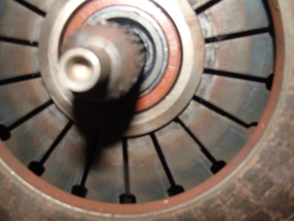

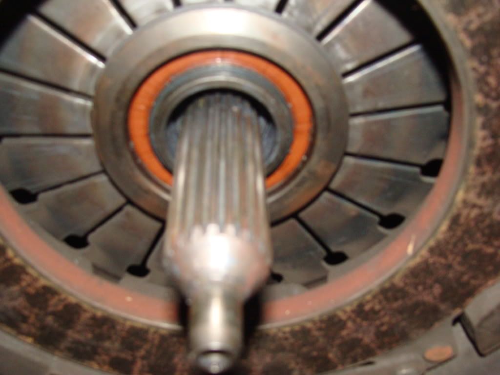

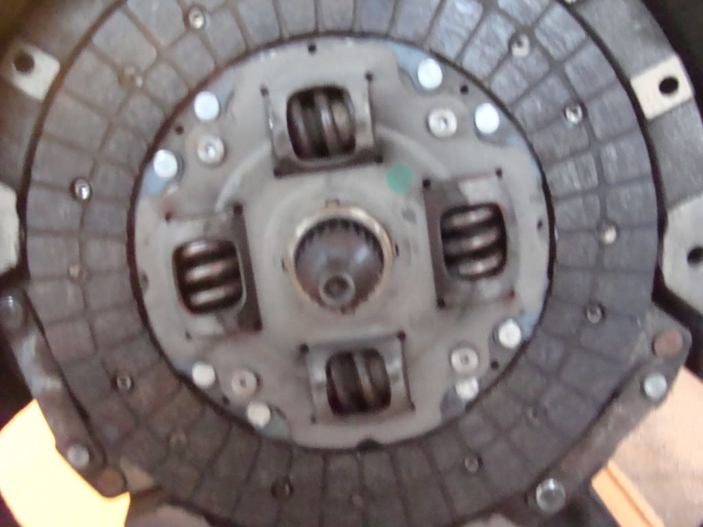

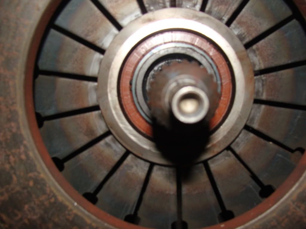

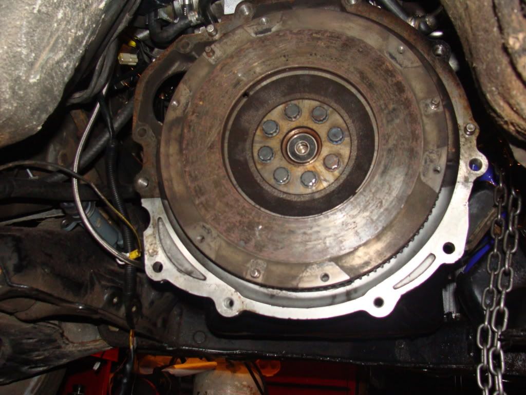

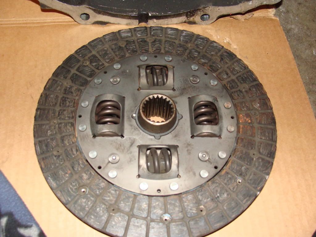

Alright transmission is out. Here are the pictures, and it appears I even placed the clutch disk in correctly, so here they are, I still do not know what is wrong. All the clips as well seemed to be there.. man oh man. By the way, no fun removing the transmission from the car, I would ather pull the motor..
This was facing the pressure plate so I know I placed the disk in correctly.

IJ.;1530486 said:
Looks backwards to me...

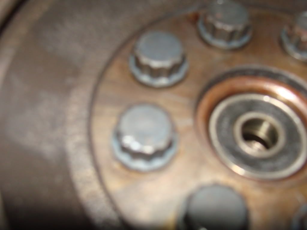

Pic of the flywheel/bolts please.

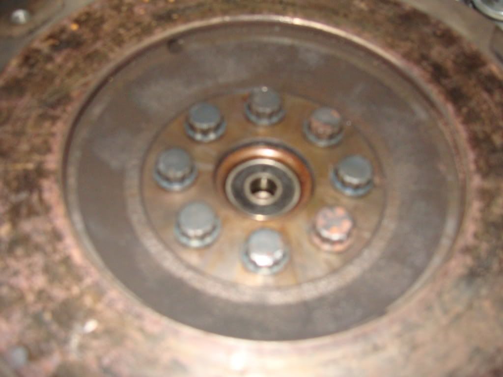

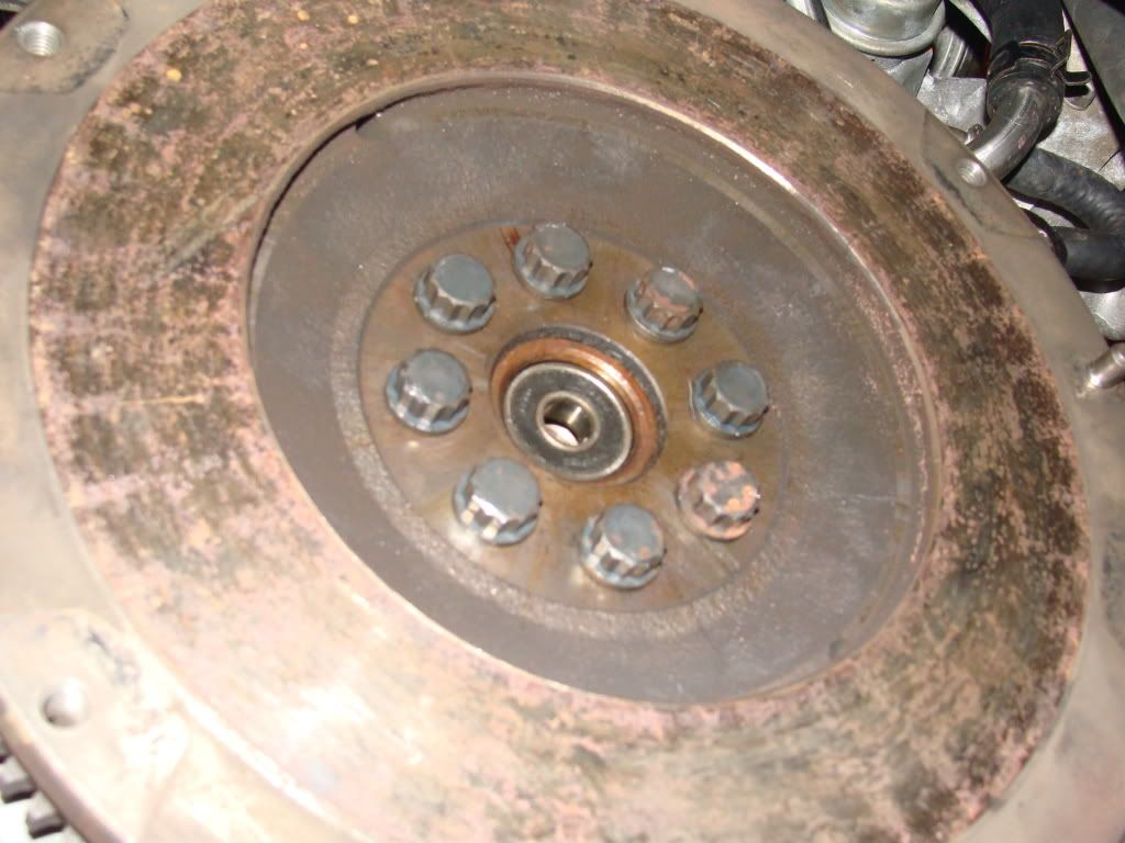

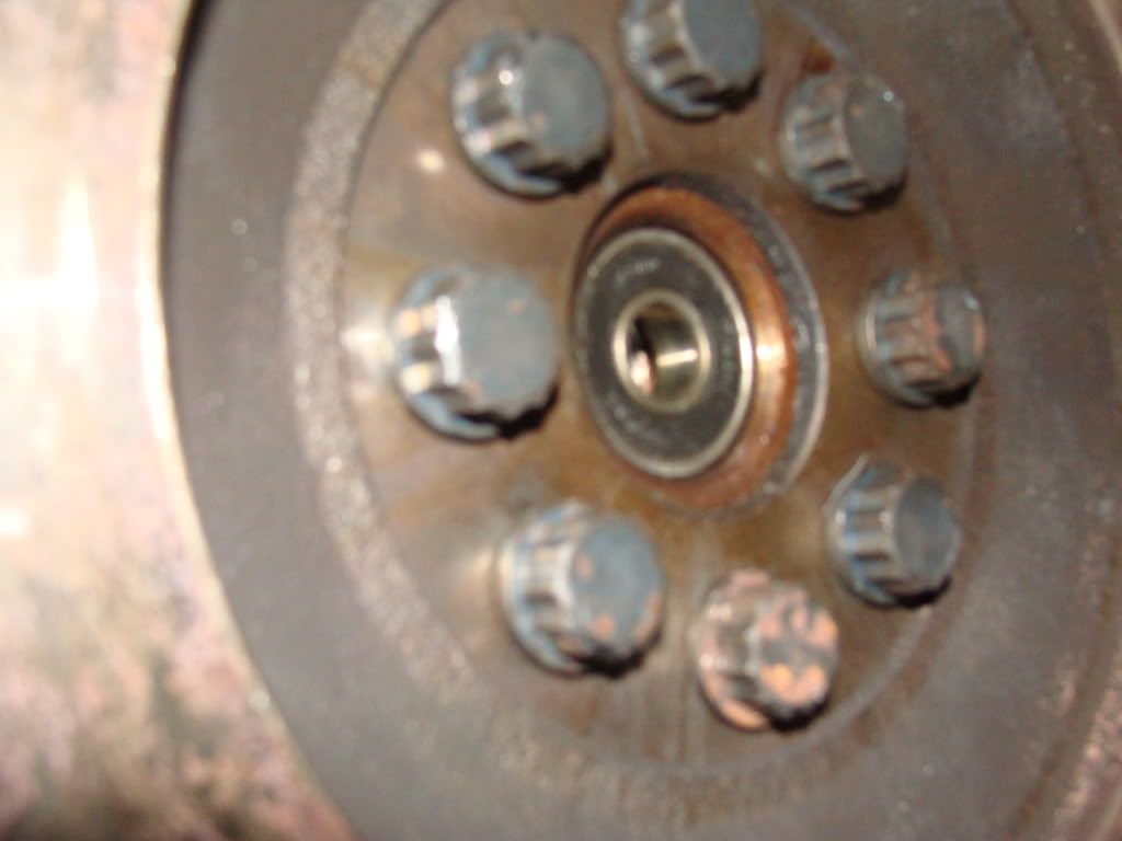

Uploading them now IJ. Also when i took the pictures, I am not sure if you're looking to see if the disk was hitting the bolts, but they look a little scuffed..
So the way the disk is on switch it?

Turn the disk on the flywheel to see if it his the bolts. It looks like both sides are the same almost.

Fixed. I had the disk is the wrong way. I should have taken the time to do it correctly. When IJ. said, get pictures of the flywheel bolts, I sort of had an idea of where this was going. Thank you guys, I will put it back together and it will be running. Have a good day.
