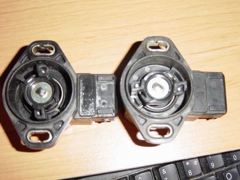

heres the difference between the two TPS's:
Note the orientation of the actuator.

SURUKO;1392609 said:
and if i rewire the tps plug will the n/a tps will work in the gte ecu ??:1zhelp::1zhelp:
You don't rewire, you change that thingy in the throttle body, it's held on by one nut, and a washer. It's oriented for the TPS. Look at the picture.
