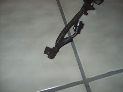

I found out a local junk yard had a is300 in it, so I went down and got the coils, plug wires and wiring, only problem the harness had been cut, can somebody help me out with wiring the coil plugs into the stock 7m coil pack plug?
use your existing harness on your 7m, just need to exted the wires for the 3/4 and 1/6 coil pack.
