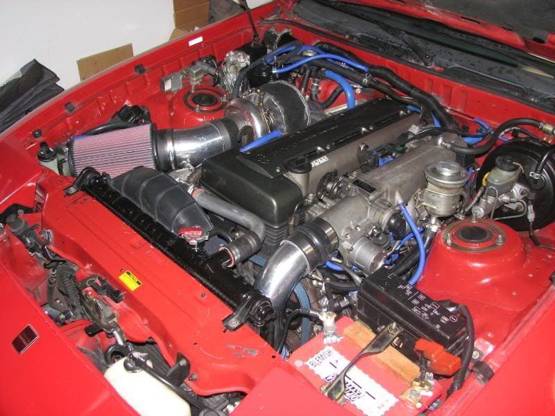

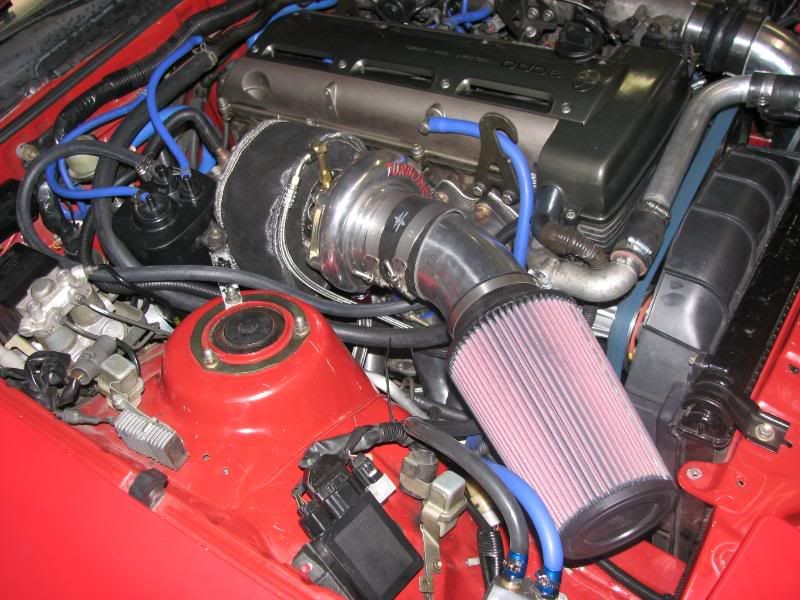

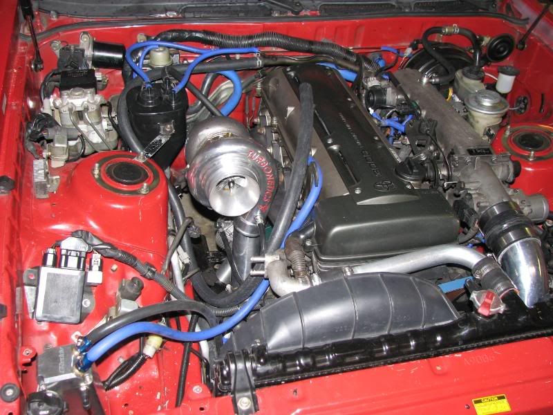

btw studs make the turbo install a million times easier
ignore the wood
the temp downpipe LOL
done!

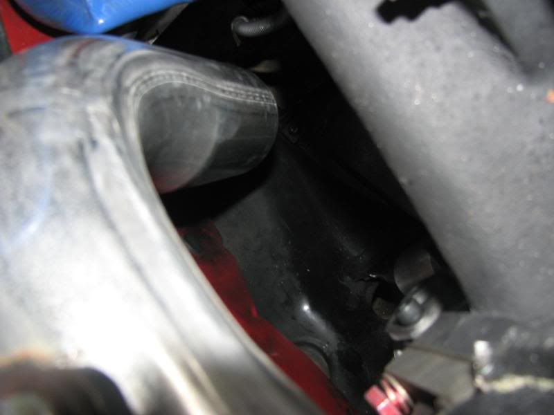

sigh looks like the injectors are going to wait - mightve fucked up my turbo. if you didnt see the thread its here http://www.supramania.com/forums/showthread.php?t=65038
one thing is that my turbo wasnt bolted to the manifold all of the way dont know if that caused anything, maybe my manifold isnt even all on the way... just shit i have to consider until my exhaust is actually finished... and boost leaks vac leaks etc.. as vac doesnt act normal when in the car (as in the vac/boost gauge going to 0 when you hit throttle it goes to -10 or something)

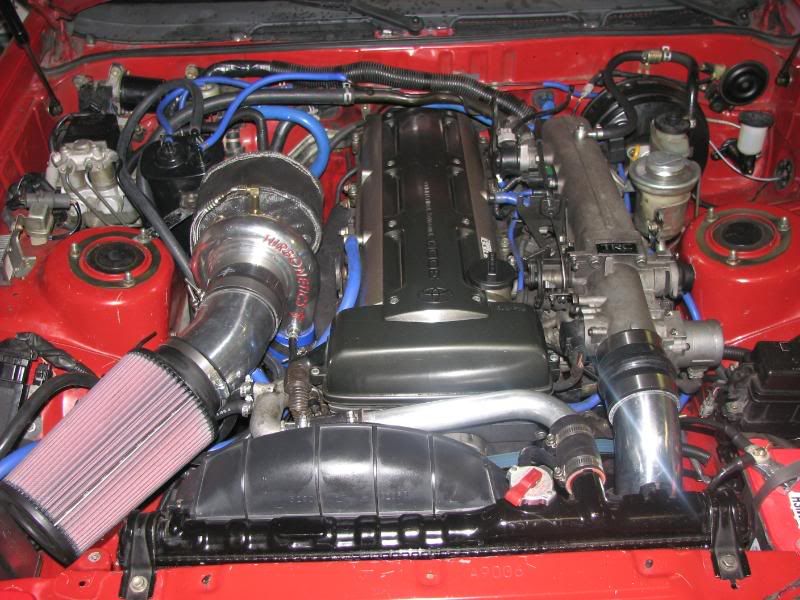

all problems fixed
full boost (1 bar) @ 2.5k-3k rpm in 2nd gear
i think i need a bigger turbo o_O
