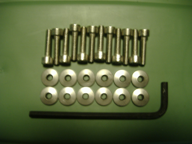

Tire Shredder;1063266 said:
you win!!
I've got something very similar if not the same on my car. The guy who rebuilt my engine suggested ditching the POS phillips head for those. I said do it.

hmm, I've heard bad things about the valve cover bolts that you got there. maybe it was just a fluke tho...

well the mistake most people make is that they think they are supposed to torque the cam covers down. They are actually designed to seal with minimal torque (thus the o-ring type gasket). They arent supposed to be squished absolutely flat. However they do require re-tightening occasionally.
so hows progress?
interesting, what have you heard? I figured anything is better than the phillips and stainless is :love: what's the story?
you can, but you just have to use a very soft setting. so soft its almost stupid on a normal large torque wrench. but it works if your wrench is that sensitive. :)
I hadn't planned on torquing them...just snug like on my 5m. My 5m uses the phillips screws aswell. I replaced the gaskets nearly 5 years ago and it hasn't leaked even with the stock phillips screws. I just tried to get them all equally snug by hand. downside is they rust and are half stripped. these things should solve those two problems.
