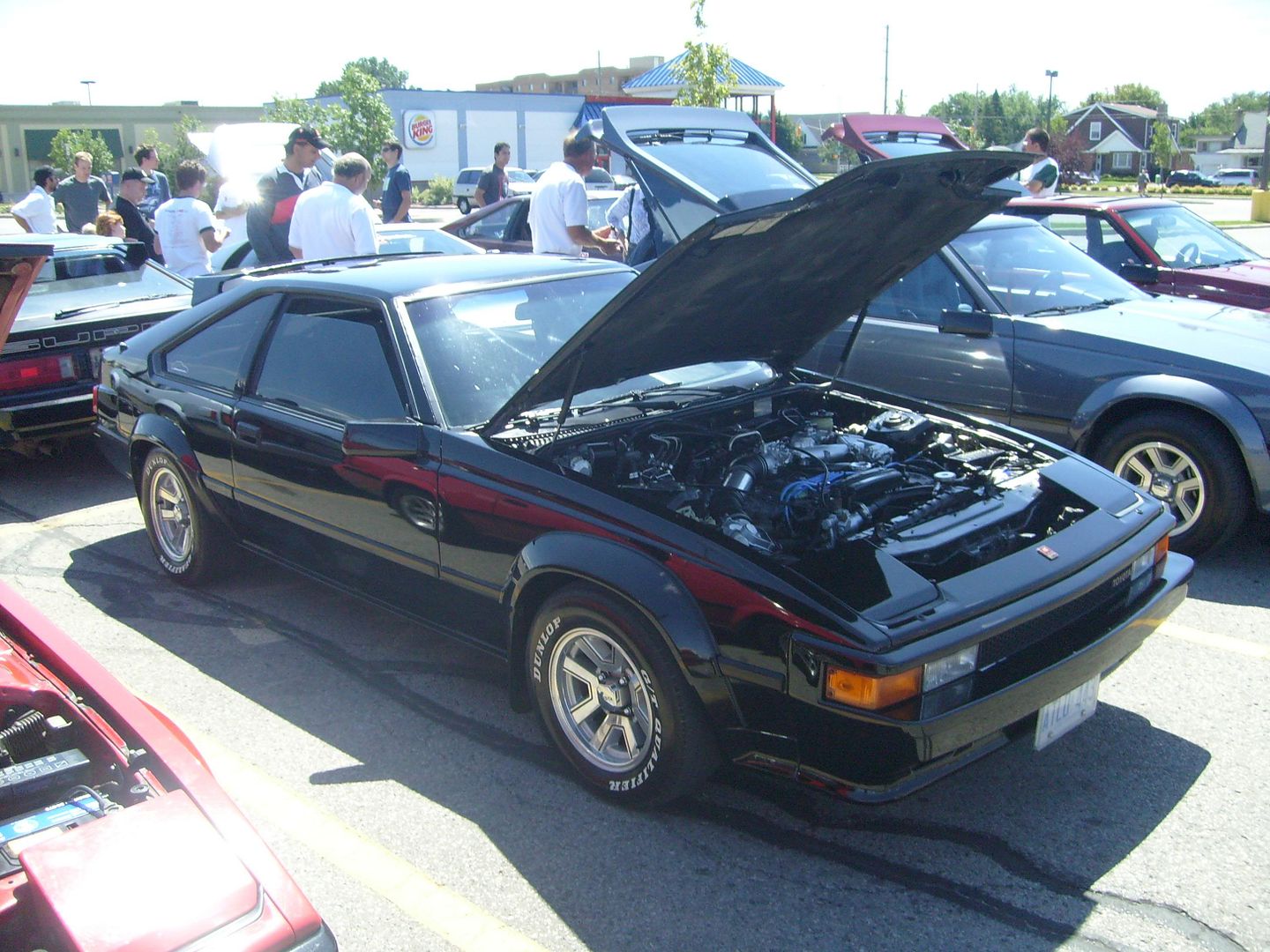

I'll get some proper pictures and videos once I have the kinks worked out and it's in a presentable condition.
in the mean time, here are some pictures from the meet taken by others!:
Credit for the photos goes a TSC forum member. Original thread here:
http://www.torontosupraclub.com/index.php?topic=1267.0
and then these taken by either geoff or Donn29 from celicasupra.com
