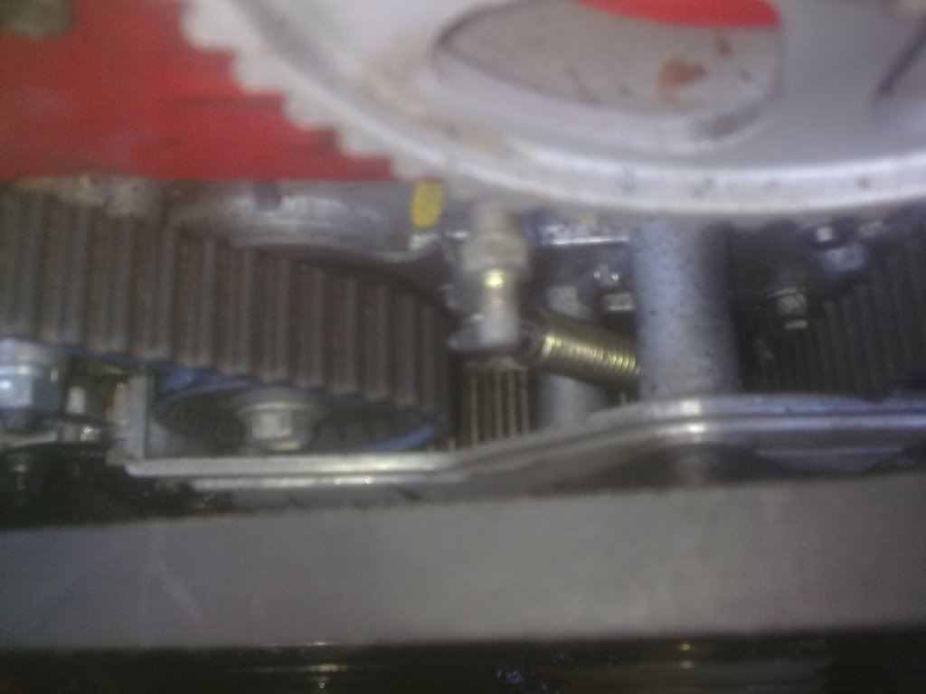

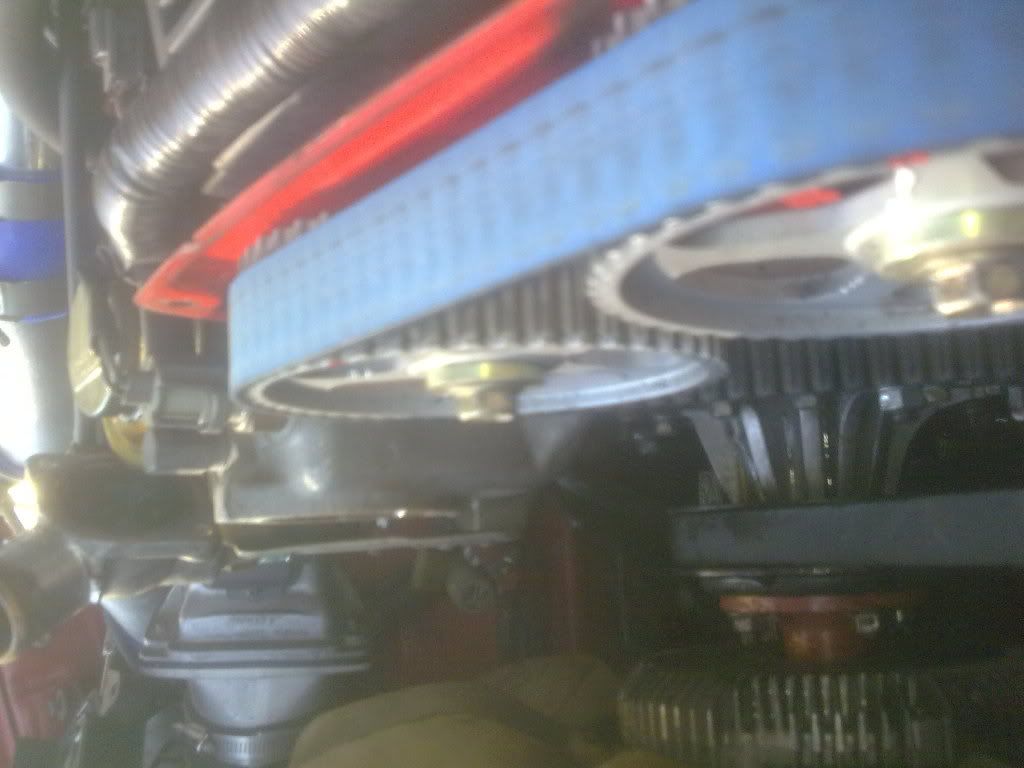

this gates belt has maybe 5k on it and has never been a problem but i started to hear a squealing noise last night so i popped the cover off and found it trying to come off the pulleys.
the belt still has perfect tension
any ideas?

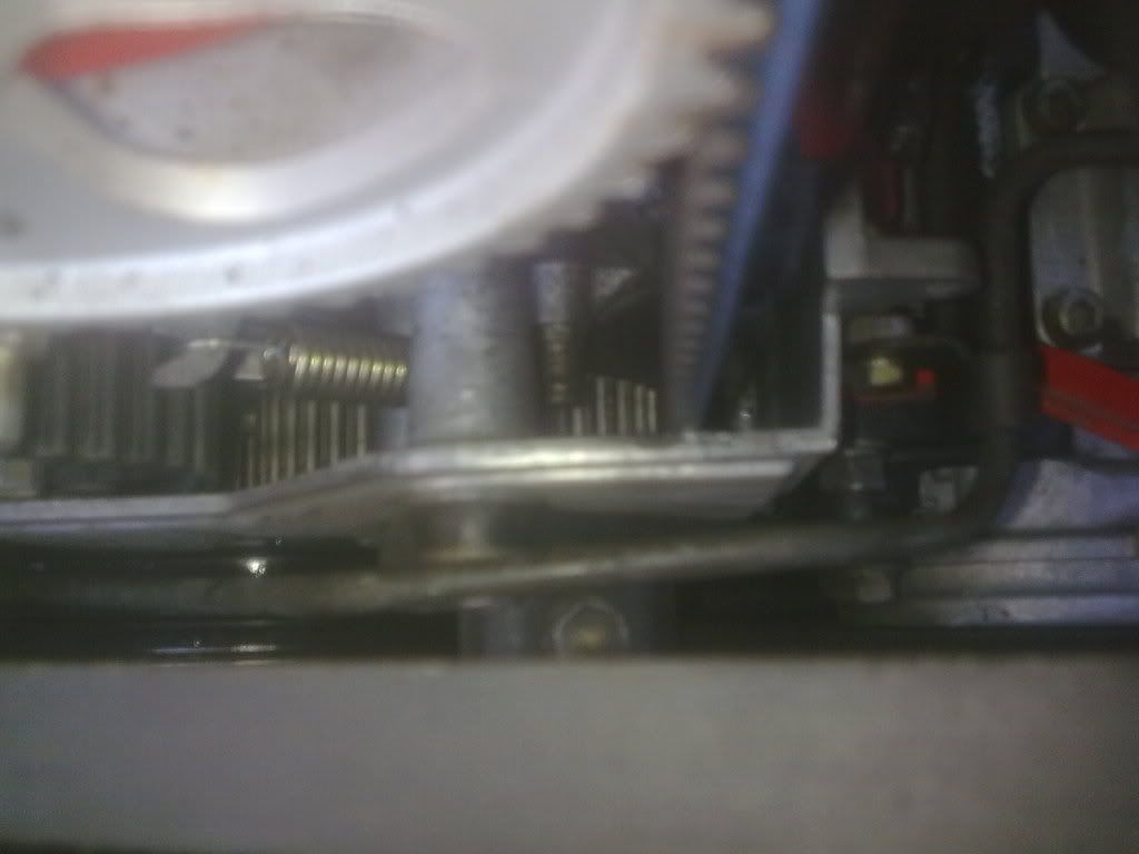

this is where it is hitting
the tensioner has a lip on the back side but my old metal one didnt

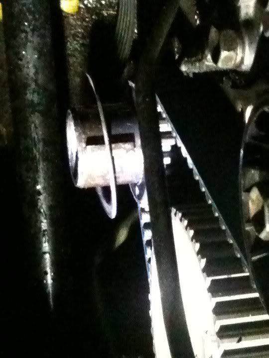

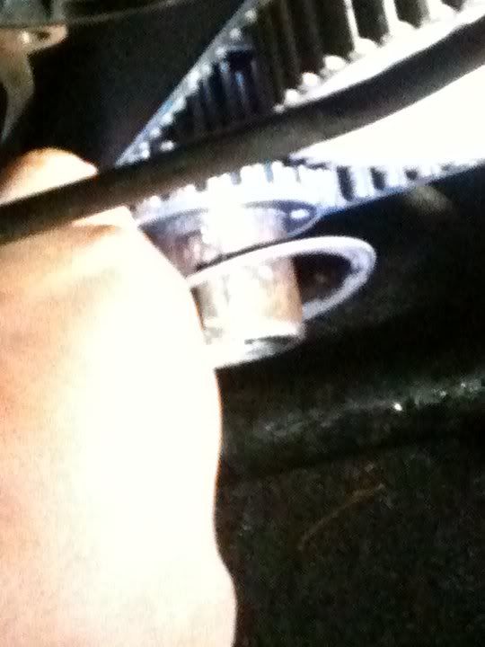

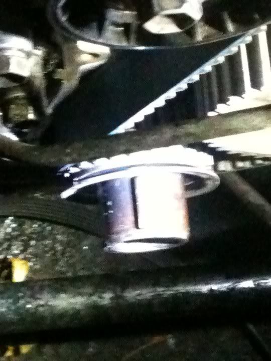

san supra;1649964 said:
CajunKenny was correct, it was the ring was broken.
how do i fix?
Ding...Ding...Ding... What does he win Johnny!? ;)
Good find! Yep, like Grim said, there's no fixing that gear. You just get a new one. :)

As I posted, new one is under $50. Well, if you buy from the right Toyota dealership, anyway. Used one should be fine as well... as a rule they don't wear much, the only thing touching 'em is a belt, which is distinctly softer than the gear. :)
