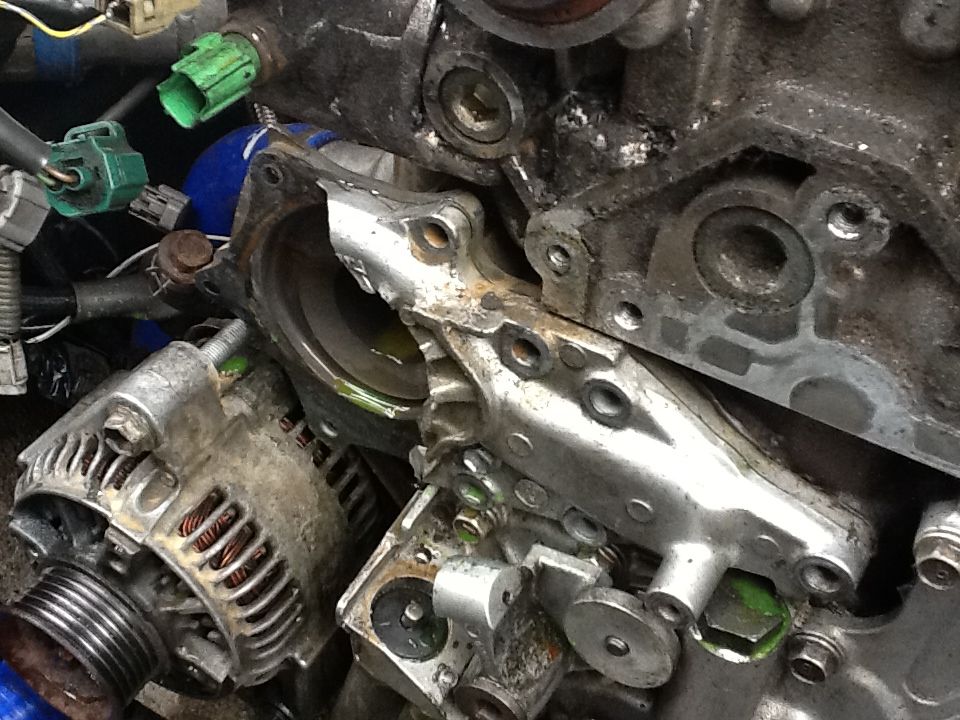

Was it possible that the mating surface was slightly uneven?
I could see that being a contributing factor... Otherwise, as Suprakid stated, maybe a bad cast.

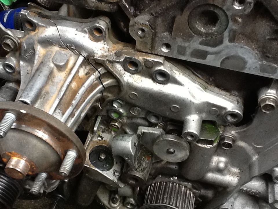

Couple weeks back I saw that some coolant was leaking out of the waterpump. Turns out a bolt was loose lol dunno how that happened? So I tightened it and everything seemed fine. Then last night I was driving the car locally and all of a sudden my voltage started fluctuating like crazy and the car was buggin out. And I smelled antifreeze through the roof. I was about 4 blocks from home so I drove in my driveway and popped my hood.
Antifreeze gushing all over my alternator! It was dark and I didn't wanna bother with it. So I left it and began taking everything out this morning. And I found a hairline crack. It wasn't anywhere near the width of the crack in the picture though. That Pic was taken after I knocked it with a hammer a bit. Lol

Judging by where it's cracked it seems likely that it was from the bolts not being evenly torqued or from a piece of the old gasket stuck to the housing (somewhere near the middle of the pump). Aluminum cracks easily if things aren't perfectly flat.
I cracked a GM 3.4L upper intake manifold right down the middle once because I left a small chunk of the old gasket on the manifold by mistake.

Well, it would only crack there if the front half was changed and then not properly installed, not sure if he changed the front half.

The pump comes assembled. In order to break that way, you'd have to torque down one side more than the other. When installing a JZ waterpump, you don't touch the front half. There are five or six bolts that hold the JZ pump to the block, front half is not touched. Look at the picture and you will see what I am talking about. Only thing that could cause this is if the alternator was forced on which would put stress to the water pump as it bolts onto it as well.

He had a leak, more than likely displacing the gasket. Overtightening in that spot would cause it to crack quite easily. Cause sounds pretty clear (i.e. what did he do? :rofl: )
