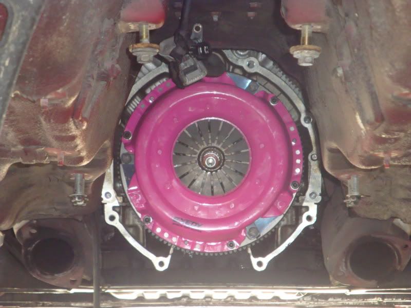

Exedy Sports Tuff Clutch Kit.

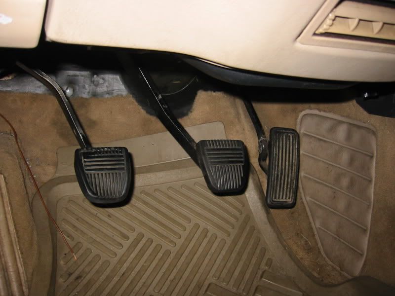

How to install a clutch pedal......the right way.
This kit is essential, makes it so much cleaner and its easy to use.
First pre-drill holes for your two mounting brackets and one for your clutch linkage and boot.
install the punch with cookie cut bit inside the car and flat bit on the outside and tighten till it pulls through and looks like this.

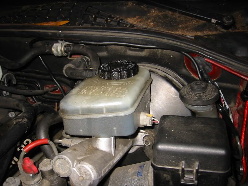

Install master cylinder
route linkage through pedal bracket and install nuts

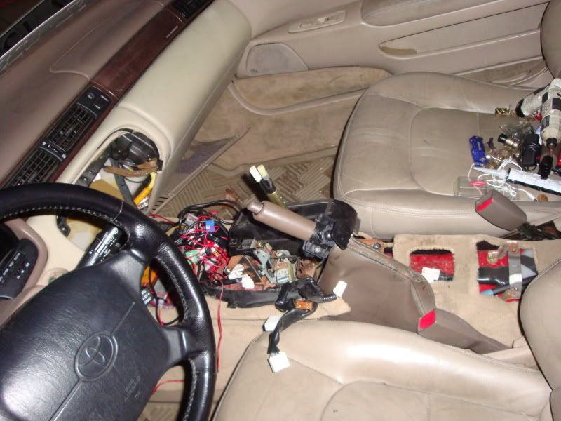

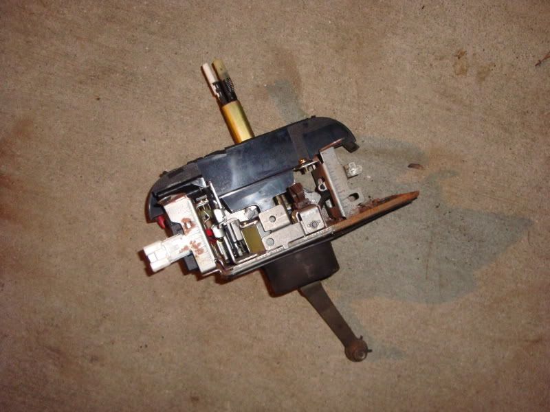

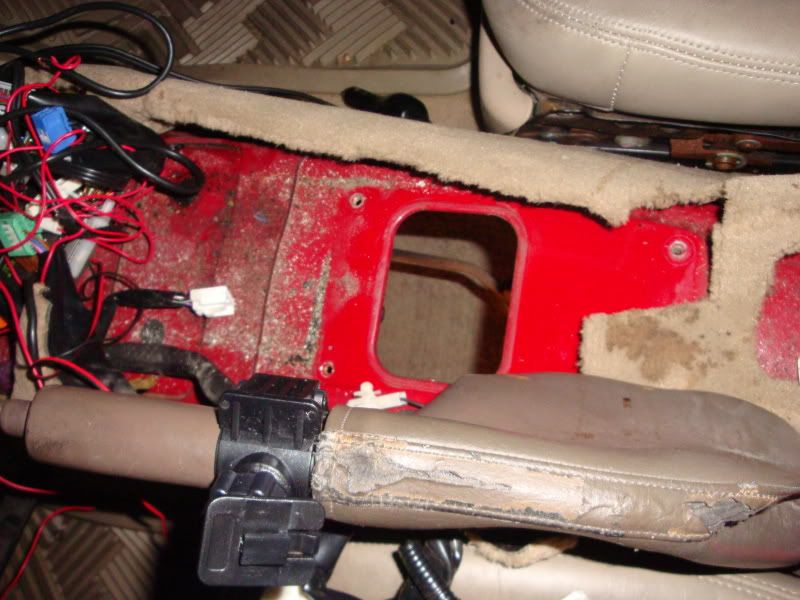

Remove center console and undo all connsectors to the shifter

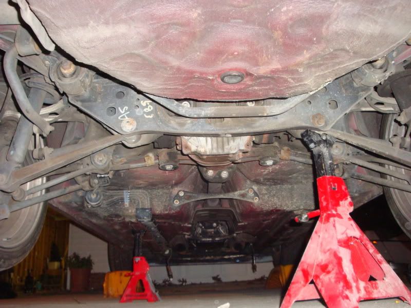

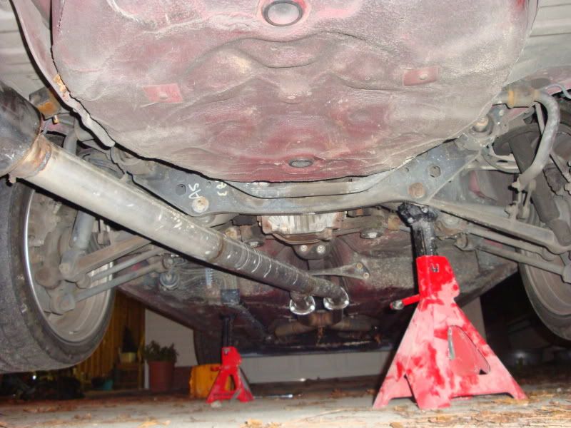

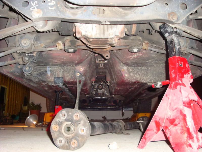

Lift the car via jack stands, lift or whatever you have.

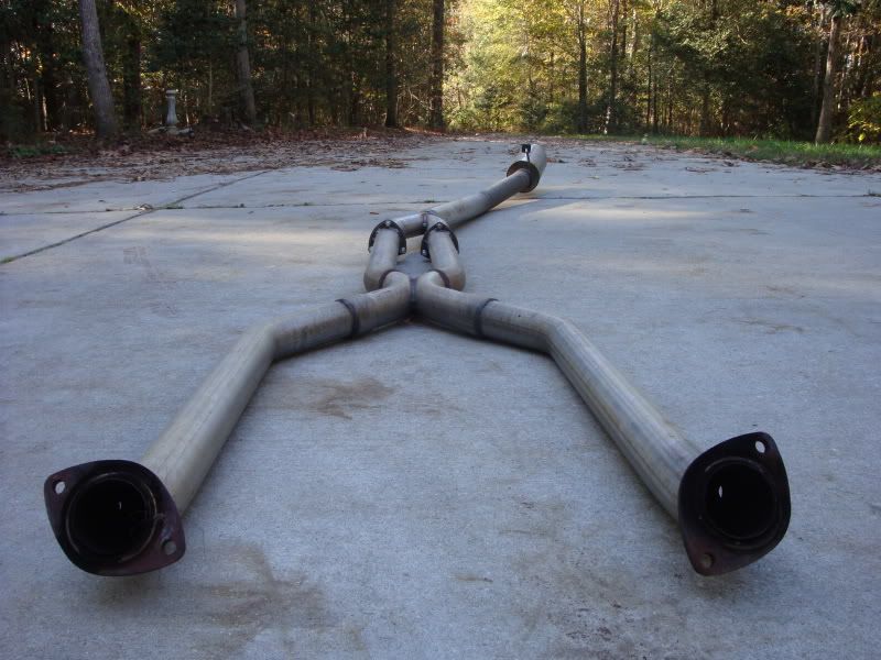

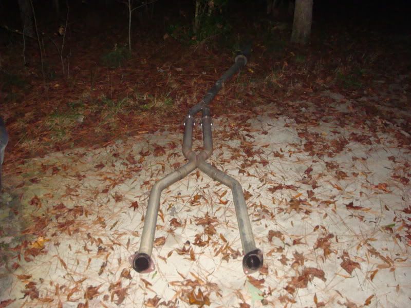

Remove exhaust.
Remove drive shaft

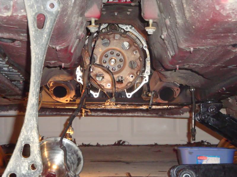

Now you can remove the bottom bolt for the shifter

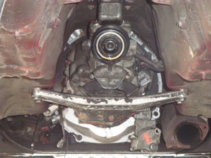

Disconnect electrical connections, hydro lines and lower the transmission

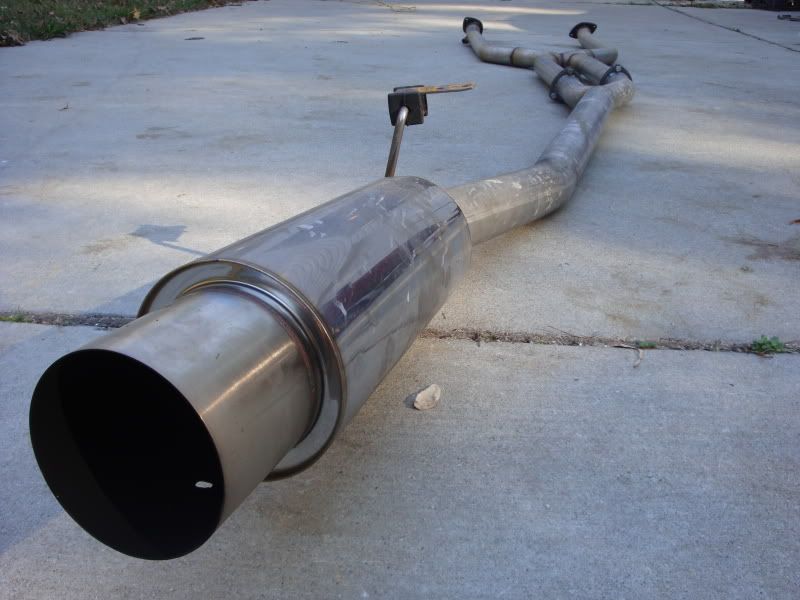

Thanks man, it is an Apex-i N1 Turbo cat-back that I had on my MKIII Supra a long time ago. Now it is basically and axle back, because from the axle up it is all custom mandrel bent exhaust....lol
