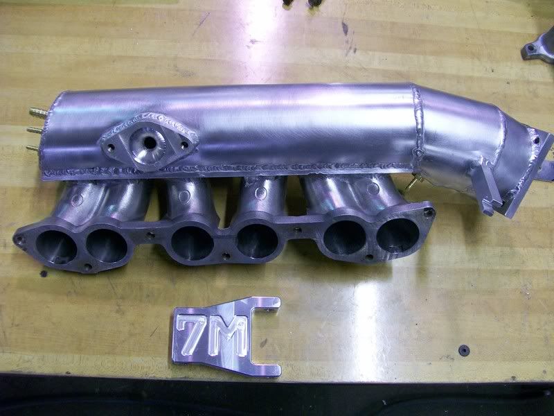

haha, I cant get started till next month cuz im in the middle of a move.. but Im going to try to source a thunderbird sc at the junkyard to pull the supercharger from some time this month. Ill also look for places to fit it on my 7M....
I also completely forgot, the ffim I have coming in the mail drops the alternator down to the a/c so I dont know how much clearance I will have on that side.
