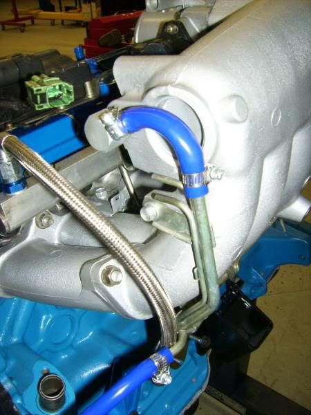

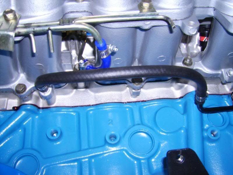

so i took somebodys advice and replaced those zipties with clamps :biglaugh:
i capped off the coolant ports on the TB

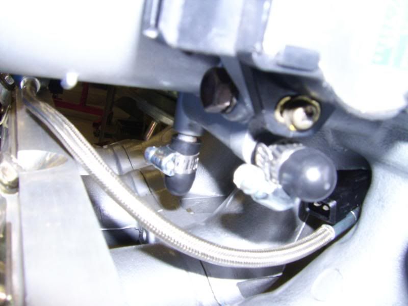

i capped this one off, but didn't feel that vacuum caps would hold under the pressure and heat, so i did this...
:naughty:

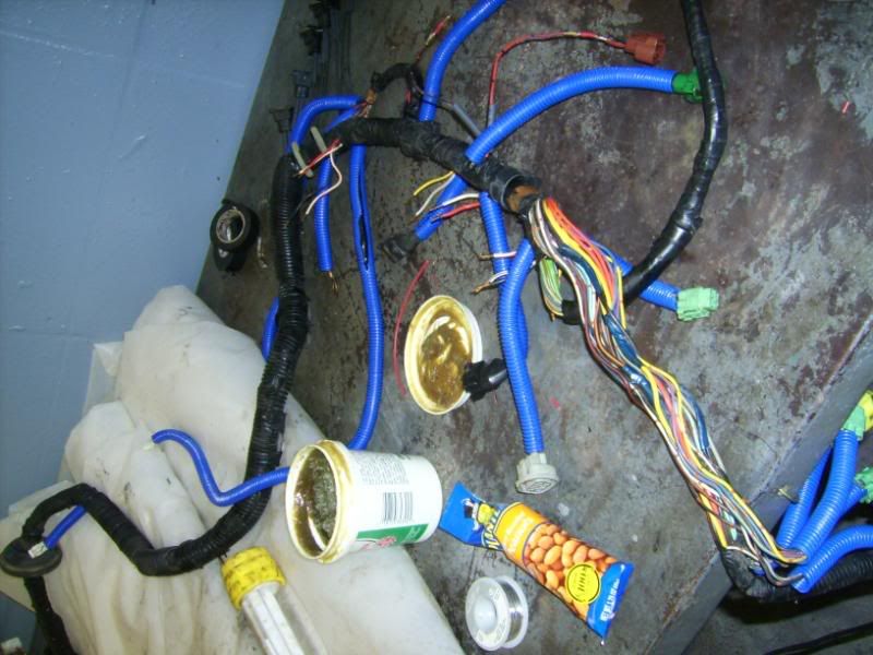

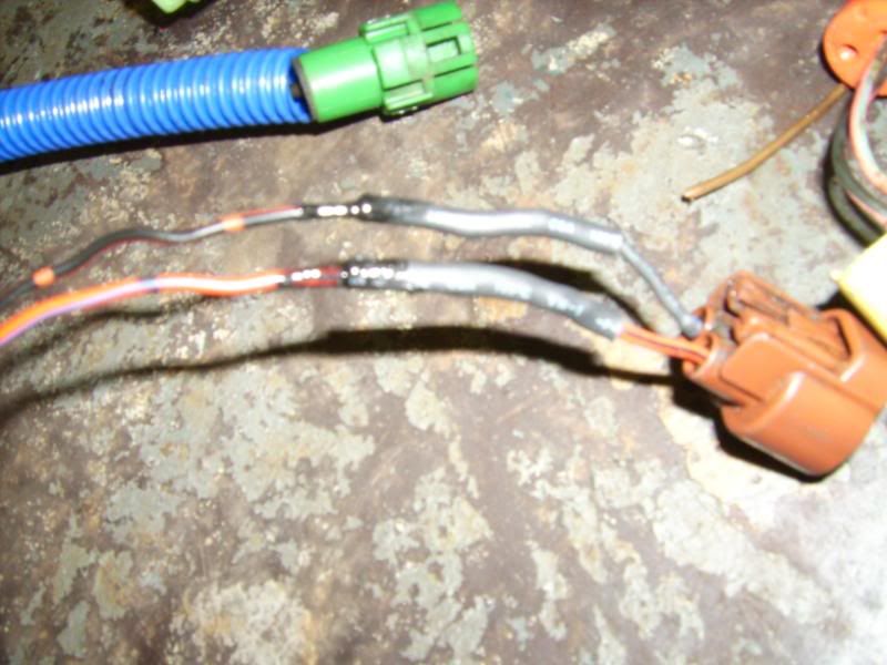

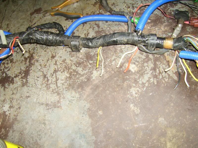

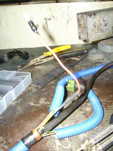

started attacking the harness again. trying to clean up all the wires and fix all the bad connections and whatnot before i tap it up :icon_bigg
haha a couple of examples of my electrical skills of wire repair.:naughty:
i love heat shrink and liquid electrical tape

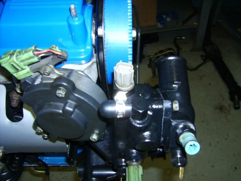

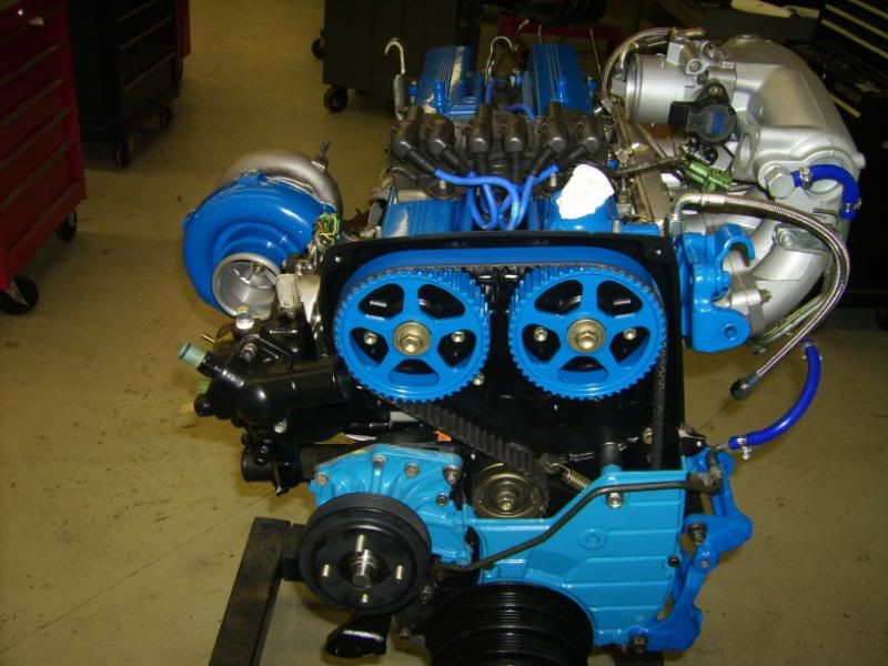

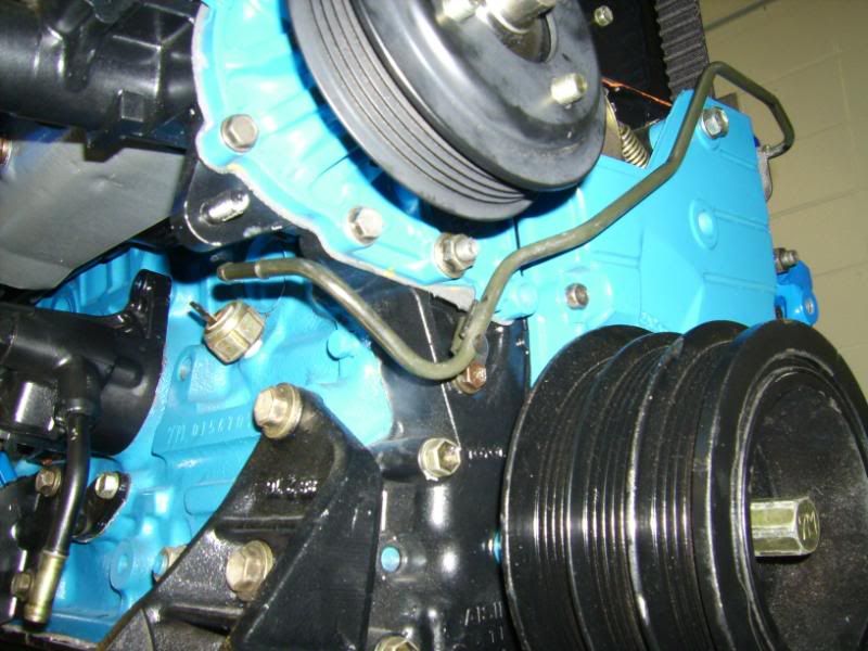

where does this connect to?:1zhelp:
OH ITS SOOO PRETTY! :love:
here's my sweetheart :biglaugh:

oohh looks nicer everytime i see it. BTW that hard line has a hose that goes on one of the nipples on the power steering pump. the one closer to the block if i remember correctly.
that might help.

You should get more input on this, but I didn't think the effects of the power steering valve were worth it. If you took that line off then it's 1 less section of vacuum line to worry about and it makes the engine bay that much cleaner and easier to work on.
Those coolant lines on the throttle body don't go anywhere anymore so you could take the clamps off of those.

1) Personally I wouldnt block off those two coolant lines that are supposed to go to the stock turbo. Lots of people report having heating issues just from blocking them off. Your best bet is to use the NA thermostat hardlines and banjo fittings and then just run a hose that connects the two ports. That way coolant still flows like it should but you dont have to hook them up to anything but each other.
2) You dont have to cap the ports on the TB. They can stay open. So unless you are doing it for cosmetics or something you can feel free to take them off.
3) Vacuum is vacuum. As long as whatever needs vacuum has vacuum from the manifold it doesnt matter what route it gets it from. Except for the VSVs under the intake manifold which I always just ditch anyways because you dont need them IMO. Especially the rear one that controls the EGR which you dont have anymore.
4) That hardline that connects to the PS. Its for your Progressive Power Steering. Meaning it keeps the idle up when you are turning the wheels at low RPM. Another thing that IMO is a creature comfort. If you like that type of thing then hook it up. If you dont care and are going for the "clean" look then just ditch the hardline and loop the valve on the PS pump.

1)i see what you're saying, i'll check my NA motor and see what i can steal off that
2)well, i'm gonna keep them capped mainly because it looks better =0)
3)so, could i just pretty much block off or loop the other nipples like the one thats on the back of the upper intake manifold?
4)so, a hose connects to that and i'm guessing the other hose connects to the nipple on the turbo accordian pipe nipple?
sorry guys, i forgot my camera today, but i finished cleaning up all the wires on the harness and started re-taping it. lets just say it matches my motor:naughty:

You should cut the nipples off the TB and IAC it cleans it up way more, that's what I did.

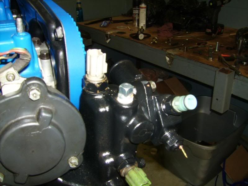

Valve stem seals go on AFTER installing the valves. The valve stem has a sharp edge that likes to cut the seals, this is why they include what looks like small pieces of straw that you put over the valve stem to protect the seal.
That is a JDM oil pressure sensor, and is NOT compatible with the USDM gauge.
yea i did hear something about that after i had the head together. hopefully it wont be anything serious.
if i just change the USDM connector so it'll fit on that, why would it be a problem?

The gauge and sender won't work together, and in worst case will fry the gauge...
