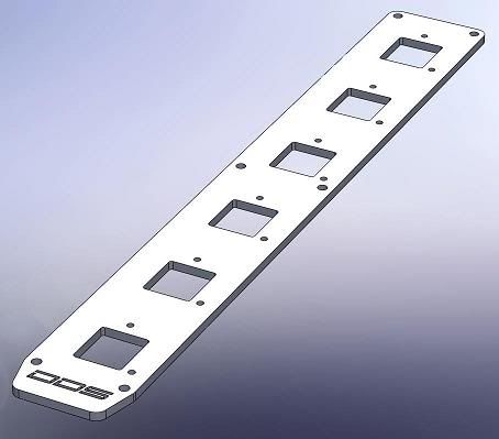

Also we got the coil pack bracket all made up in solid works, we will be sending that to the water cutting place tomorrow so they can do a test cut and we can match it up and make sure all the measurements are good (never had one wrong though) If it fits as planned we will be getting a batch cut. We also made up a flange to bolt on to the front of the lexus AFM where the intercooler piping will be attached. Not much left....

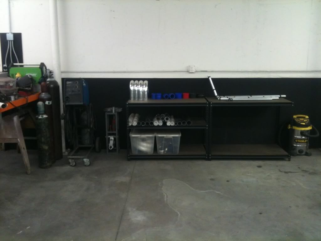

Got my downpipe flange and everything else. Should be working on the intercooler piping tomorrow and finishing it up to tune it this week for sure!
Sneak peek! :) Going to water jetting tomorrow!

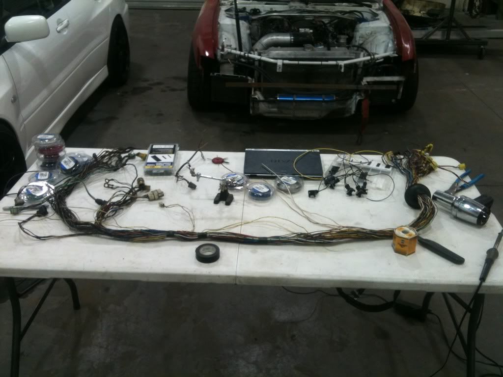

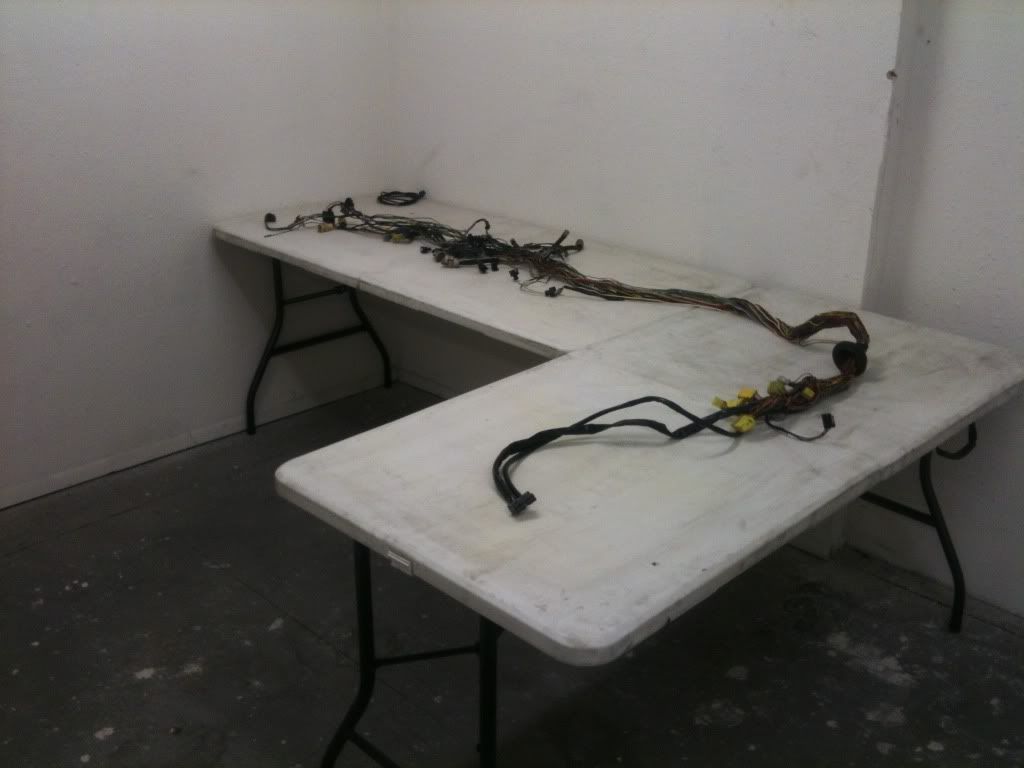

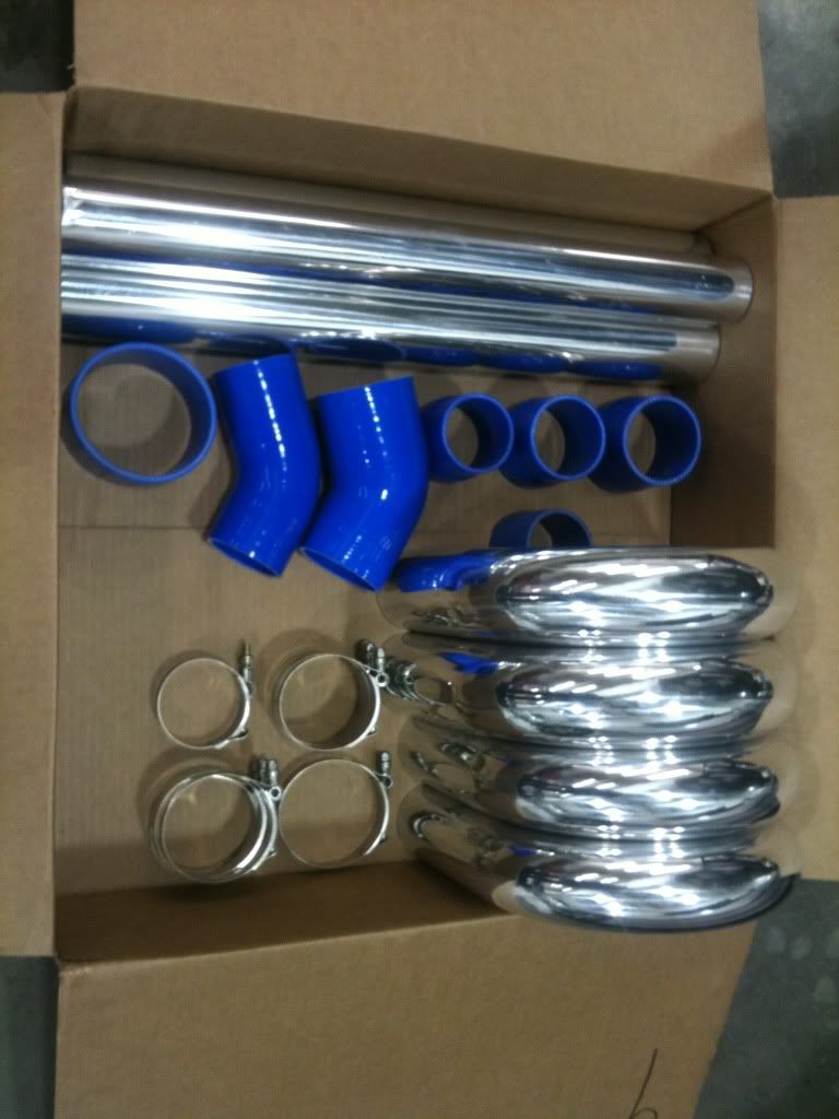

Got the piping, couplers and T bolts needed to do the intercooler piping. Should be doing the piping tomorrow, I also got the harness out and tore apart to do a few things to and re loom.

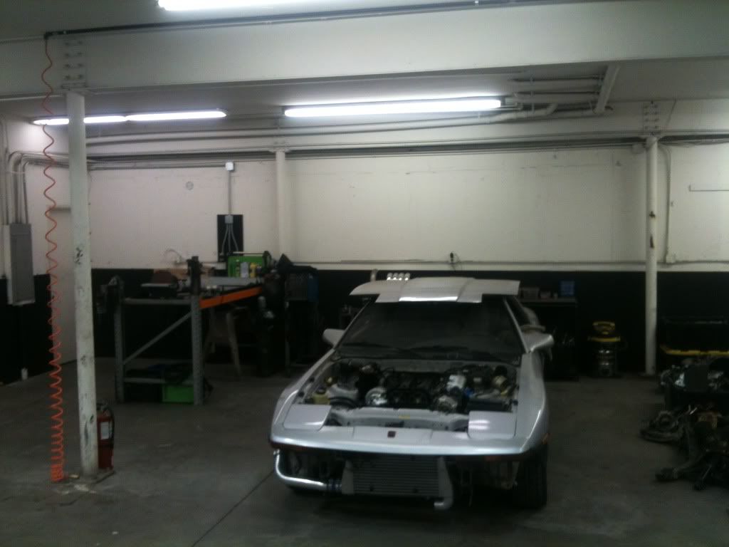

My brother got the cage done in a RX7 he was doing so we cleaned up and got my car over into the fabrication spot... Still haven't got to doing the piping but things are looking up for tomorrow. Got to do a clutch job on a Miata and assemble the rest of the Evo x we did valve springs, retainers and cams on tomorrow but then will be free after that.

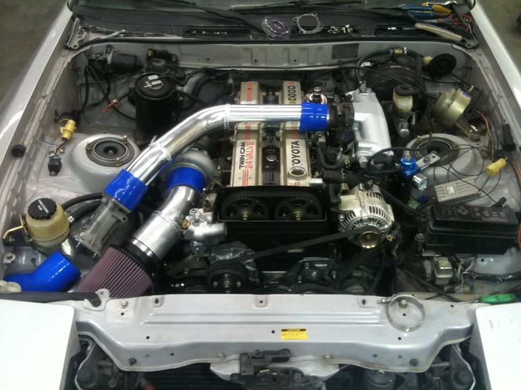

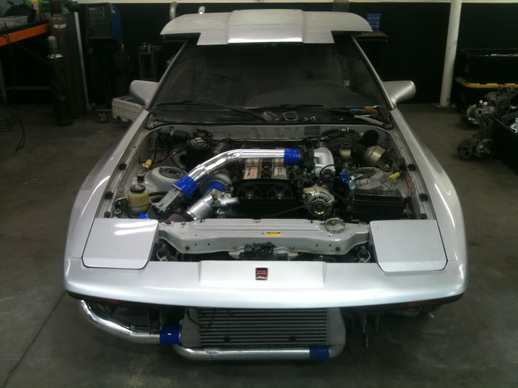

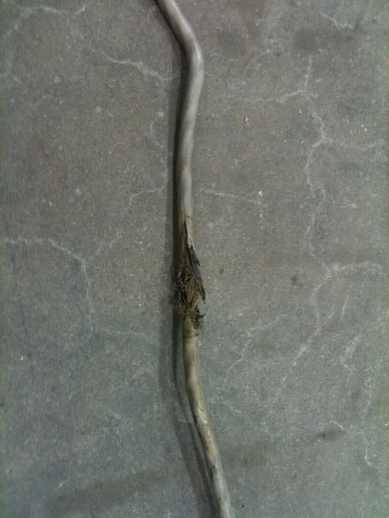

Update: Intercooler piping and intake is done. When I was working on my wiring harness I found a 1 inch section of the CPS wiring that was burned and taped over. Two wires were exposed to the shielding and shorting to ground. I think thats where the random stalling issue I was having was coming from. Anyways got to pick up some stranded 4 conductor PVC 18 awg shielded wire tomorrow to finish things up with that.
Just waiting on one coupler to show up and the AFM adaptor to be finished at water cutting.
Wiring:

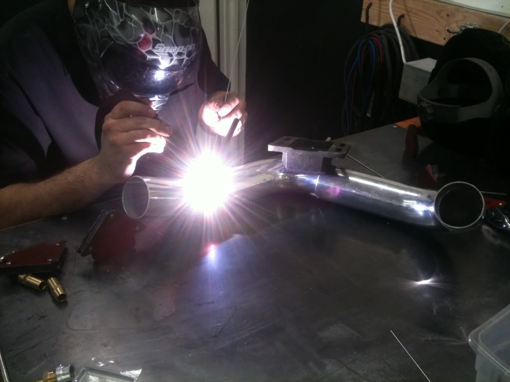

My brother Welding:
Piping mocked up and tacked:
