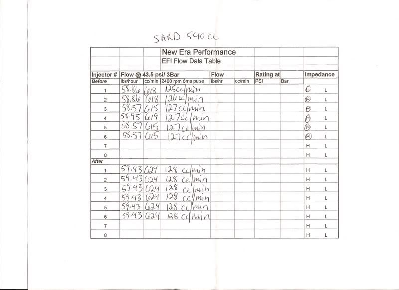

Here is a copy of my flowchart back from NewEraPerformance. It clearly shows that the injectors are flowing 624cc's instead of 540. I hope they swap them out for me without alot of hassle. I'll keep you posted.........lol

Wow did you have those injectors cleaned as well as tested. Why where the flow numbers all over the place in the b4? Were they new? And dont worry Jay. Like I said B4, you know I like blue If I have 3 of that color as well.:naughty:
4cc difference isn't really 'all over the place'...
56
Yeah, those numbers are actually pretty good. It lets me know that the injectors are good injectors, but I somehow got the wrong ones. I've seen people have their injectors flowtested and be off 200cc's before being cleaned and flow tested again.
