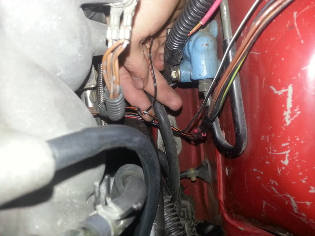

Today i was looking around at the wiring and alot of the wires coming from the igniter have connectors around them like they were cut and put together. i have a picture of two black and orange wires coming off the harness one of them is connected to the ignter plug, the other one is cut and dangling there.
Anyone have any idea of what i should do with this? it is the 4 wire plug and all of them are connected color to color but this black and orange strip one that is the same color as one already connected is just hanging out. im starting to think i might have to pull the harness out and go through it.

well me and a buddy were trying figure this out and we connected it to the blavk wire. he says that's where it went well when I started it the idle was liwer then usual (usually around 1100rpms) I can tell it was about 800-900rpms. but the problem was the rpm gauge stopped working? so we disconnected it and the gauge worked again. I have no idea what this wire is for becuase there is two black with orange stripe wires wrapped together but one you can tell in the picture is not connected to anything.
