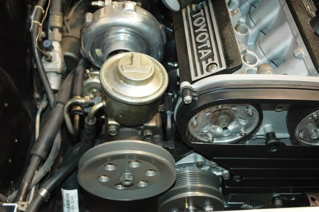

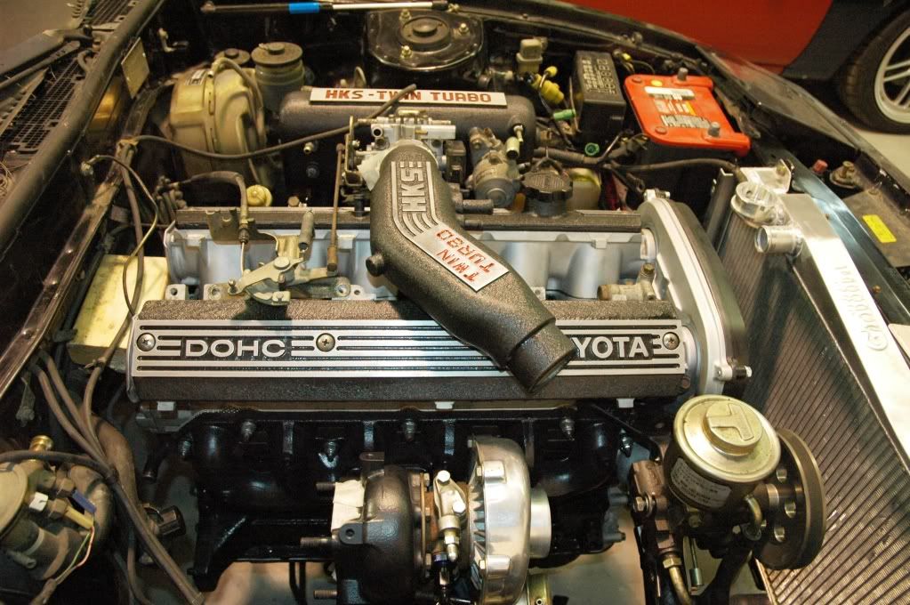

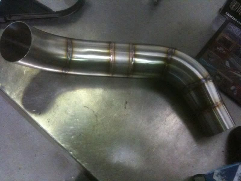

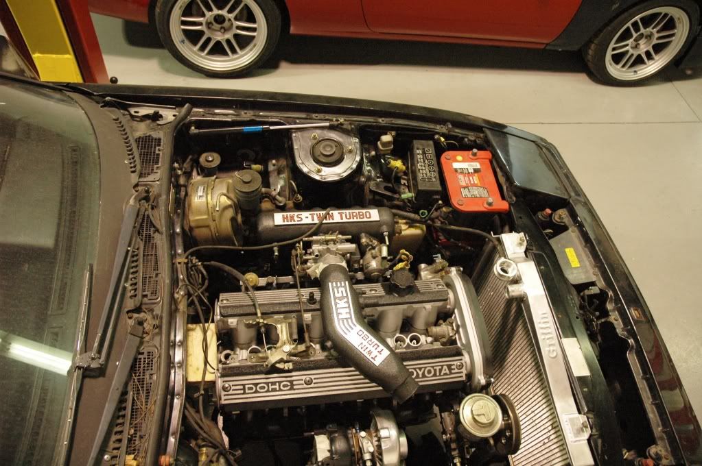

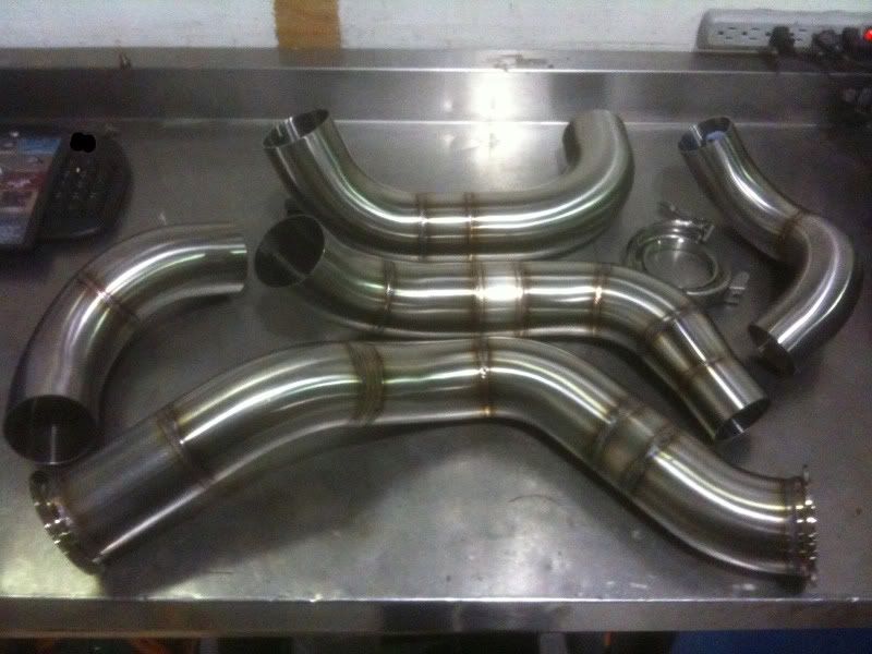

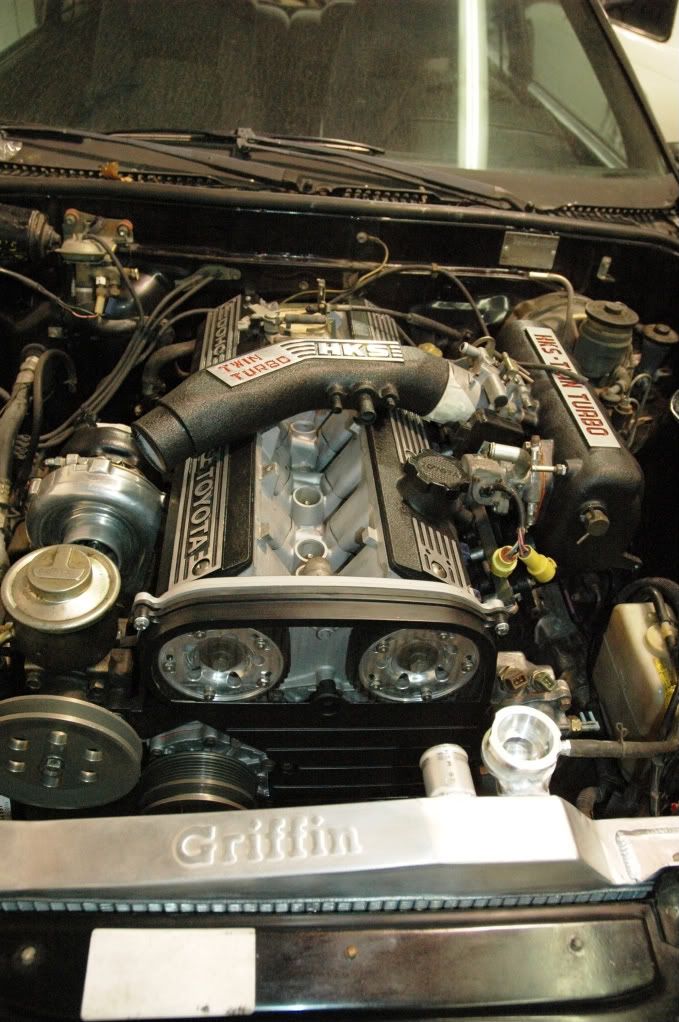

I did pass by the shop today as they started to build the I/C piping, he wanted to route it different than I visioned it so had to pop by to see what he meant as I'm not sure I've seen it done this way. It'll be different for sure...still not 100% sure how it will look but right now don't' care, I'm pretty much giving him cart blanche with this build. I was going to originally use a generic ebay aluminum i/c piping but after I saw his stainless welds I quickly changed my mind:
Snapped a few quick shots, the more I look at these pictures the more I realize the small things on this car are going to piss me off when it's all done: p/s reservoir, brake booster, wiper motor etc etc...no matter how good everything else looks some of these parts just look like total ass...anyway here's a few pix:
