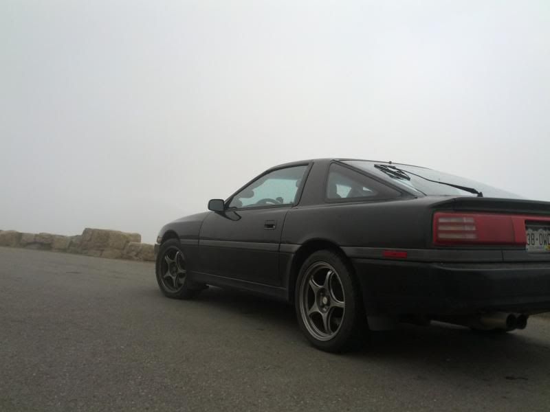

Drove through Rocky Mountain National Park a couple weeks back. Probably the best shot I have of the Supra in a while. Dirty wheels and all. 333k on chassis, coming up on 25k on the Turbo motor since the last partial rebuild. composite head gasket is handling the 54 trim @ 12 psi quite well so far.
