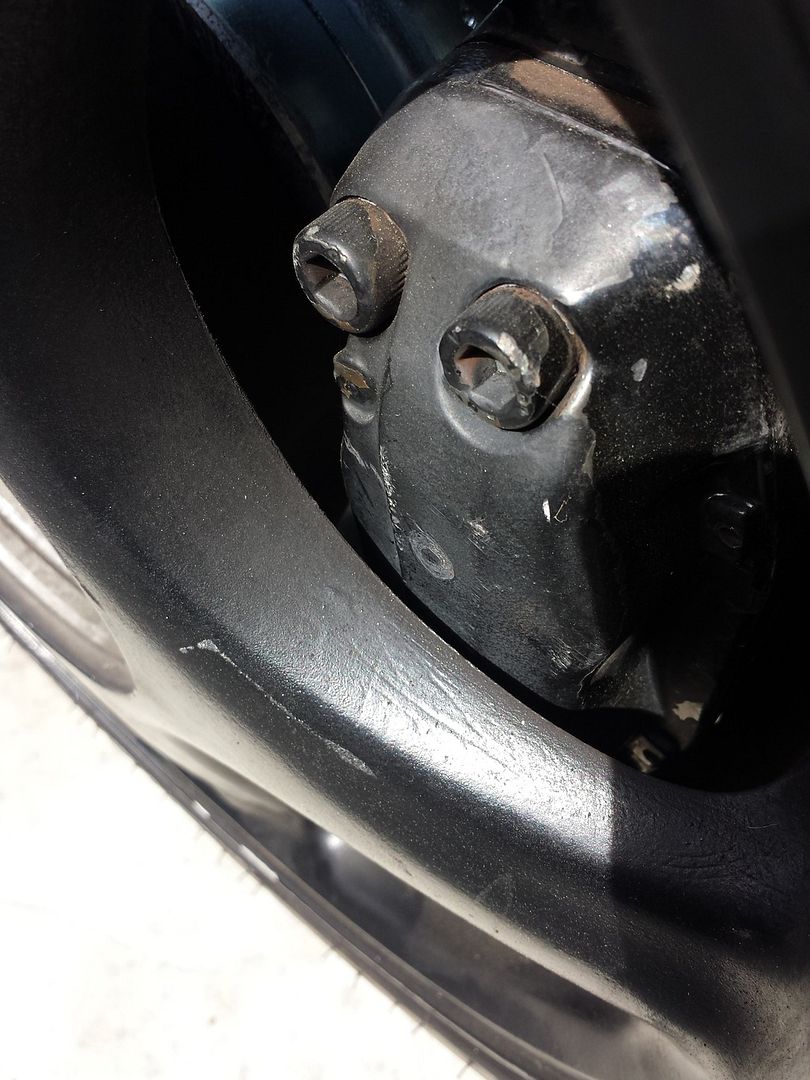

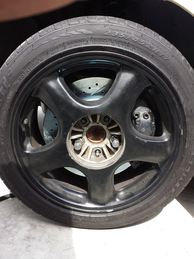

ask92
That guy.
Nov 17, 2008
357
Rocklin, CA
Yes they do fit:
(not my pictures)
From what I have found they are almost identical to MKIV TT brakes from a physical standpoint(piston size, rotor size, etc) which should be more than enough stopping power.
