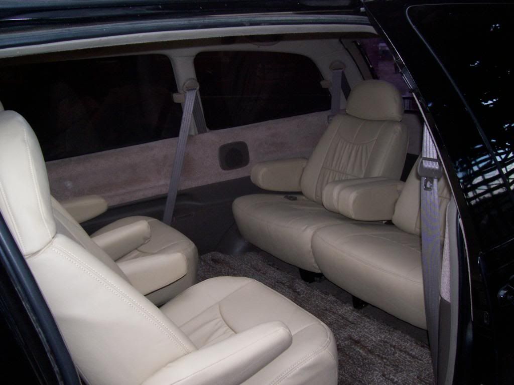

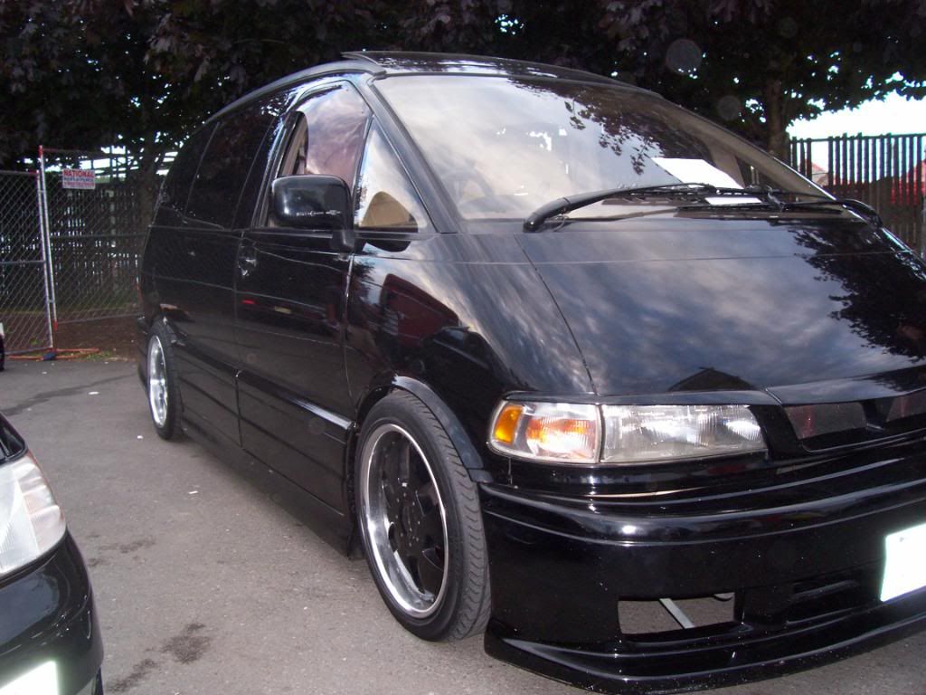

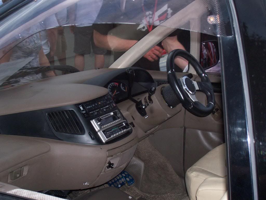

also, I own a Previa and have always wanted to say that one in your avatar is clean! for a while right after buying the supra, I considering converting the one we have to manual coupled with some Estima parts.. never got around to it though, haha.

Cool, it is an Estima.
It had blood all over the rear hatch area, the hot/cold box worked and it was supercharged. You would think being in Japan there would be hella options on twin upgrades. If you find options let me know. One of the reasons I went 1j is because I have to chase my buddies GTR up mountain roads and the 7m was way way way to laggy. I love the 1j's rev capacity. I love mountain drifting and gripping.
