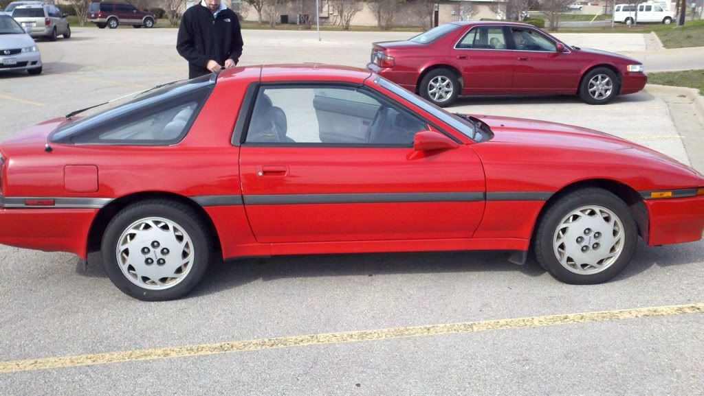

My buddy is looking for a supra. We found a nice 90 N/A that's real clean. Guy says he just spent $2600 to have HG replaced and a few other things. Admits he thinks the shop may have screwed him over.
Tells me the car has started to overheat and boil over. Also said one of the coolant hoses was sucked flat (???). He thought it was the thermostat. He removed the thermostat and it still overheated. He then lowered the price.
Well today he advised that a friend who is or was a "toyota mechanic" told him the problem is with the heater core and that is causing it to overheat. He admits there's coolant on the floor but the engine has plenty of coolant in it. So he goes back up on the price.
I have NEVER heard of this and neither has my mechanic, who works soley on Supras. Just looking for some opinions.

The intention was to buy it and do a stock rebuild on the engine. My bud doesn't want crazy power and a GE will suit him just fine. I know the amount of work that's going to be involved and it will be extensive. I've pulled a few engines in my time.
I just want someone to explain to me how a heater core would cause an engine to overheat, especially if there is plenty of coolant in the system to circulate. I say there is no explanation.
The car is question.
