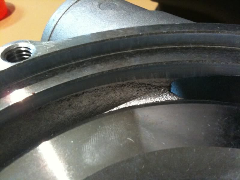

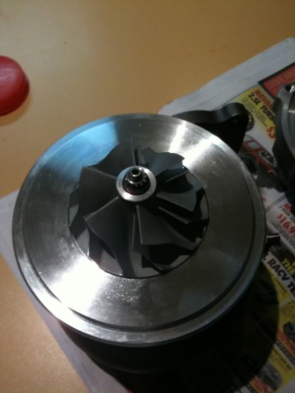

See the pictures of inside the turbo, shouldn't be very hard to seal, What do you think Ian?
I seal mine with some Copper RTV Gordon.

This is all leaning me towards a 57 trim, to be honest.
Clock the catridge, custom feed/ drain lines, re-weld the wastegate, tack weld or collar the wastegate flapper,

clocking the cartridge take 5 mins. they sell a custom line kit. you just have to reim out the holes a little bigger for the drain. the wastegate movement i dont think is neccisary, i didnt have any problems whatsoever. and the flapper weld also takes just a few minutes. so in retrospect it just sounds like alot of work. But i also agree that if your not looking for more than 400, maybe a 57-26 is your best option. I'm getting use to how to drive with the lag, it gets easier:) good luck with either route

I'm not sure why more people aren't having the spacing issue with the actuator hitting the outlet piping of the turbine housing. The actuator housing would touch the silicone connector and it was not possible to get a clean fit which meant boost leaks to me if this was not fixed. With everything apart it was no more than a centimeter between the actuator and the cast outlet section.
I'm interested to see if there is any benefit of sealing the compressor side of the housing as you are describing above, Paradox. I'm hoping this will all work out with drivability and all, I want it to be streetable without too much lag so I hope I made the right choice here. If not it would not be the first lesson learned with my supra project, but I'll hold out to see how it performs for myself right now.

Cbatstone, Never had that issue with mine. it is a tight fit, Maybe try using a thinner silicon coupler.
