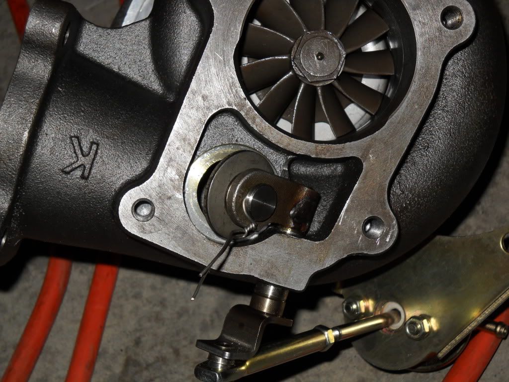

Another cheap way to solve the "sticky" wastegate. When I bought mine, the wastegate would occasionally get stuck when it would actuate. Fixed that issue!
Aircraft maintenance... Who knew it would work so well on vehicles also?! ;)

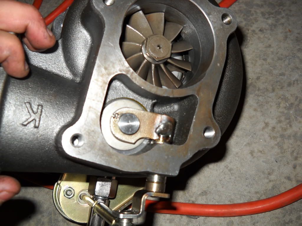

What exactly did you do out of curiosity? Can't really tell from the pictures, Looks like you cut off the side of the flapper support, Mine kept getting jammed on the disc that covers the waste gate hole not on the actual arm, Did you have any movement in the assembly like mine?
Sorry misread your earlier post, i get it now :)

Those are pretty awesome additions! In the pictures I showed how to solve the flapper door problem with safety wire. Simply take .40 gauge safety wire and tightly twist it in between the flapper and its counter-part. Simplistic and sturdy, and the flapper door will never get stuck again! I just fired up the car this morning with the new electronic boost controller and it sounded kinda rough. Though my wideband showed my air-fuel ratio as being just fine, the car was only pushing about 8.5 psi on the settings I had. Still got a few kinks, I guess! ;)
Very nice car by the way, hopefully our setups can withstand the test of time... HAHAHA!!
63
Would have done nothing to correct the OP's Flapper issue....
