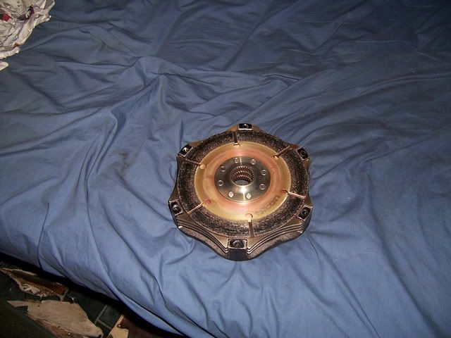

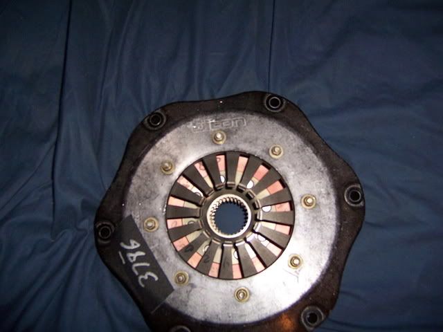

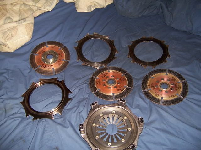

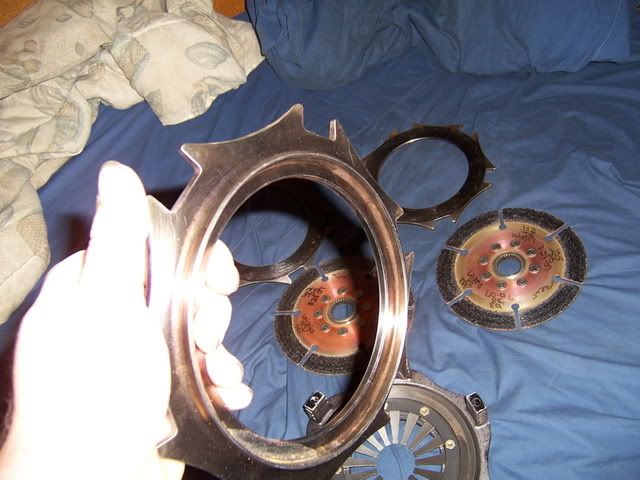

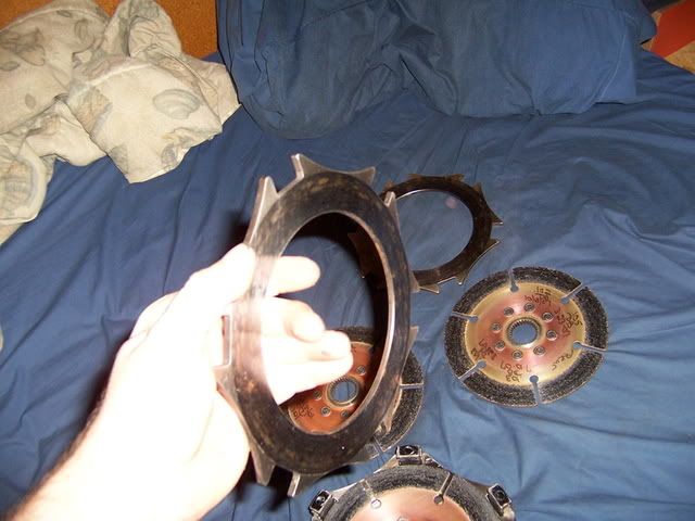

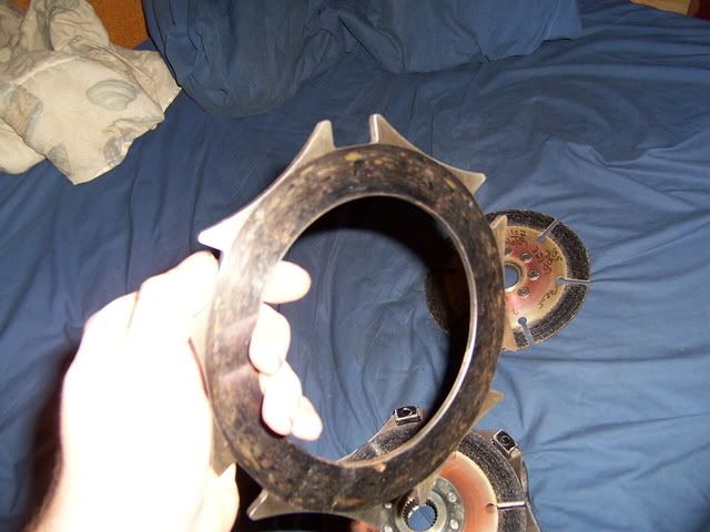

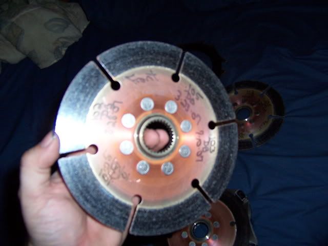

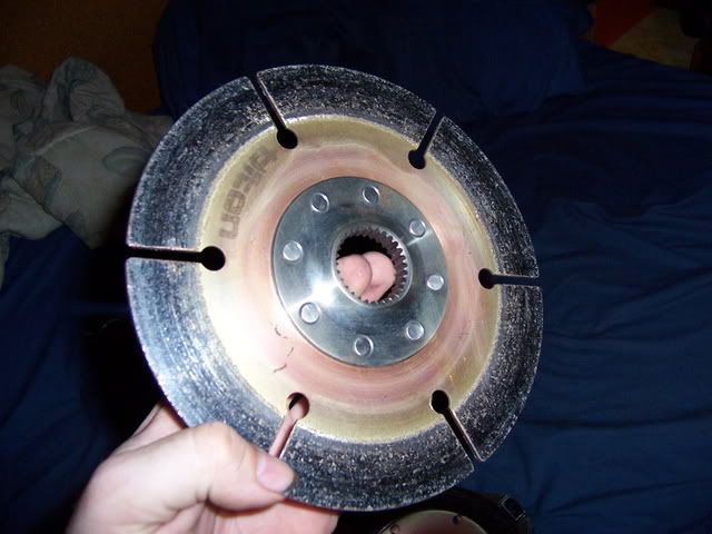

anyway, more progress. my adaptor plate according to the tracking number will be here early next week, then i can test fit the t56 to an extra 7m and take pics and post the group buy. also, last night i bought a used tilton 7.25in diameter tripple plate clutch. it has full metalic discs in the spline i need for my t56. i did alot of searching and the porsche guys run this clutch in the 996 gt2. they say it can be slipped but chatters, so alot go with the organic discs as that way it doesnt chatter and is more street friendly(easier to slip). one guy was pushing over 700rwhp on the organic discs and no slipage at full boost etc... so ill be buying the organic disc pack for it before i use it which is about $170 for the discs. next hurdle is due to the clutch, its a push type so im gonna have to fab a way to mount a internal slave cylinder like the ls1 t56 uses. ill prolly go with a tilton as well designed for the clutch i have. they arnt too much used, and usualy are rebuilt already before sold. just got to take the clutch when it comes in to the local clutch shop with a flywheel to have the flywheel drilled and tapped for it. im gonna use the w58 flywheel as it is lighter then the r154. also, this clutch weighs like 10 lbs complete so saves alot of weight, no need for a lightweight flywheel etc... and should hold more then the t56 can, and if it wont with the organic discs, ill switch to the metalic ones that are coming with it(its rated to 1050ft/lbs of tq with those discs). ill post pics when it comes in. heres the pics from the auction.

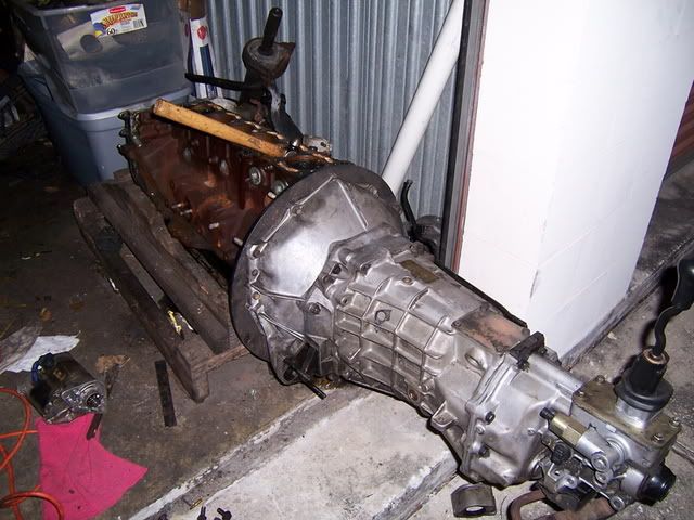

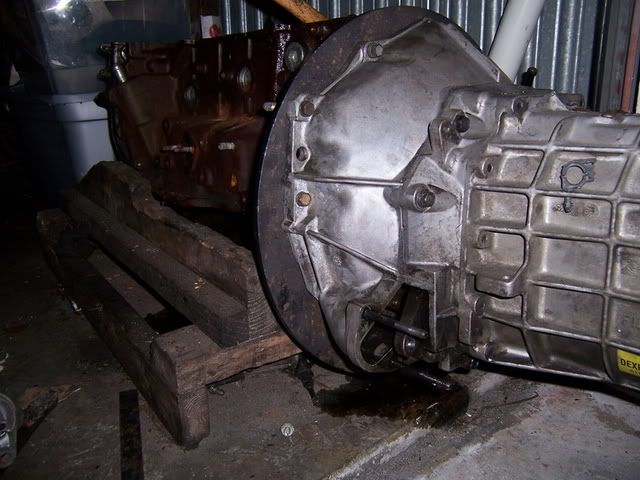

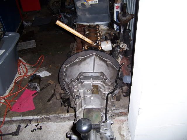

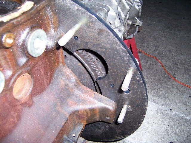

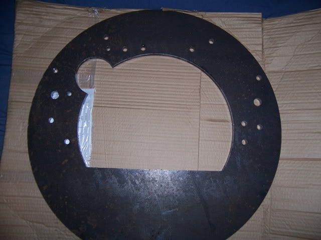

well, got the adaptor today, i am pissed. it isnt right. 3 of the bolt holes that bolt to the block are just a hair off. i can easily drill them just a little and they will work. the 4th is off by more then just a simple change in hole size. good news is the dowl holes were perfect and i mean perfect. fit the dowels so tight had to smack it with a hammer to go on and off them. so it held in place perfect. i got one bolt in to keep it on the engine. then fitted the t56. those holes are correct as well. the input is perfect. i put the required pilot bearing in the crank before fitting it to the engine to be sure. then put it in gear and spun the shaft both ways to ensure it spun freely. looked in the clutch arm hole and it was all the way in the pilot bearing perfectly. i grabed a front dust sheild from a 7m and brought it home to measure. i found my mistakes and am fixing them and getting a thin piece cut out so i can test the alterations to be sure it is perfect before i do a group buy. i will likely just redrill the bad hole on this one and use it myself as the thing fits so tight on the dowels i cant see a problem. or if someone wants it i will sell it cheaper. who knows. anyway, heres the pics. i could prolly go to 1/4in plate as it should be more then sufficient, but i think the 3/8ths gives better spacing for the input shaft in the pilot bearing. the input shaft on the t56 sticks out slightly past the bh face where as a r154 and w58 it is slightly recessed.
williamb82
Apr 24, 2005
906
4
Tampa, Fl.
yeah, i already made the tweaks to the file and emailed it to the place. asked for a 1/16th in thick test piece. and as for the outer portion, i will trim that off with a jigsaw before i use it. did that on purpose as the autos arnt the exact same outer profile. mine isnt anyway, close but not the same, but the bolt holes are the same. so when i sell them, whoever orders it will have to trim the outer rim themselves.
