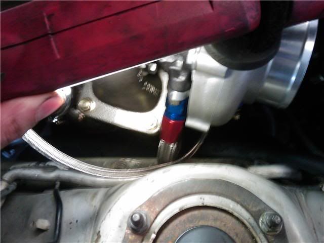

Now back to my problem. After adjustments the -10 SS drain line will fit but looks like it will be at a slight upward angle once cut down & AN straight is on & mounted to block flange. I know to get that drain line straight as possible but from these pics what do you pros think, suggestions?
Block Side flange
Turbo Side Flange
-10 Line (Untrimmed) Part going up between block & manni is excess

dude, get a speed flow 90deg fitting or similar and run it up?
if you decide to drain into the sump make sure that it is ABOVE the oil level. I'm not sure the return line for the oil cooler actually is much above the resting oil level. remove the fitting with a full sump and find out :) when the motors running the resting oil level with be lower than sitting oil level.
Does the standard fitting flow enough? from memory its only a 8.8mm hose which isn't much thicker than a typical feed line which could cause oil back pressure.
turbo seals are not designed to deal a full turbo of oil, so any back pressure will be bad this is why the return line is 2x the size of the feed, master powers run a journal bearing which will leak.

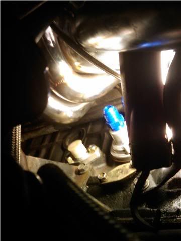

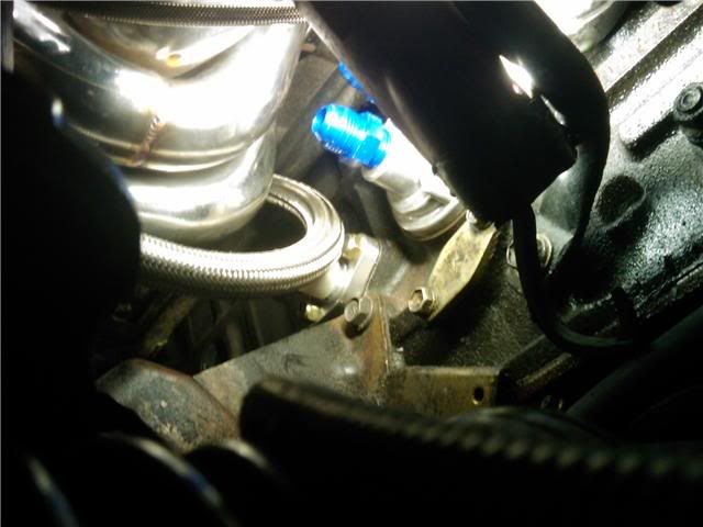

sorry to jump into this tread with my own issues but this is my problem...
here are a few pics:
as you can see i have some clearance issues to go to the stock oil return. if i put the hose on its does a little up before the block. as far as i know gravity wont push up. so i was thinking of a 90 going toward the back of the engine then going up but i dont know if its good to go across a bit. im really lost right now and not sure where to go. i have thought of just going with a different manifold. but i dont want to unless i really need to .

suprafanatic;1432273 said:
that looks like it flows down then back up alittle before the block..
it does thats what i was asking if its ok for it to have that slight step up?
the only other way i was thinking of was to tee into where the return line is on the oil filter housing since i am running a relocation filter. or is that no good either?

It's a gravity drain.....
UP = bad..
likewise if the drain hole is in line with a Conrod that can cause issues as well.
The Rear "seal" in most Turbo's is a simple labyrinth that if you impede the drain in any way shape or form will flood into the Turbine housing and smoke like a bitch.
