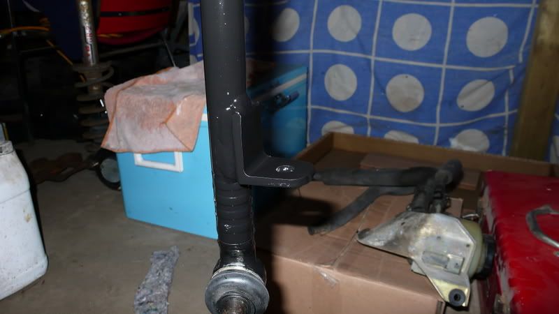

I don't think it will do all that much changing the length of both at the same time, but preloading the bar (one shorter link/one longer link) will have an affect...not sure if it would be a positive one though...

Yep, I forgot to add:
They're simple to make, should you be inclined to do so. Adam's pic shows that very well. (Thanks, Adam!)
If you're not into the "cut up some steel and make it work" approach, there are various hot-rod catalogs that have weld-on pieces that would work just as well, albeit, a bit more pricey. :)
You can also replace that bar with a better part for better suspension adjustment.
Adjustable length endlinks are NOT for pre-loading the bar, that would be a bad thing, m'kay? They are to adjust the bar's height to stay parallel with the ground when ride height is adjusted.

thanks,that makes sense.Gonna go to tractor supply tomorrow and get the rod ends to make my own set(
