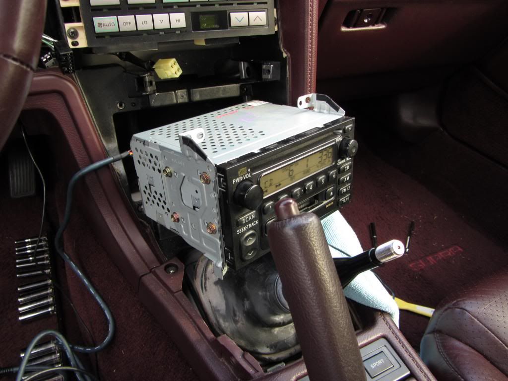

Hey guys,

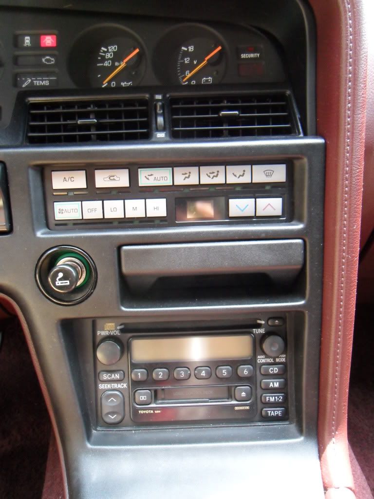

I have an '89 turbo, and the deck in it is stock, but has some issues(noise, broken backlighting), and i'd like to replace it with another oem deck.
This is my cuurent deck:
Heres two other oem decks; one is from a later supra, the other from a Rav4:
Is there any chance tht these might be plug&play? I am certainly willing to depin, swap plugs and repin if necessary, but i dont want to cut oem wiring. If anyone has any experience with this, i'd love to hear about it.
Thanks.

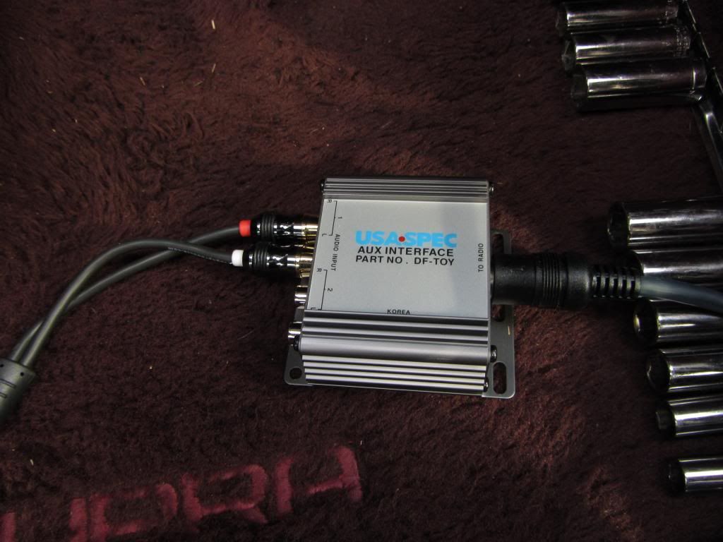

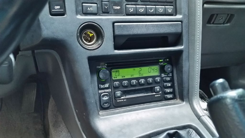

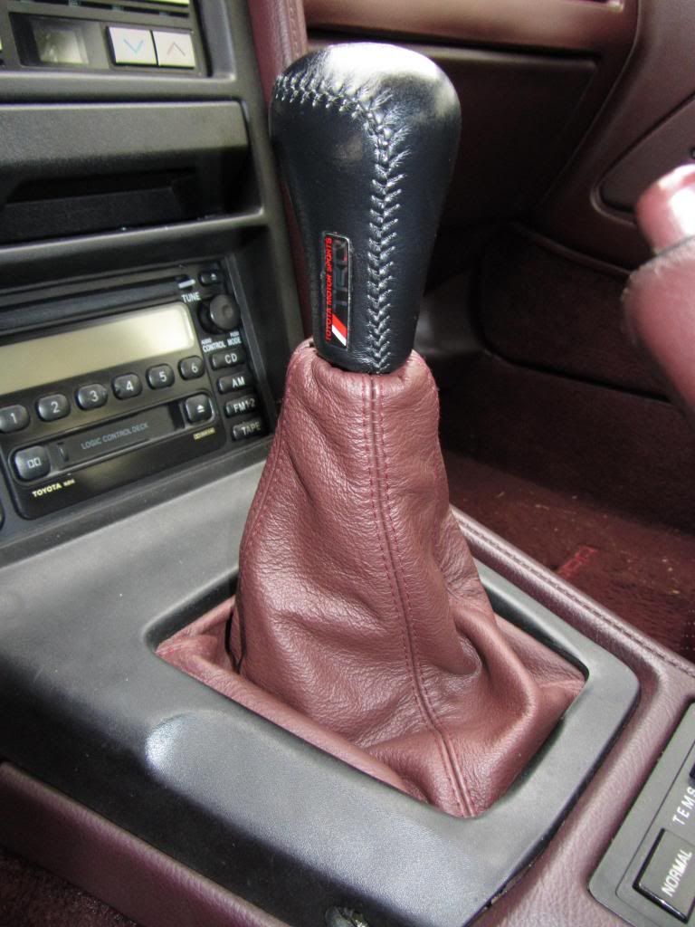

All Toyotas 87 and up have ran the same harness so the wiring will be plug and play. Only the special JBL ones and maybe the new touch screen ones have different plugs. The sizing I'm not sure about. I know the 4th gen 4Runners have stereos that appear to be double DIN but they are slightly different. You need a double DIN to fit the Supra. I ran a stereo out of an early Sequoia for a few years in mine until I upgraded to a Bluetooth touchscreen unit. Give me a minute and I can find you a part number possibly. I've got pics of it in my Supra in my build I think. It's a super clean install honestly, it even lights up green to match the stock lighting. You can get an adapter that plugs into the back where there is a 6 disc changer plug that will give you an AUX input as well.

Now that my internet appears to be stable and my computer wants to cooperate it should be a Toyota 16814 headunit that I have in those pics.

That will only plug into a factory Toyota headunit, not an aftermarket one. The Toyota headunits have plugs on the back for adding a factory 6 disc changer that would go in the trunk.

The AUX adapter thing I posted has a much cleaner sound than a cassette adapter, and I think it looks cleaner than having the cassette adapter in there all the time.

The 16815 is externally amplified but looks identical. The units with external amplifiers are not universally compatible. There are a number of different connector designs over the years, but you can adapt them as the actual electrical signals don't change, just the number of pins and pin functions.

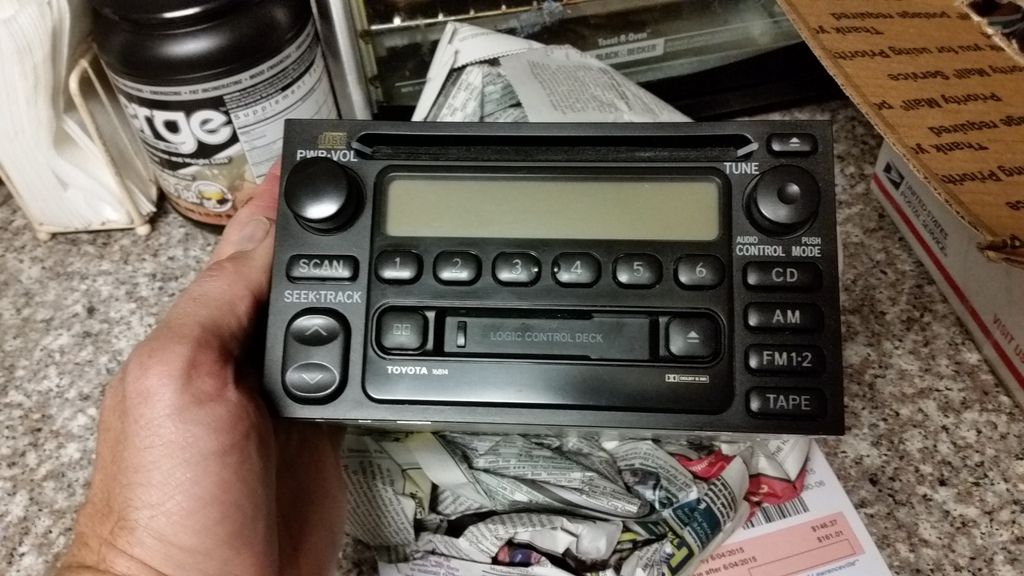

Got it in today.
I think it looks pretty good, and the feedback/ buzz/ hiss is gone now.
Question to Silver Mk3: There is a third plug socket on the back of the unit, is this what you plugged your aux adapted into?
