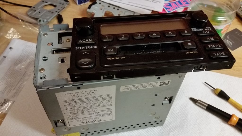

So, when I got this deck, I didn't realize that there was an issue with the power/ volume knob till I installed it. It was collapsed, and wouldn't spring out, so it would constantly power on/ power off.
I bought a replacement knob, thinking that the issue was with the knob itself, and tore into it yesterday.

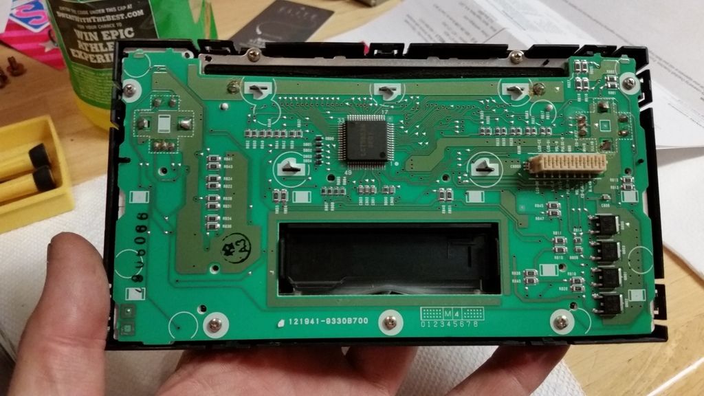

I opened it up. Surprisingly, the front faceplate just pops off, almost like a removable faceplate:

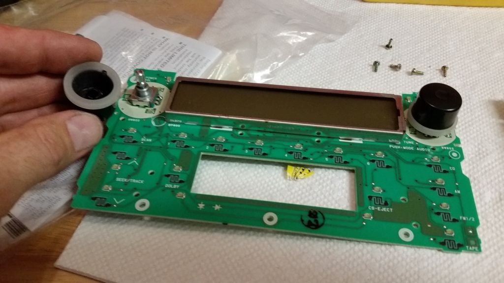

In the right upper corner, you can see the cross-shaped solder group. That's the power/ volume knob that I needed to desolder. Once I unscrewed this panel, I realized that the knob itself wasn't bad, but rather the rotary switch itself.
Here, you can see the knob/ switch, now on the left:
Unfortunately, my old head unit from the car has a different type of switch altogether, so I couldn't use it as a donor.

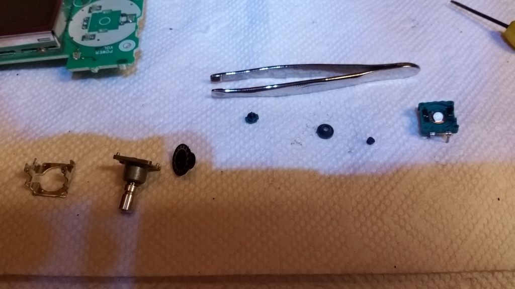

Instead, I decided to take apart the switch itself, hoping to find the spring mechanism...
Um...yeah. Didn't see any repairable items inside, so I reassembled it all. Instead, in a MacGyver-moment of inspiration, I fashioned a spring from a
ballpoint pen, and wrapped it around the rotary shaft, and reinstalled the knob(sorry, forgot to take a pic). Now the knob springs back as it should.
