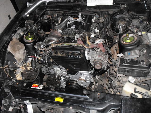

She's finally in her spot. It was very difficult getting the engine mount bolts to line up and the R154's big fat butt in place. Perseverance once again paid off!
Yours truly. Trying to get the upper intake back into place and that is where I stopped for the night. Pic was taken by my 4 year old! :D

CajunKenny;1591111 said:
Woo Hoo! Way to go Ron! You didn't scratch anything did you...? :sarcasm:;)
Your 4 year old is a natural! :)
Thanks Ken. I did nick the left side fender when I was swinging the engine around, but nothing major.
I guess it has something to do with us always carrying a camera around! :)

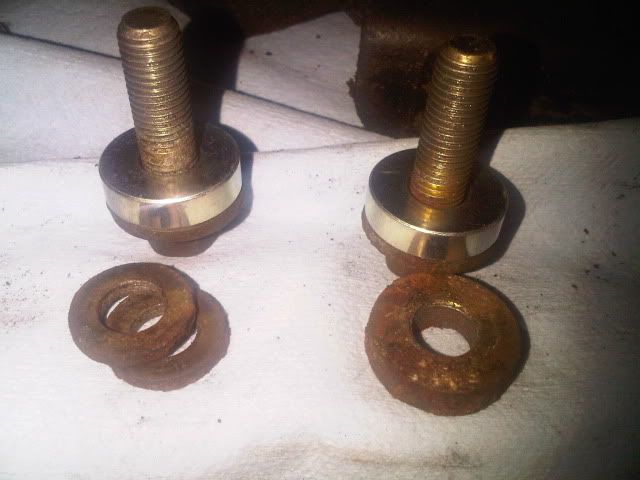

Haven't been able to devote too much time since I got the engine in. However, I did get the trans bolted into the chassis and connected up the drive shaft. Also bolted up half the exhaust. Couldn't connect it all as I need a bung welded in for the a/f gauge.
Hopefully I found the cause of the clunking noise I'm hearing when I turn.
These are the bolts for the carrier bearing. Notice one had 2 smaller washers stacked to take the place of the correct sized one. Got these new from the dealer. I'm hoping that's what the clunking is, but I'm not holding my breath! :D

Where was the clunk coming from?
Obviously someone had been in there before. When you removed the carrier bearing bolts, do you remember if the washers were between the bolt head and the carrier bearing housing or between the housing and the body? How did you reinstall it?
Did you inspect the alignment of the U-Joints? Good thing to do...
I doubt the washer deal was the cause of the clunk; but, what could've caused it was the combination of possibilities. If the washers were installed incorrectly, mis-aligned u-joints, bad carrier bearing... And if all three...what a mess! :)
The clunk seems like it was coming from the rear diff possibly, as if something is hitting the underside of the car. This is why I came to conclusion of the washers being the culprit. :dunno:
When I removed them, the washers were between the bolt head and carrier bearing. I assumed this is correct based on the TSRM and that's how I reinstalled it. It's not that clear, but it does look like that in this pic. Should I have installed them differently? Are they supposed to act as a spacer rather than a washer?
I did not inspect the U-joint alignment. I still have to get under there, so I'll be sure to do it. The carrier bearing seems to turn freely so I'm pretty sure it's ok.
I was also told that I may just need a touch of Ford Friction modifier as it may be the diff itself.

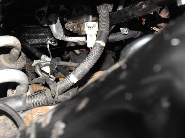

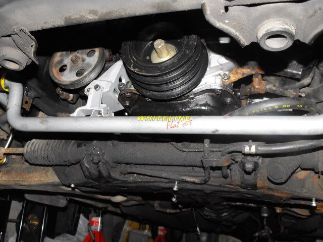

Been a while and it seems like I'm dragging my tail since I got the engine in. Well I haven't really, it's just slowly coming together. Got all but one connector hooked up. If anyone knows what this connector is for, please let me know.
It comes from the steering rack.

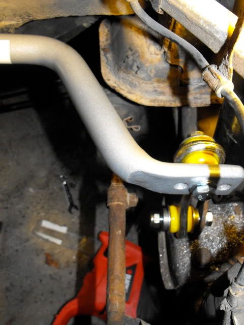

Aside from that, got those pesky endlinks off the front and fitted the whiteline. Just gotta torque it up and should be good.

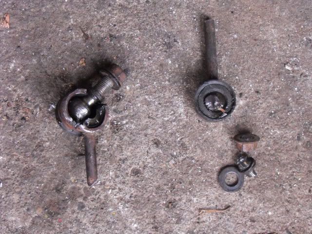

And whats left from the stock endlinks. Those bad boys were seized beyond belief:

thedave925
Since 9/16/05
Nov 9, 2005
626
East Bay, Cali
Steering rack connector is for Progressive Power Steering, a solenoid to relieve power assist at higher speeds and keep the front end feeling more connected to the road and not so "light"
The plug is on the portion of the harness coming from the fender hole by the battery, and down towards the starter
I'm fairly certain that the washers are not the issue. It sounds like you've got the same problem as me. A loosening diff... If you leave the car in gear, grab the driveline and rotate it back and forth, how much radial play is there?
Yes. They should go between the carrier bearing and the body of the car.

CajunKenny;1599142 said:
Sorry for the delayed reply Ron. Been busy battling for new wheels... ;)
No worries Ken. I knew you were busy and that you'd chime in in time. Any progress on the 'Hunt for New Wheels'? :)
That would totally make sense because the clunking seems quite heavy and the diff bouncing around could definitely cause this. I'll try this. I have to jack the car higher.
So I installed the spacers correct! Yay!

SupraRon
Jan 2, 2008
595
Canada

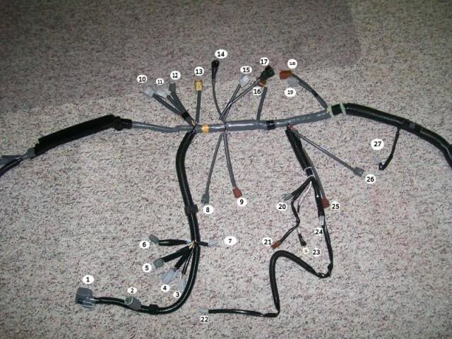

For reference, the PPS connects to #7 in this pic:
Taken from here
