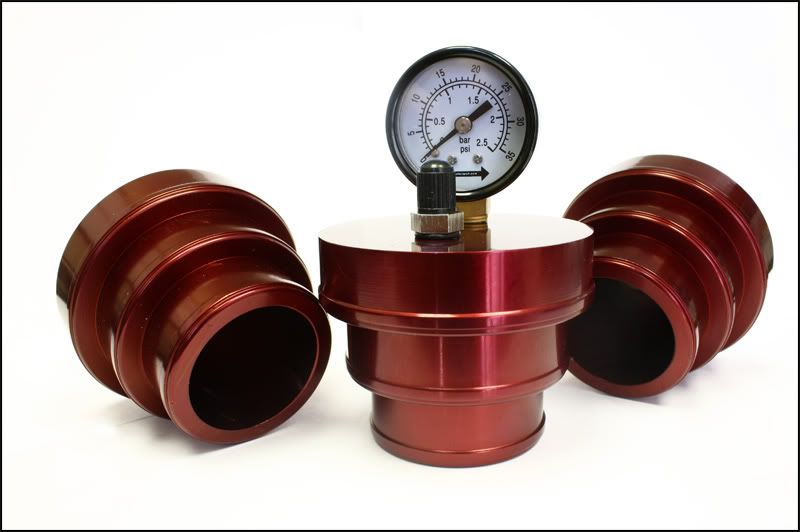

if you think its a boost leak... I use one of these, they are quite nice as they are used with the engine off, and slip into where-ever (air-filter location)
link; http://www.son240sx.org/showthread.php?125466-SGM-Boost-Leak-Tester
Is this still buyable?
