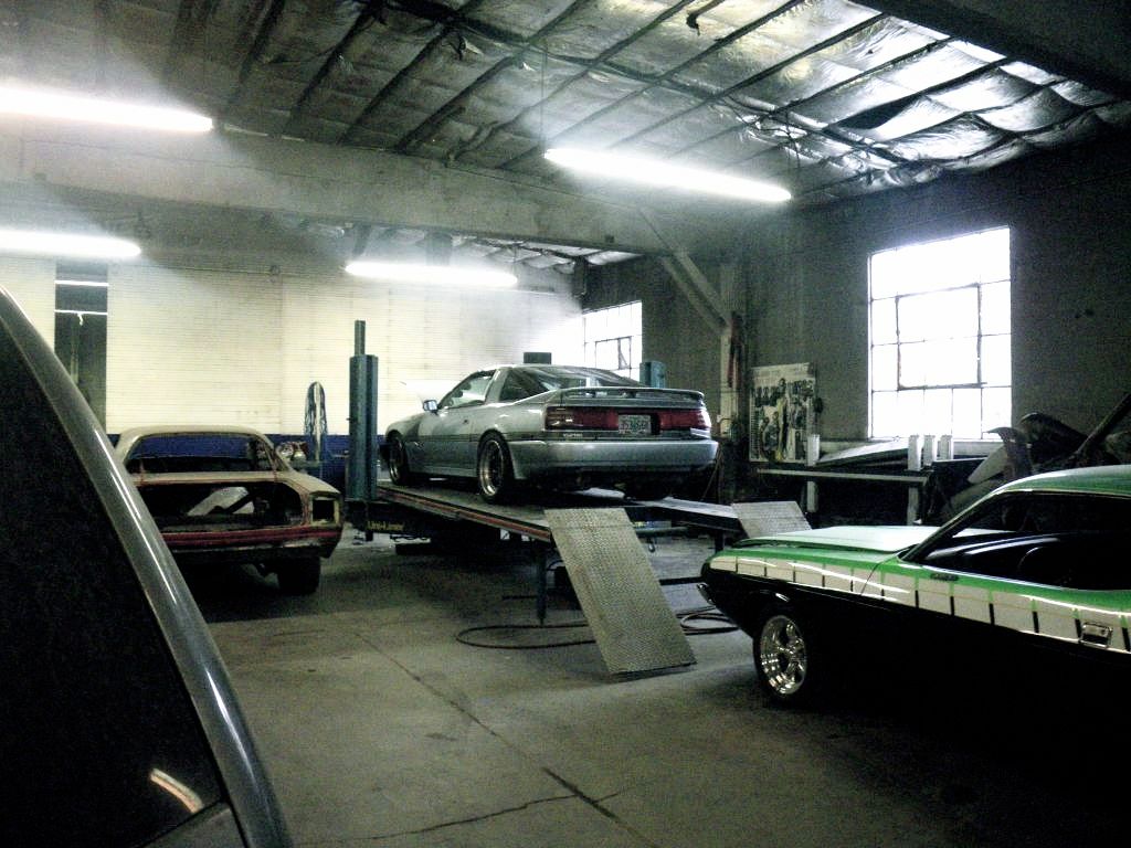

Everyone at the shop was working on a project - there was a Toyota pickup that had been rolled, a Honda civic that had been in a hit-and-run, and a restoration of some old American boat. The wood stove was blazing in the corner, keeping the place decently warm, and the dogs were running around chasing their tennis ball. Man, what a good day.

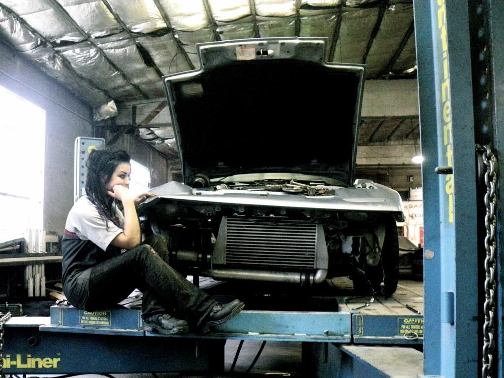

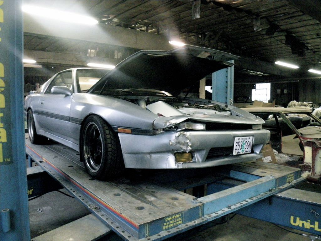

First, got her up on the frame rack:

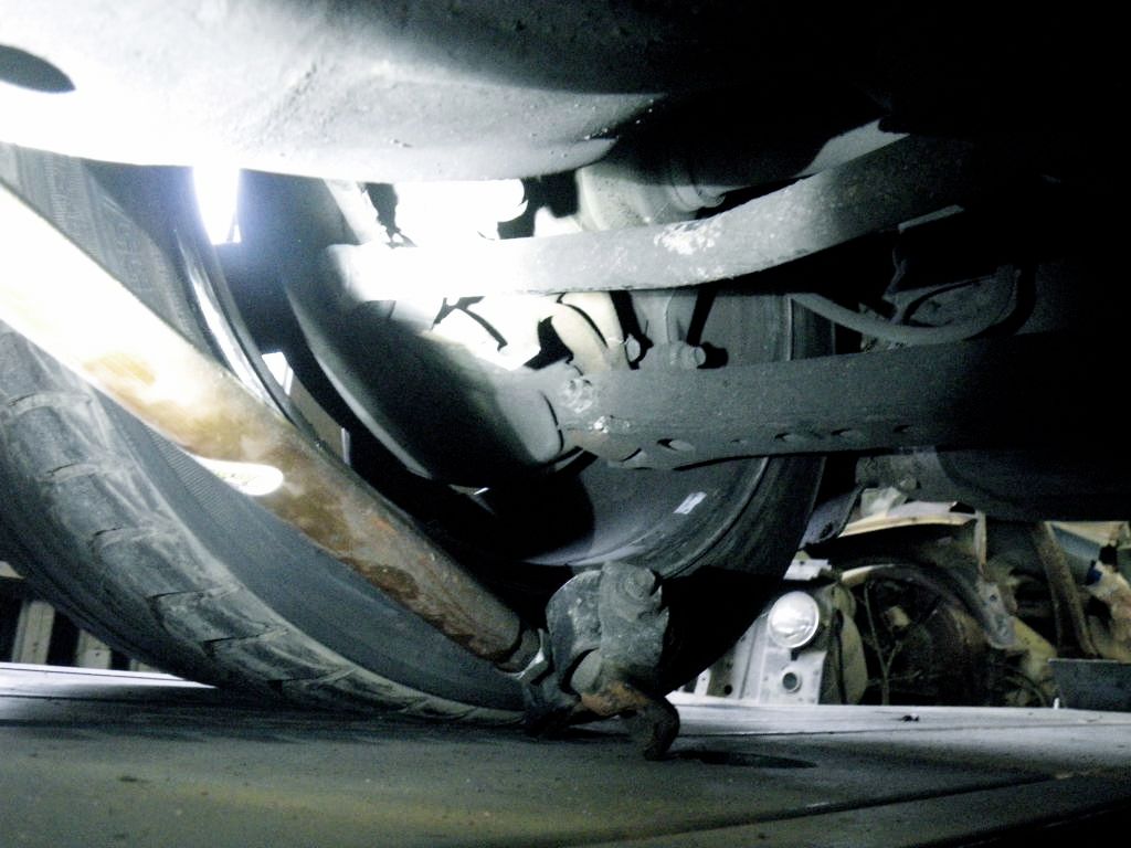

I took a bunch of pictures to document every bit of damage that happened to the car that day when she met the rock wall... I didn't realize how badly the frame was bent... Take a look:
Wow, I got my work cut out for me....

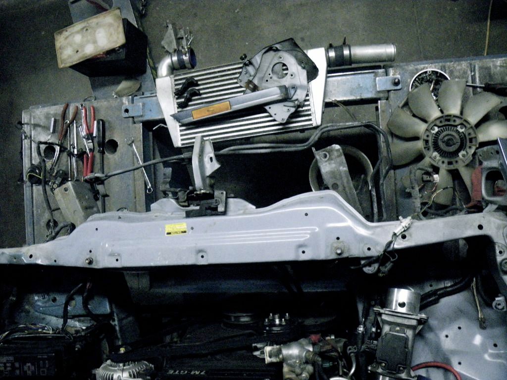

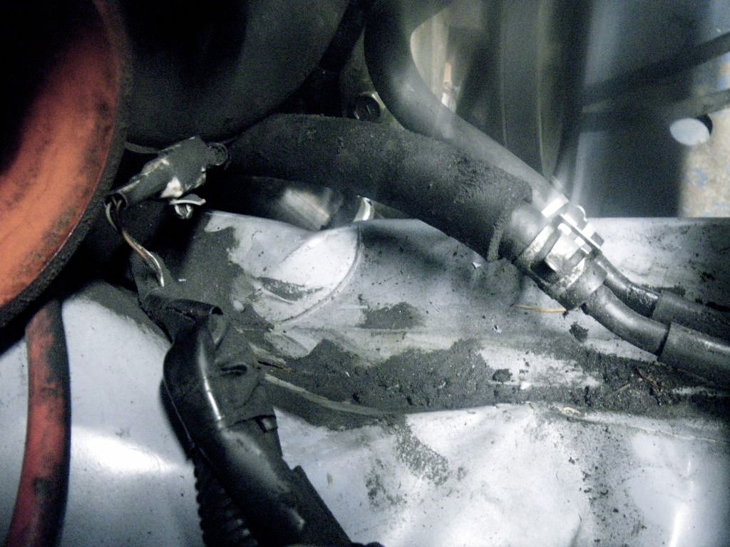

A couple of the frame buckles on the passenger's side frame rail:

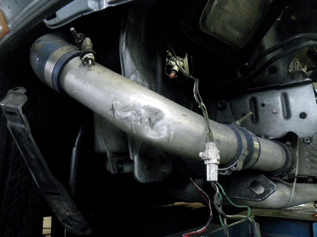

Cool, at least none of my IC piping got damaged too badly that's still totally useable (and no one will be able to see it when the bumper is back on):
gotta see the plus's, man.... :D

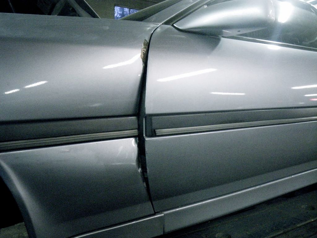

Driver's side fender:

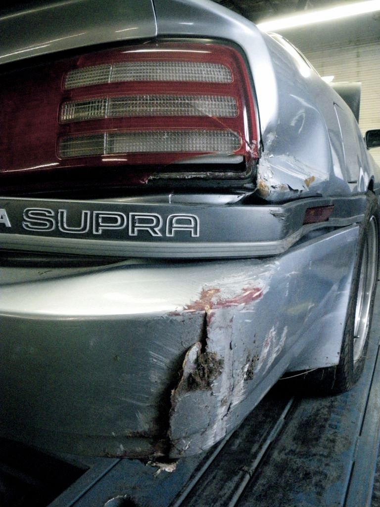

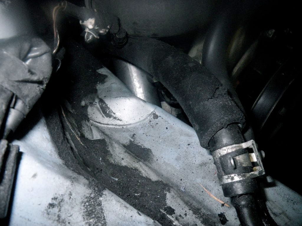

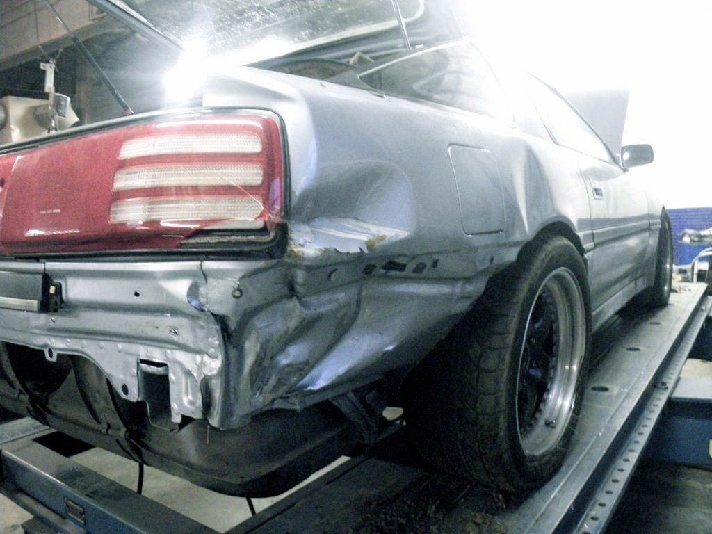

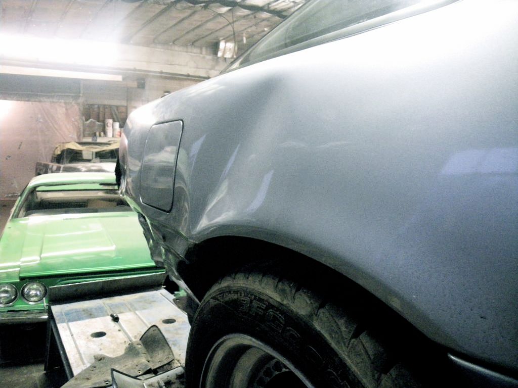

And the rear quarter panel, I knew there was something ugly hiding under there.....
Honestly, though, I think that I am just going to pull that out as straight as possible, then spray it and just let that nasty stuff hide underneath the bumper. As long as its structurally sound.... and only you and I will know whats under there.... :p

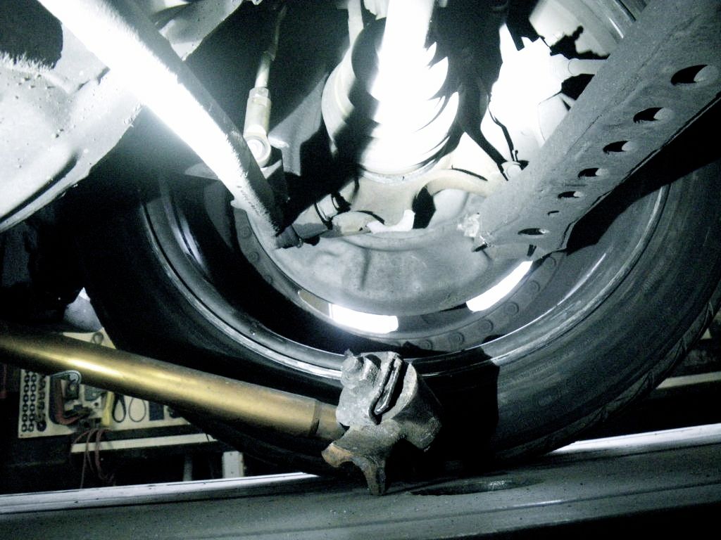

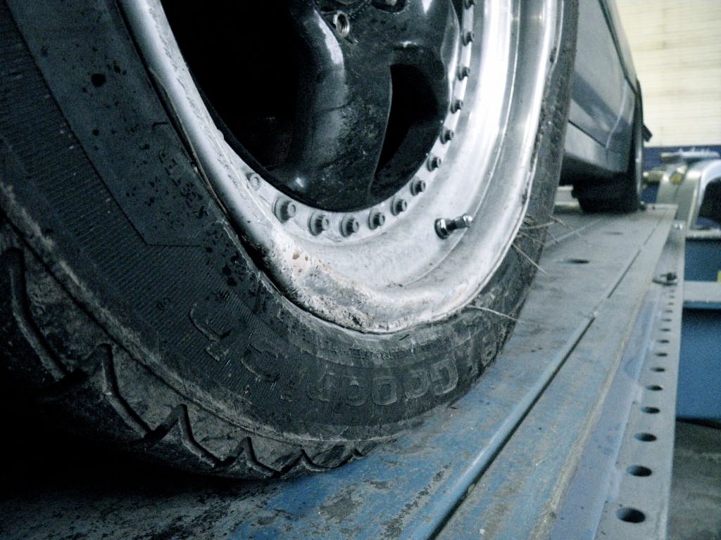

And another pic of my poor wheel....

bent front clip ewww
Still can be fixed, but the worst is when the seam sealer at the fire wall has a crack in it then ya know she really bent up
I know a auto body person and he had unibody that had munched the frame rail he pulled it back to shape. then once straight he cut out the bent crease and just tigged in parts of the rail from another car
in the end you could never tell that frame rail was that bad
in the end it's all about time since it looks like you do you own work
and the rear end looks to be an easy repair
