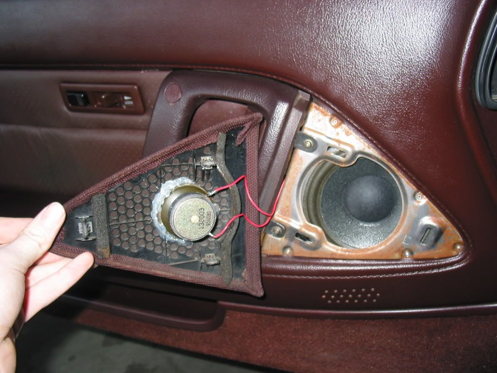

The middle speakers are 3.5" 8ohm. The fronts are 4" 4ohm and the rears ar 5" (not really 5.25) and are 4ohm.
The middle speakers are freeair. You could replace them with aftermarket speakers but it might not sound right. If you have an aftermarket headunit or amp than I would bypass those speakers and get larger ones up front and in back
