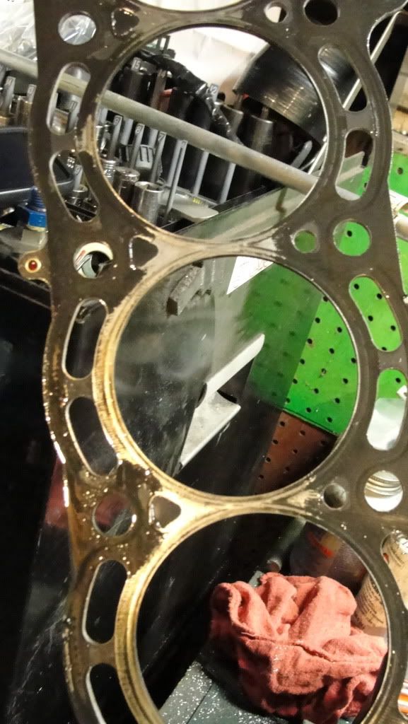

Old cometic MHG:

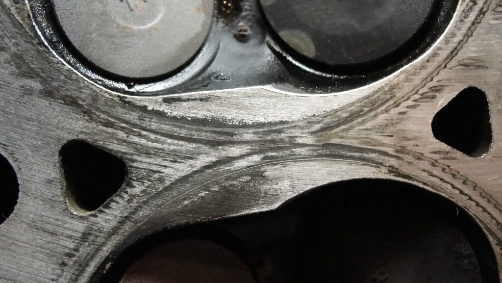

Head between the cyls

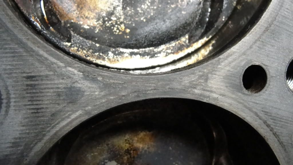

Block, between the cyls
Happy to report no melted pistons or detonation pockmarks like I was worried about finding!

Andy- the thought is that the head lifted. After that I don't trust the gasket to seal well enough. Also, see the 2nd picture- notice the uneven marks where the bead was supposed to seal- the surface of the block and head are far too rough for a MHG to seal well. Failure built into the engine before it even fired up. I've just been lucky that it's lasted this long.

I broke the nut stiction loose one at a time, then re-torqued. I've already spoken to Ian about the matter, he was less than impressed at the surface finish on the block and head.
