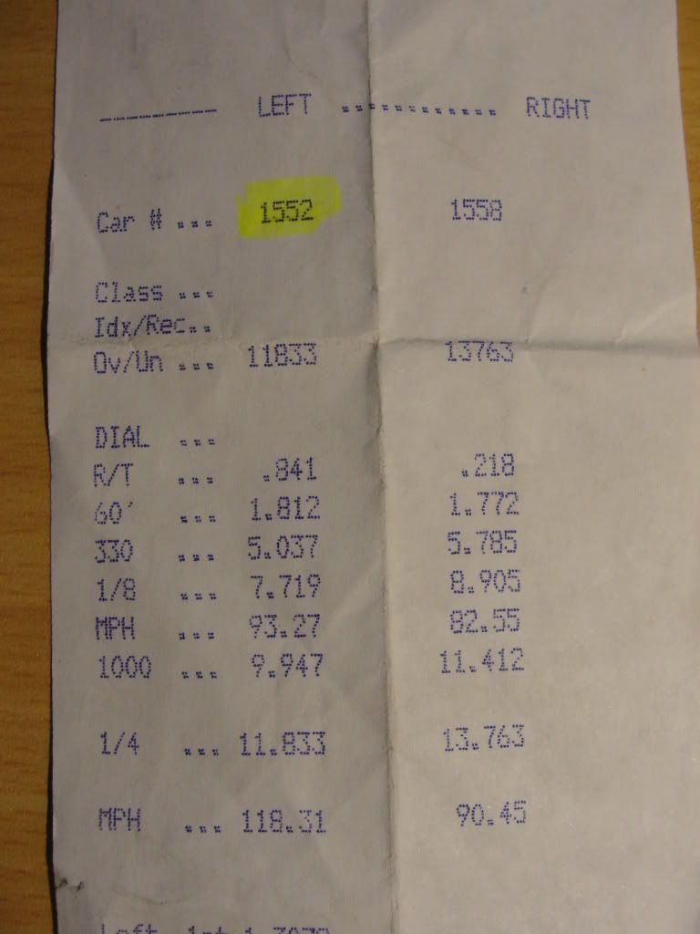

Its definately in the tires because I did another pass on my street tires (a story in and of itself :p ) and no vibrations. I'll be checking the tires for runot and road force variations tomorrow at work. I'm thinking they were set on the ground for storage and not inflated :( Oh well, time for some radials (better stability, I hope)

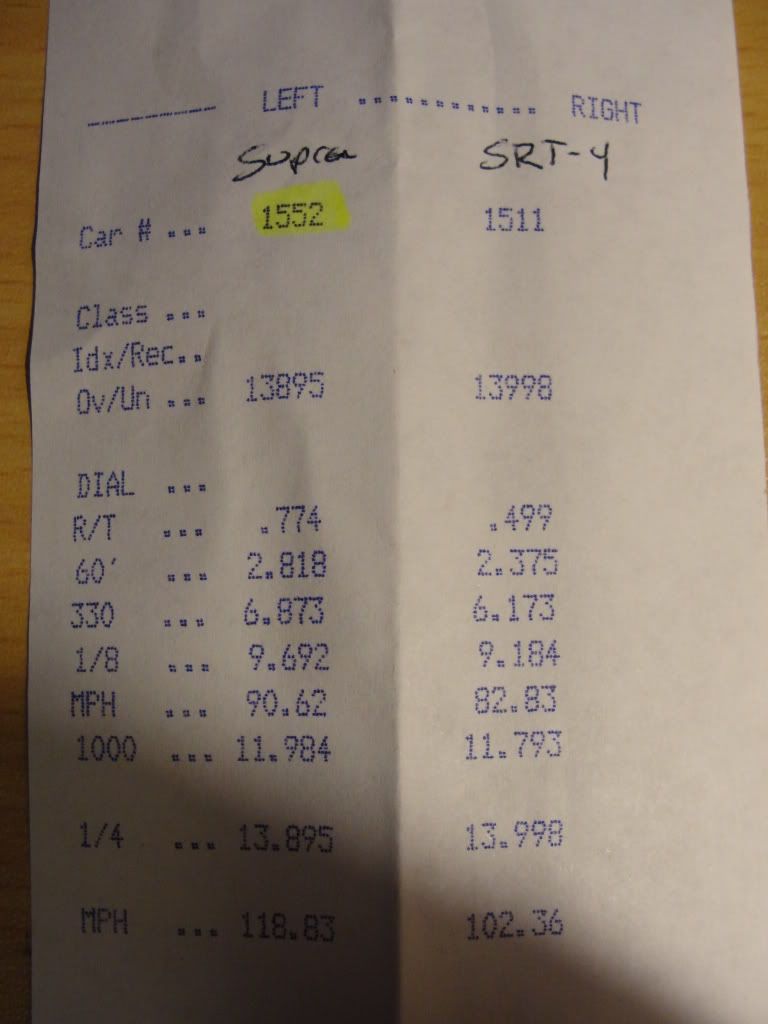

Here- read this timeslip and tell me what you think happened. *street tires on this run. It was, BY FAR, the most fun I had all weekend. SRT4 is a buddy's car.
toyotanos
What will we break today?
Nov 29, 2008
2,844
Coon Rapids, MN
Ding ding ding!
Plus I short shifted 2+3 so I dropped out of boost D: It was a blast chasing him down- I'll say it again, by FAR my favorite time had his weekend :D

Sucks about the bad tires - but that's a pretty decent time! Also sucks about your transmission - think you'll have it fixed in time for the meet?

Funny... same ET at 1/4 (approx) despite 2 seconds slower! HA!
My first run in my Supra about a dozen or more years ago... and I spun 1st/2nd and barked 3rd hard with VR rated tires @44psi pressure (I didn't know any better!) and I ran a very low 13 second pass at 117+mph. Similar to your first slip!
NOTE: My 60' time was JUST OVER 3 sec. on that attempt, too! Making it all up at top! HA!
