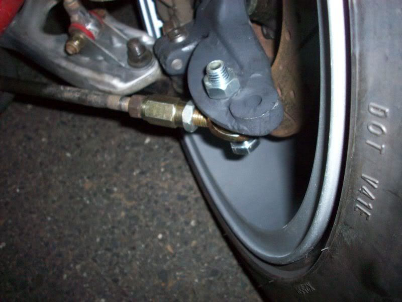

Mattsplat was guaging interest about new knuckles. I like what Im seeing, either way I need more angle

yeah, in all honestly I'd buy a set of properly modded stock knuckles.. it's not like it would be expensive, and it would be a great benefit.

I was thinking of cutting some knuckles and drilling holes on both sides of the joint, inserting a metal dowel and welding the joint. Grinding down the weld's and then boxing the whole piece. I was also looking in to gusseting and drilling like GFM's picture. I abandoned the idea from the other thread because no one would pay for what they were asking. Some of us in the PNW are thinking and working on a solution.

Ive been thinking about this pretty much all day. Ive got some ideas and a very crafty friend with a welder. No cutting, only drill and reinforce.
