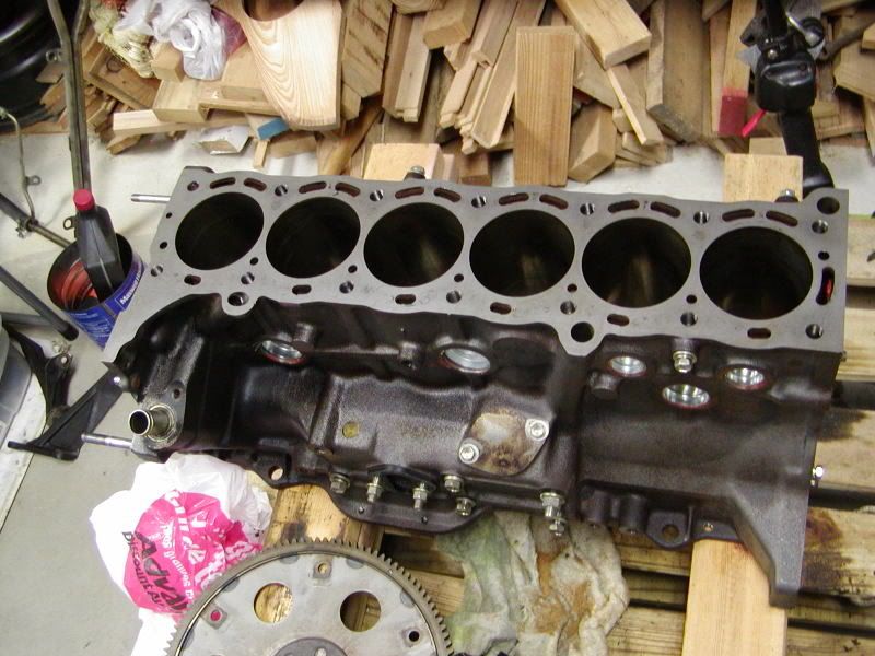

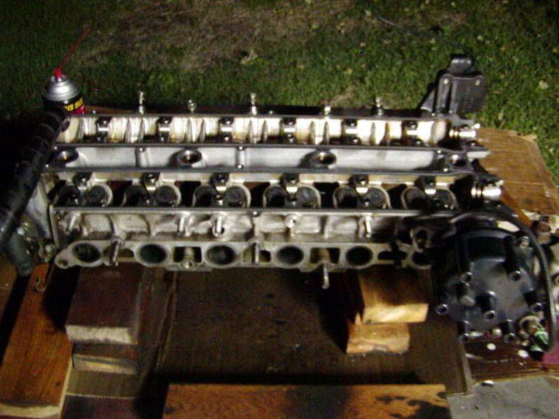

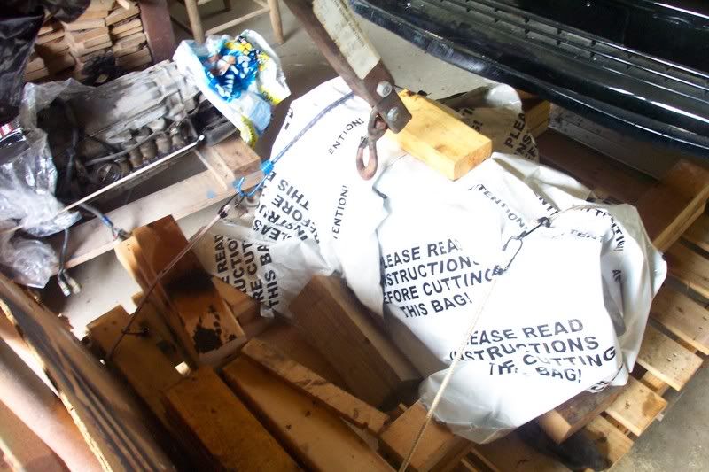

I used wood blocks, boards for leverage, engine stands, hood/trunk prop etc. when i did my rebuild. My grandfather helped me. We almost used wood blocks as much as normal metal tools...lol...
Trust me...look and see how much wood is
Laying around/or used as stands etc....lol
