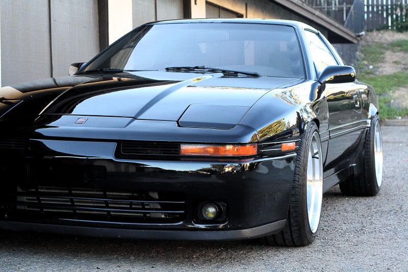

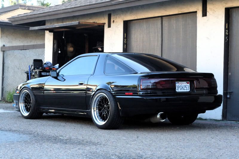

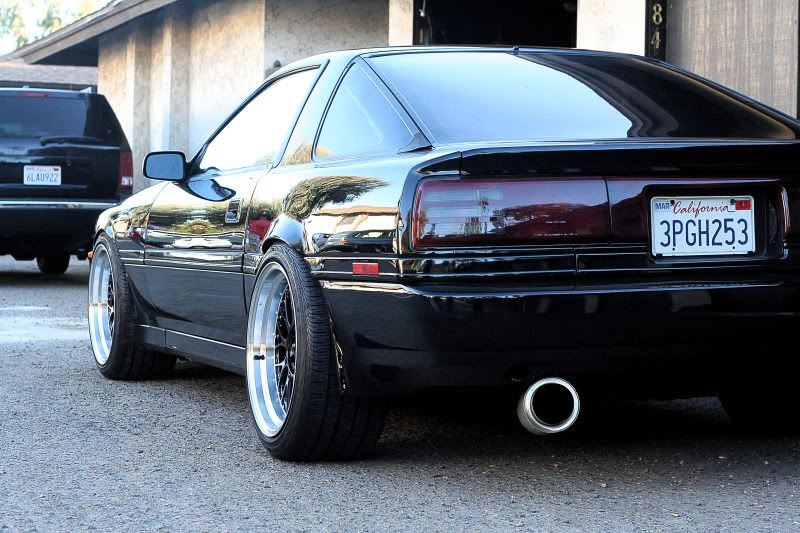

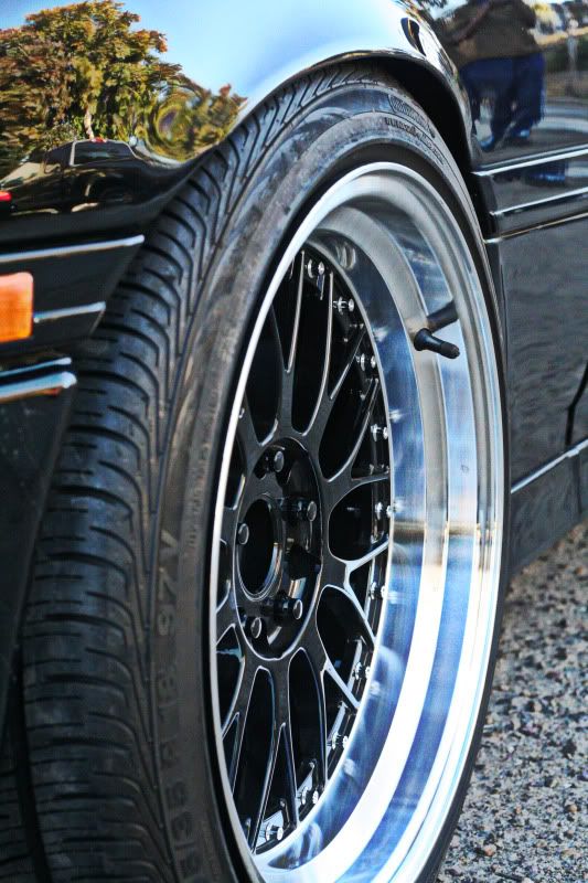

Here's a picture of Amar's supra in SoCaL..18x10 all around. +17 in the front and +0 in the rear!!! :aigo:
I believe these are his father's wheels. Siick!
