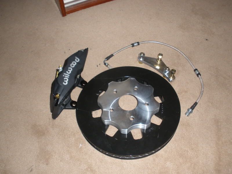

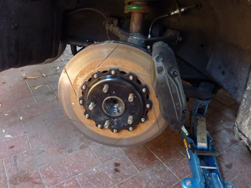

Firstly, was umming and ahhing about purchasing an ARZ wilwood kit for the front and ditching the nightpager upgrade and eventually bit the bullet. Nightpager kit is now sold and this will replace it...

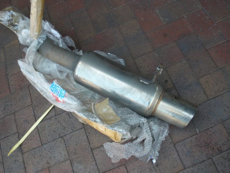

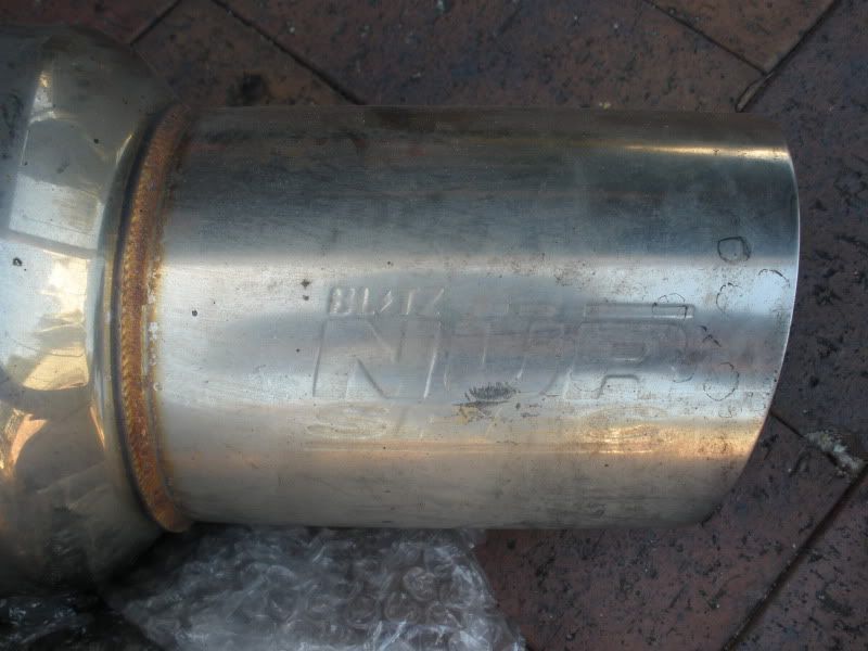

Blitz Nur spec was delivered from Japan while I was away, needs a bit of a polish but should come up good and they punch out a great note.

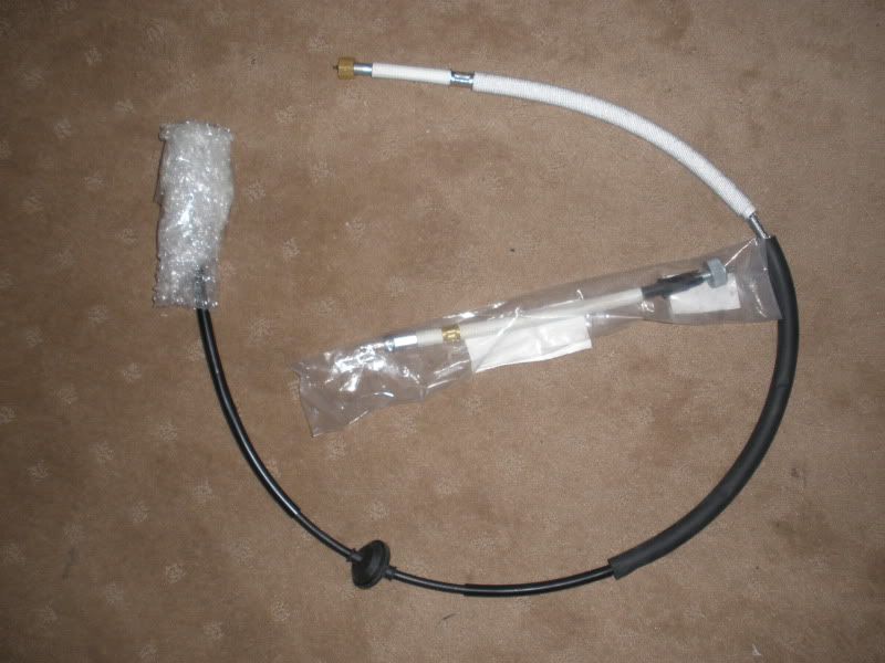

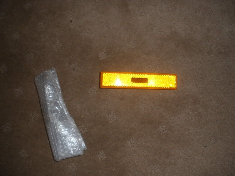

also picked up some US spec side repeaters for a cleaner look, as well as a new speedo cable as mine has snapped. thanks to Curt at Elmhurst for this, amazing service at that place!

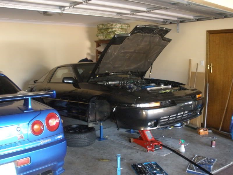

and here's my progress on the front end thus far...
nightpager kit off

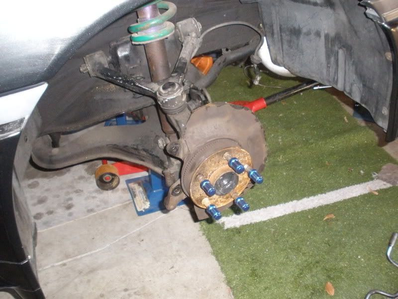

out comes the front suspension

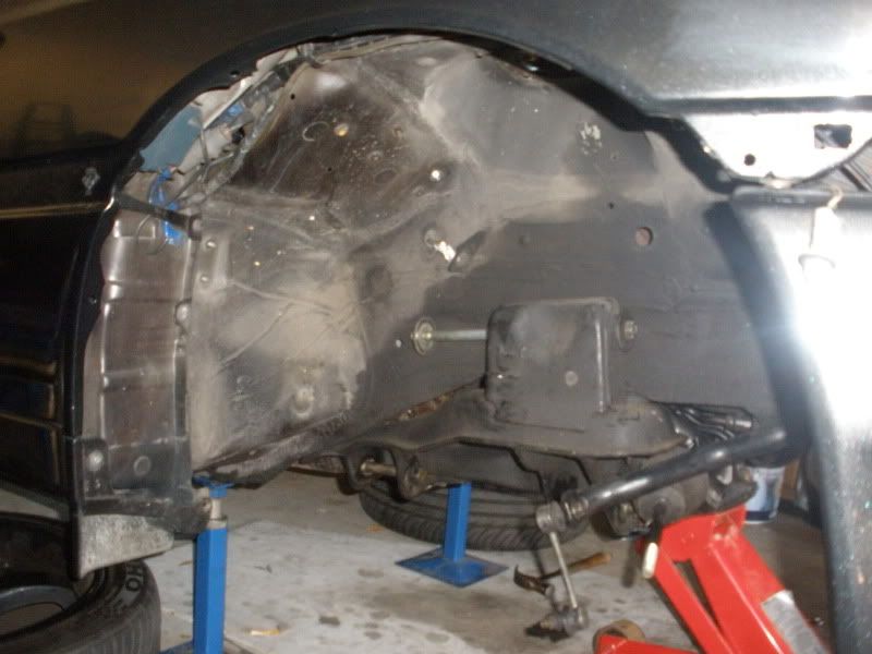

messy ass wiring discovered behind the front left guard liner, going to re-locate the fuse box back to its original position and do my best to tidy up the wiring.
in its current state.

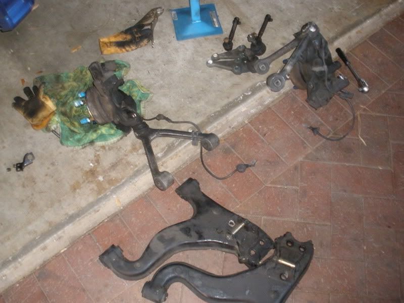

im planning on changing all perishables whilst ive got everything out, starting with the upper and lower control arm bushes. i've also sourced some new lower control arm balljoints and outer tie rod ends...still unsure what to go for with the sway bar links, anyone got any ides?
I dropped the control arms at the suspension place this arvo to have the old bushes pressed out and the new ones pressed in (old ones we're actually ok but i'd rather just do it all at once anyway). Once im done with the front end ill swap the car around and get going on the rear, in the meantime, some of the body parts that need paint are making a trip to the paint shop - i.e. rear bumper, side mouldings and turbo-a duct.

Damm, wish I knew about the night paper kit too... ah well.
Good to know you got through regency. Did you get through first time, or did they make you come back?
Jealous of the brakes.

brakes were up on sa supra for a while, ended up selling to a local guy on toymods tho. Got it through the second time, although it was just an ID inspection, the guy and his lackies took the liberty to go over every aspect of the car with a fine toothed comb, torches and all! They wouldn't clear the car's ID until I hooked up my heater, got the vin stamped onto the chassis and changed to a factory steering wheel. Oh and they also took away my friend's trade plate anHey mum what size is matt again?d made me walk in 40deg heat to the rego
office to buy a permit so I could drive the car home...apparently you aren't allowed to borrow trade plates...
The calipers are off an r32 gtr but are basically the same as z33 and s14/15 etc.

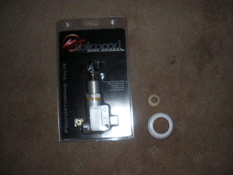

well, ive had a minor set back with this. turns out Energy suspension made a mistake when they packaged my front control arm bushing kit and accidently put a completely random part in there. as a result, im missing one of the bushings for the lower control arm. Aaron from driftmotion is onto it for me and is sending me the right part so ill have to wait a little bit for that to come before i can finish the front end. however I can still get going fitting up the other side but first I need to degrease everything - i want it to be clean enough to lick :p

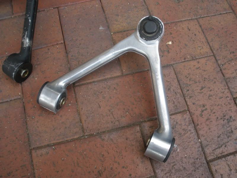

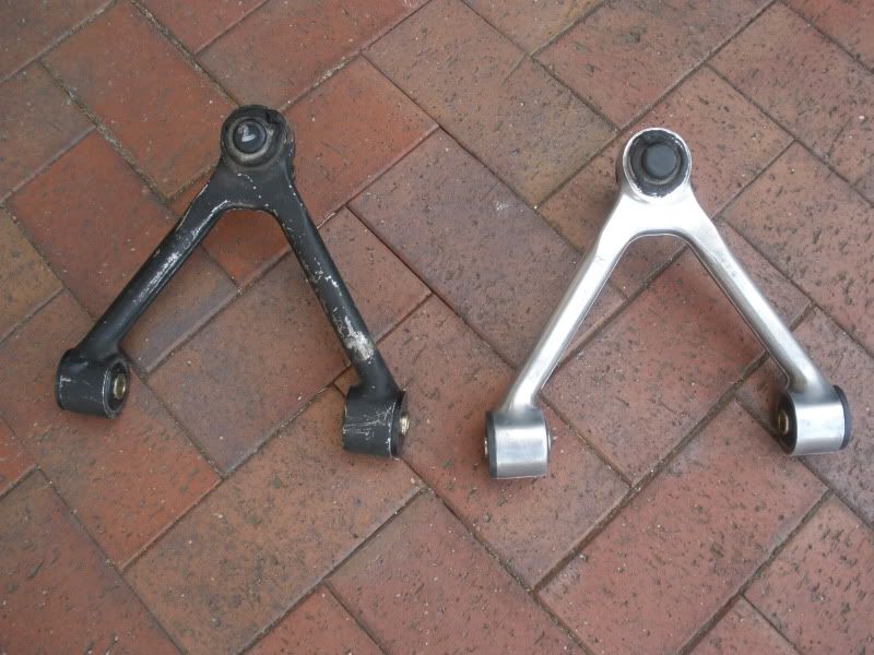

i got going on the upper control arms today. just hit them with a wire wheel and a quick hand polish with some good ol' autosol. clean enough for me!
so...
Looks good, I'm planning on cleaning up a spare pair of arms and putting new bushes in them too. Leaving them last on my list of parts to polish at this stage, but looking at yours makes me want to get into mine right now

yeah it was actually really easy with the wire wheel. took me about 1 hour to do both. i could have gone further with wet grit and got rid of all the casting marks but at the end of the day its in the wheel arch and can barely be seen so as long as they're clean, im happy.
I usually use a file to get rid of the casting marks, can take an eternity sometimes
I'll case it out when its time to detail them, currently I'm trying to stick to a certain order for detailing parts to keep the momentum going

i spent all afternoon degreasing today as previous owner obviously didnt degrease all the grime and ps fluid build up when he had the steering rack rebuilt. upon going to re-fit my lower control arms ive realised those idiots at the suspension place who pressed in my new bushes pressed them in the wrong configuration. so far this whole bushes experience has been one big fuck up and whats frustrating is that the things that you pay "professionals" to do always end up taking longer and usually involve error. i've just remembered why i rarely pay people to work on my car.
