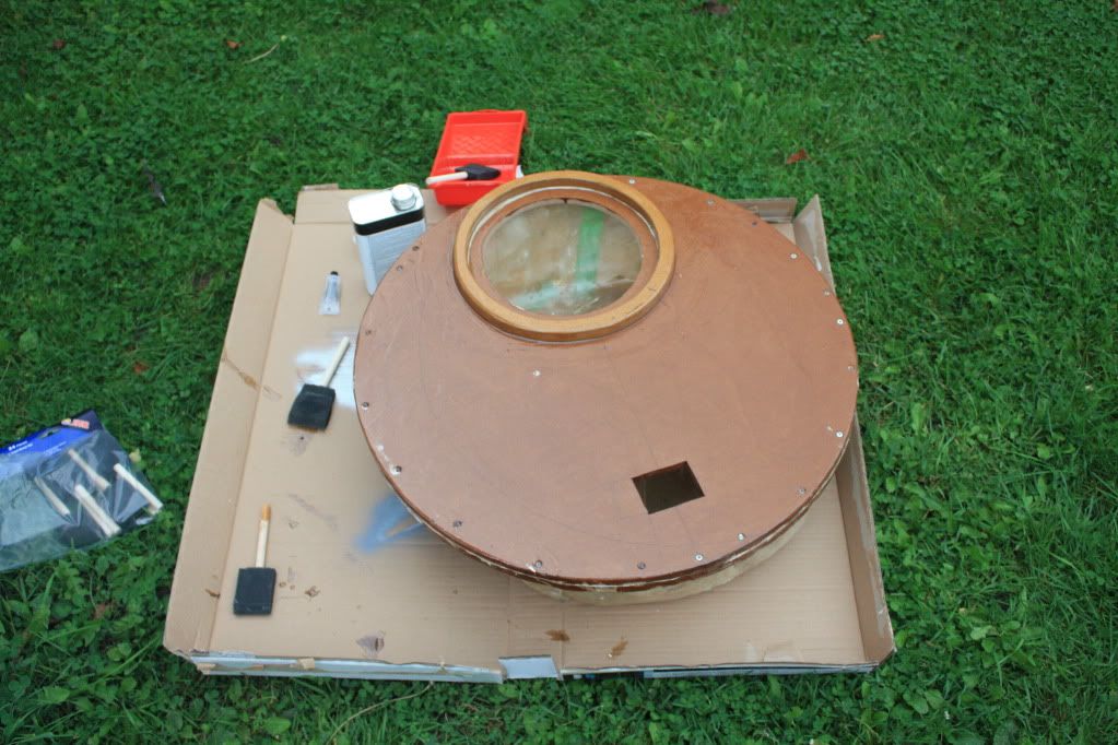

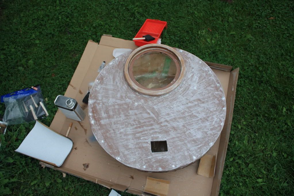

So, I decided to use the spare tire well for my sub box. I removed the spare tire a year or so ago anyways since my rear wheels are a larger diameter than stock and I have a BBK. This makes the spare useless no matter what. So, I discovered that I could use the well as a mould for the fiberglass part of the box. I had never worked with fiberglass before so I had to go by what the guys on the internet said to do. It turned out decent but there are some things I would do differently next time and I'm sure it would turn out better.
Here are some pics I have taken along the way. Not done yet but it's getting close.

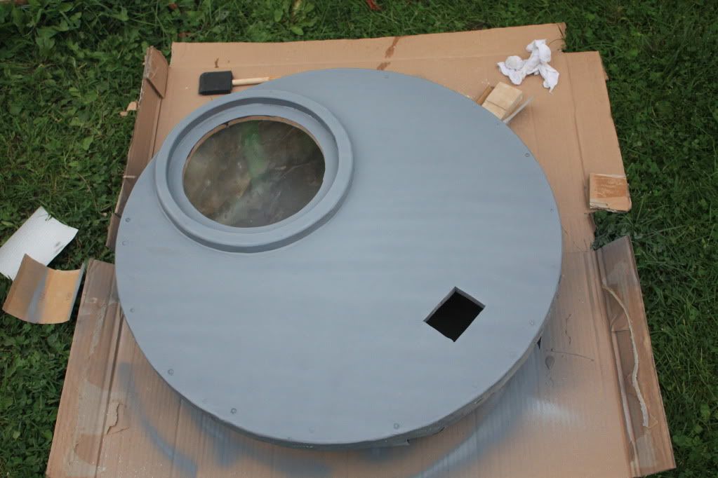

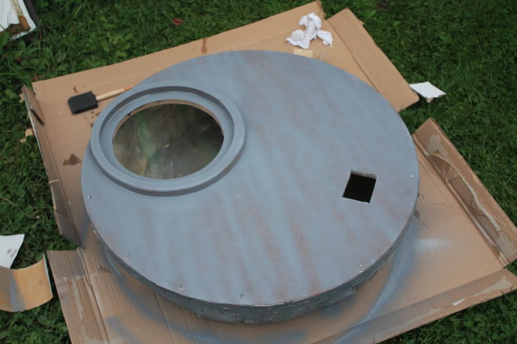

Here is my progress as of today. Got the primer sprayed and am now trying to get some paint mixed to match the trim colour.

Nice job but that wire panel really isn't the best idea to use, especially in a sealed box. A lot of potential for it to leak air or blow out. They usually just suggest drilling holes pulling the wires through and siliconing the holes.
Just out of curiousity how far above the well does it sit? And did you measure its volume?

The panel will be screwed and sealed in place with silicone. Not too concerned with it leaking. I want it that way for ease of removal when I get to the track. With this setup there is no need for tools. Hopefully later today I will get to paint but if this weather doesn't warm up I might need to wait till the weekend.

I had planned on doing something similar until I test fitted the sub box and realized there was sufficient space under the edge of the box on each side to allow my fingers under. Should be pretty easy to lift out since it won't be that heavy. Damn rain clouds are making me wait till friday to paint the box. How long will it stink of fiberglass for? It is still really strong and it has been outside since the fiberglass was laid.
