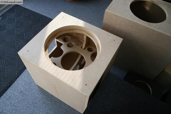

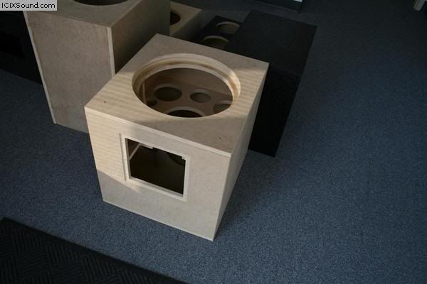

Nice sub there! The box is a little on the large side for a 10" type X. Ultimately i think a 1.3cu/ft box would be perfect for it minus the displacement of the sub. Im currently using a 2cu/ft box on my 12" RE and its even a bit big. I like the boxes slightly larger just to help on the bottom end, but in very punchy music and alot of double bass, the sub gets a little sloppy. If you dont want to buy another box, what i would highly recommend doing is putting some angled baffles inside the box and even some wood blocks to lower the displacement. The baffles will also help in sound reproduction by seperating the back waves of the speaker and removing internal resonance. You want the box to be about 1.6 cu/ft so with the sub in it, it would see about 1/35-1.4 cu/ft.
As stated earlier if you really dont know what your doing with a port, dont try anything. But if you are crafty with wood and want to try it, i can draw up some plans for whatever you want... SQ, SPL, SQL. I build boxes on the side and have a good deal of knowledge on how a ported box works.... Adding a port has a lot more to involved than just adding a tube or slot. Besides, that box is a bit small to port anyways.
