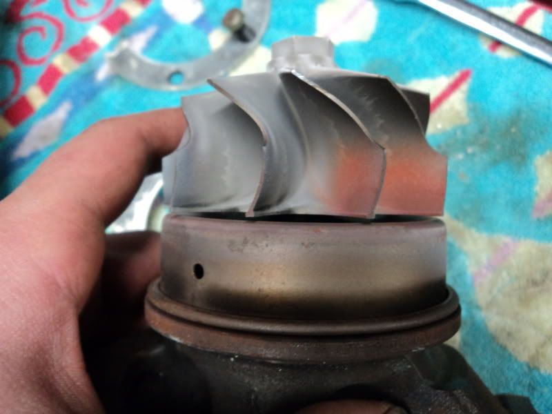

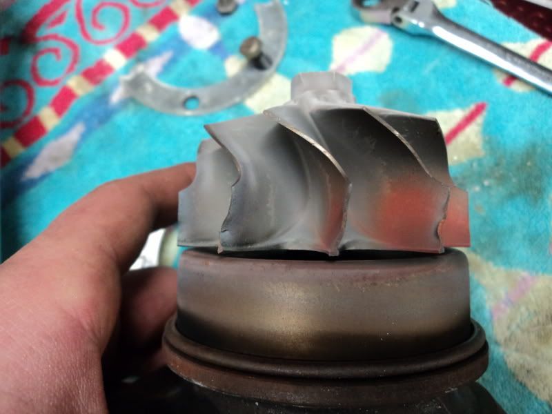

well turns out my turbine wheel has sean some crap it not to bad but still fuck .............
gonna call PTE tomorrow
big qestion is should i just say fuck it and run it or fix it :cry:

Fix it for sure. Easy mode would be a new shaft/turbine wheel, I'd throw the bigger hotside (.80+) in for keeping the EGT's down- looks like it got really hot (might be the angles too)
Edit: even though the midrange will suffer, your top end will be un-corked :D

To fix this proper is to go over the hole egay manfold and make sure there is no extra slag to fuck shit up if i fix it but i really don't hav the time for it right now

well i know i need to run a bigger hot side to kill off the heat so
the hot sid eo have right now is TH6865A

Crap weld debris falling off the inside of your chinese manifold?

If the wheel has been damaged then it will be unbalanced. That's going to cause problems in the long run so you're better off fixing it now before all the other parts get messed up.

that what I figure
maybe it was because i went over the hole exhaust manifold and well there boogers but that shit wonte come off
i might even get it warrentyed
