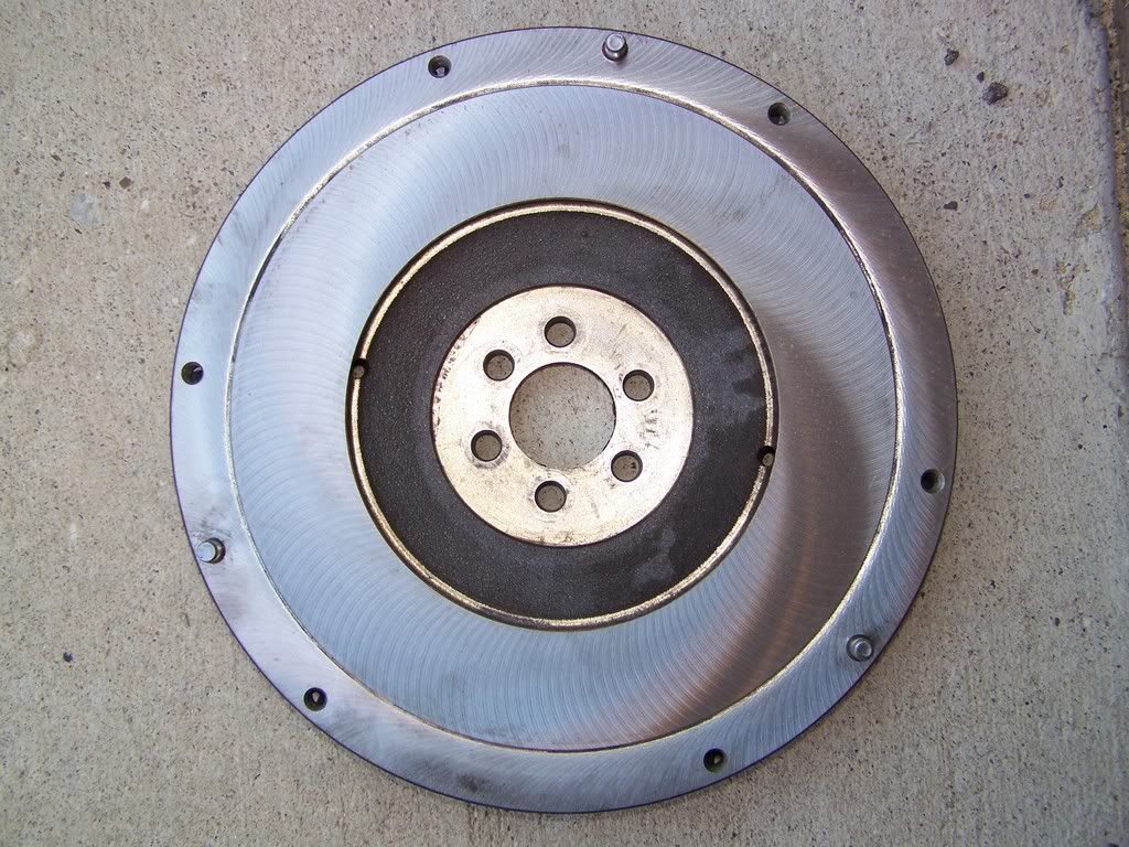

Discoloration is normal, cracks are not. Also, flywheels are not cut the same way brake rotors are (not cut on a lathe, but ground).
This is what a properly machined flywheel looks like.

80083r;1852009 said:
What's the reason for that? I can turn parts on the lathe at better than +/- .001" total runout... Is it the surface finish?
When you turn a part it's like a groove in a record, grinding gives a crosshatch pattern that won't glaze during the breakin period.

Always had access to a Grinder so have never bothered, it's not an expensive process to get done correctly so why risk the PITA job of having to drop the Trans to do it right for a few $?

Not to mention if it's heat checked it's NOT going to turn in the lathe without some chatter...

Excellent, the process *could* be done on a live tooling lathe (you can stick a grinding head on there) but you're right, if the finish you need comes from grinding, then grinding is the right way to do it.
