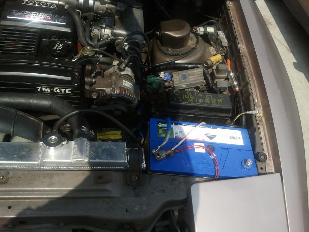

The OEM Panasonic battery from an older body style scion XB (same as most newer corollas) fits perfectly, weighs 10 pounds less than a stock sized battery, and is dead nuts reliable for at least 6 or 7 years. This isn't the same as buying a battery from the dealer, cause those are regular aftermarket batteries. You need to actually buy it out of a wrecked car or from a salvage yard as far as I know.
The battery looks cool, it's got clear sides with a gloss black top, and its serviceable (it has screw caps to add acid/water). I only have a top down shot of mine before I put the hold down on it...
