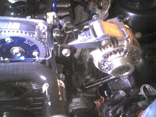

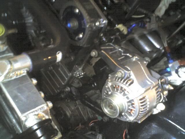

Both MR2 and Viper alternators are going to be a good 20% larger than the factory alt. Several months back I bought one of those $89 130amp advertised alternators off of ebay and it's a good 30% smaller than my factory alternator. Bolts up just fine, but just don't expect it to put out 130amps :biglaugh:
These are just test fitting pictures that were taken before I sourced the correct lower adjustment bracket from Sethron. Still, you should get the idea of the size. Also, that is a custom 48mm pulley I had machined. The factory size I believe was around 62mm.

Don't know exact dimensions off the top of my head. The alternator appears smaller in every dimension. Mostly side to side circumference; not so much front to back. I tried to figure out what vehicle these alternator cores where sourced from, but the only distinguishing marks are an "ND" on the rear cover; which is no help at all.
I can try to take some measurements the next time I'm in the garage; if I can remember.
Still, if your looking for a smaller alternator; this $89 one is probably your best bet.
