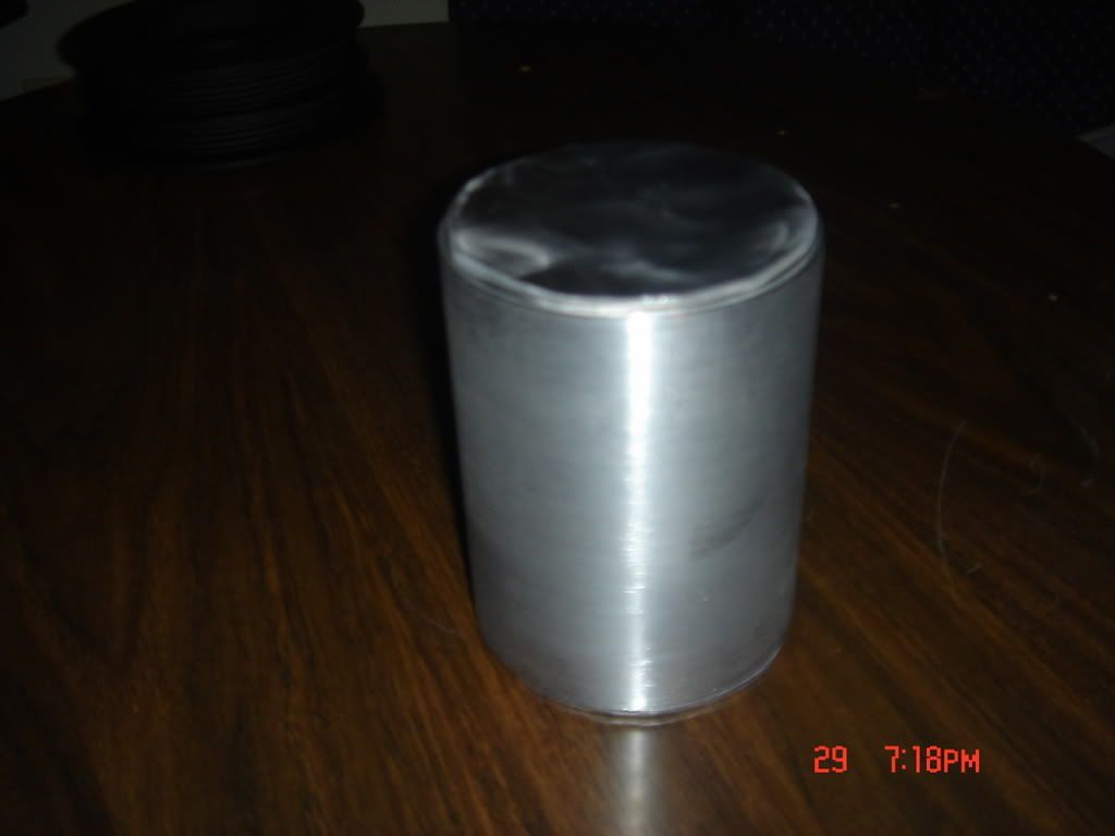

Ok well today i started making my custom power steering tank cuz god knows i cant use the stock one why the hell would i do that but here is a pic of what i got so far still not sure where im gonna mount it tough.

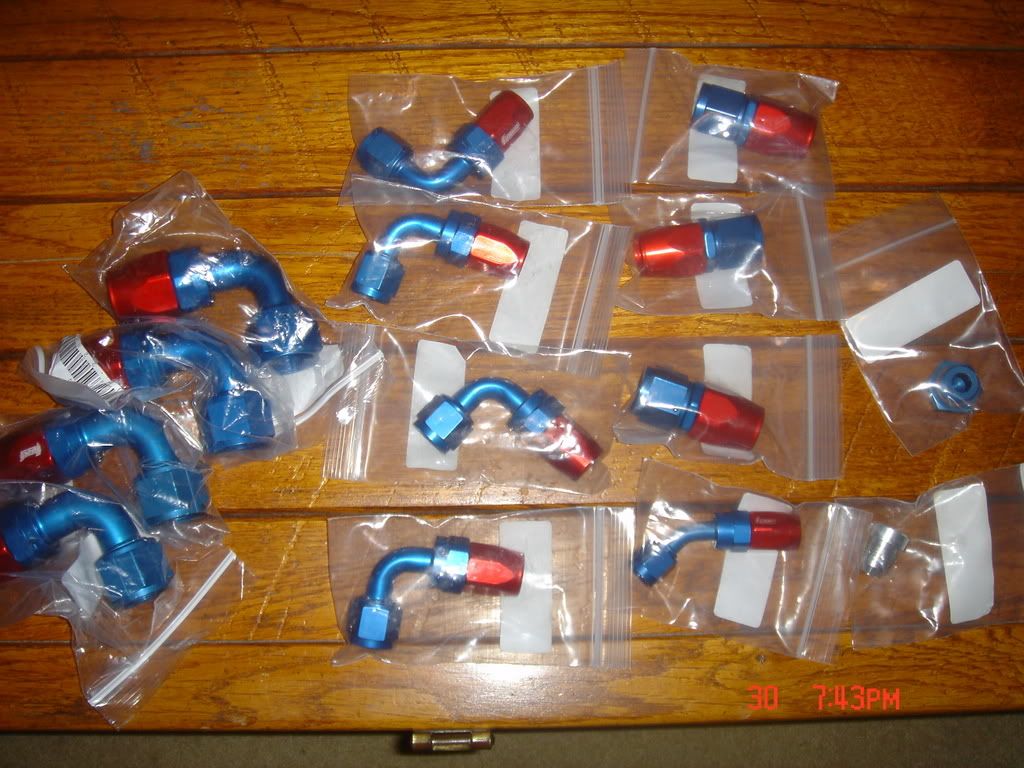

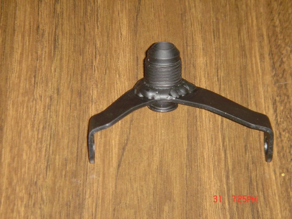

First i would like to say photo bucket sux my ass latley. But i went to summit last night and picked up a bunch of fitting but i still need alot more.

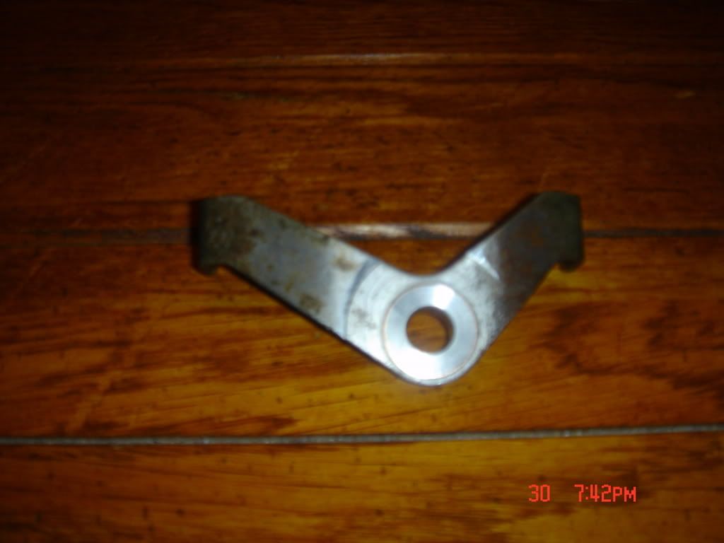

And i did some more work with the power steering. I took the factory feed that bolts to the top of the pump and put it in the collet lathe at work so i could face the top of it off where the factory line come in at so i can weld a 8 an bung onto it cuz i love the braided stainless lines.

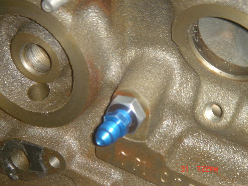

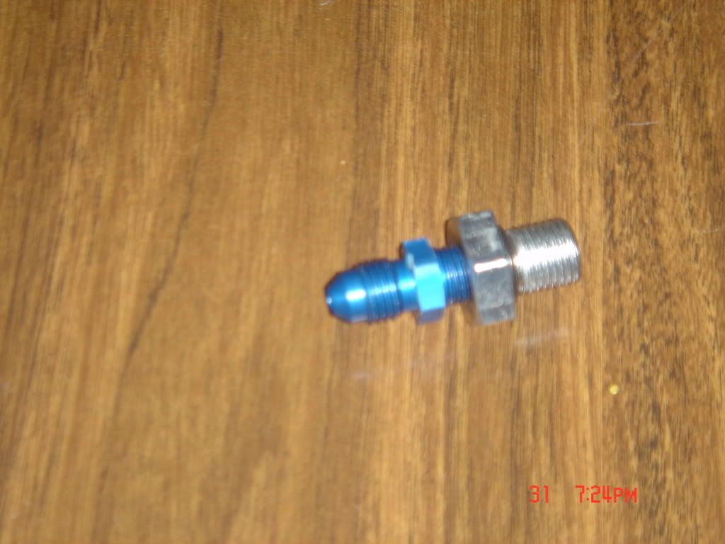

Ok well i finshed my power steering feed today.
I made my turbo oil feed line adaptor it threads into the stock turbo feed location but has an 1/8 NPT tap so i can thread in my 4 AN - 1/8 NPT adaptor for my feed line.

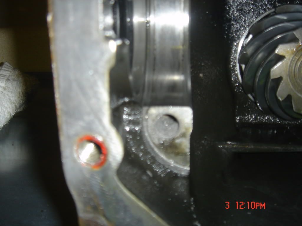

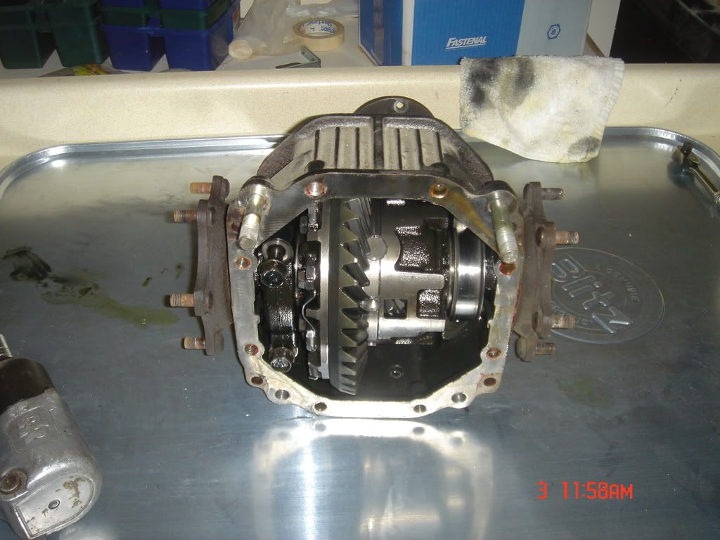

Ok so my rear diff had to much back lash and the gears were slaping around and it was pissing me off.
So i decied to to re shim it and fix the problem but the lower left gurdle bolt decided to guld up and rip out every single thread in there so now that housing is a paper weight. I also found out last summer that when i rebuilt it and put in a new lsd spring for japan that i put the shims in backwords = to much back lash = a now fucked rear housing so i was kinda pissed about that
