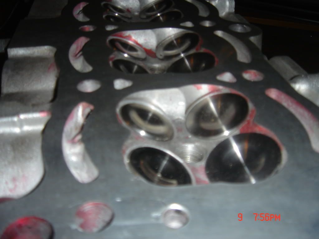

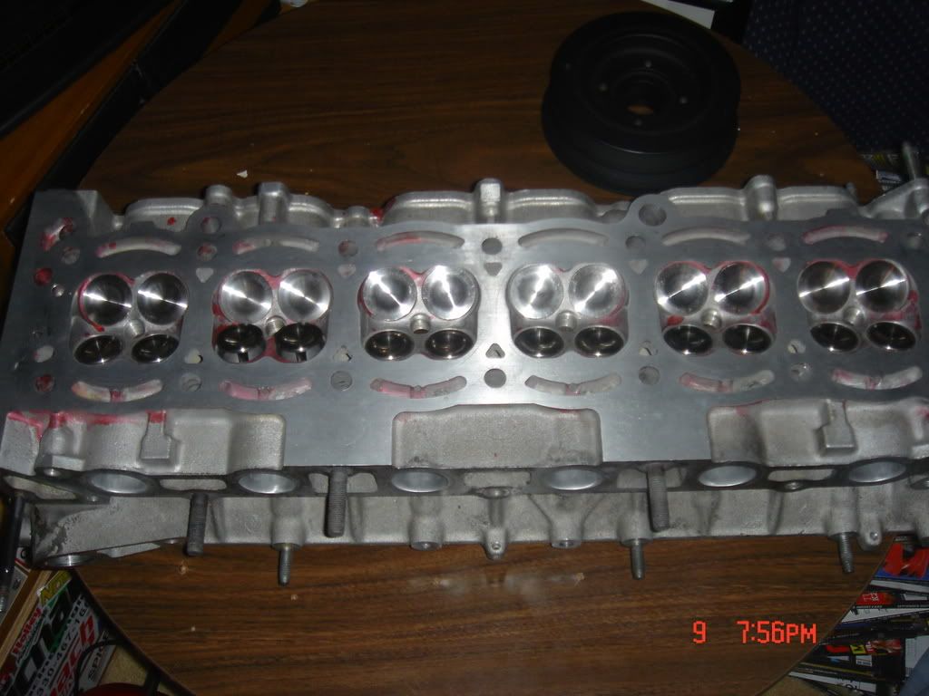

Well on thursday shane droped off my head for me it looks nice 1mm os ferra ss valves and a mild port and polish. NOw i need to throw in some springs and cam it.

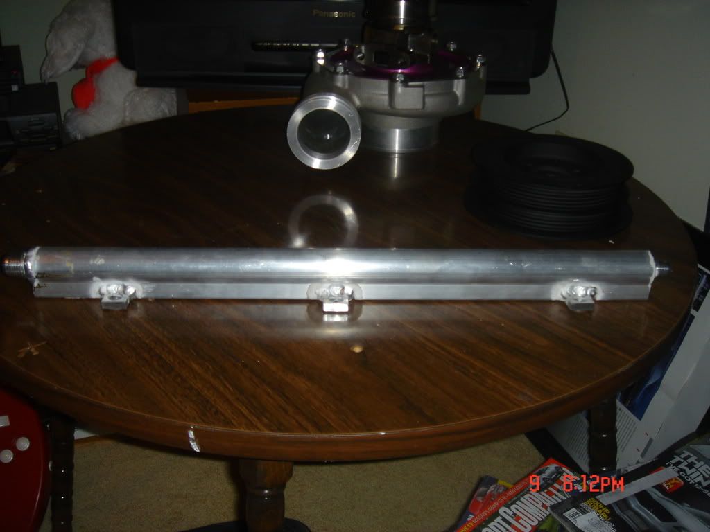

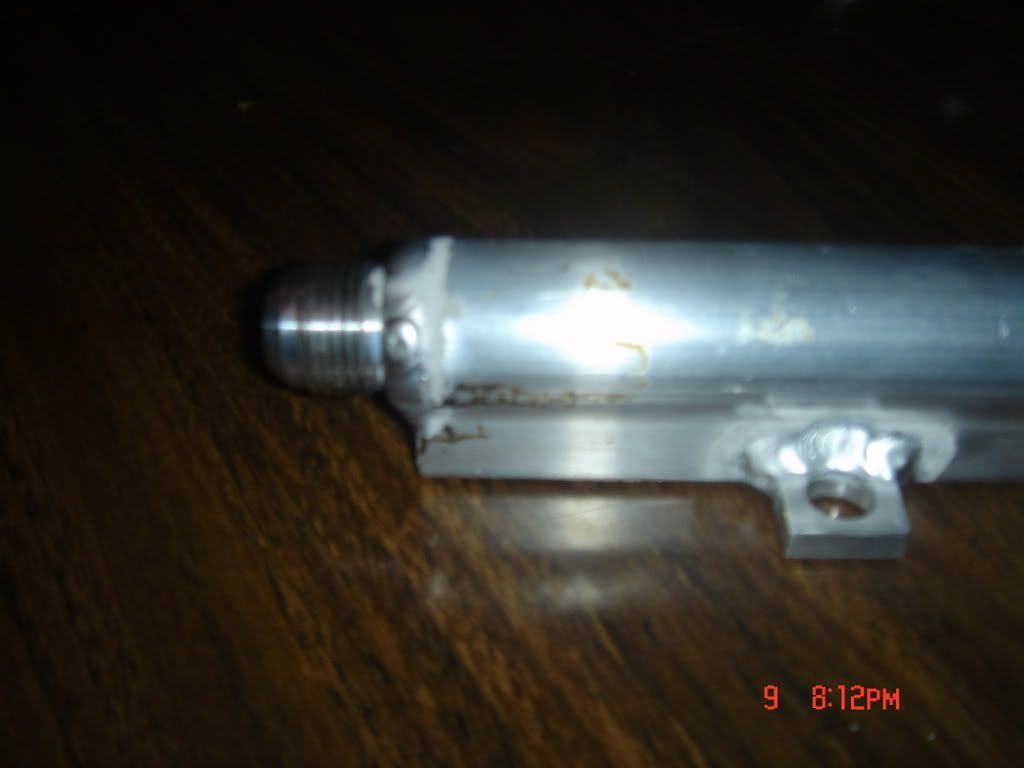

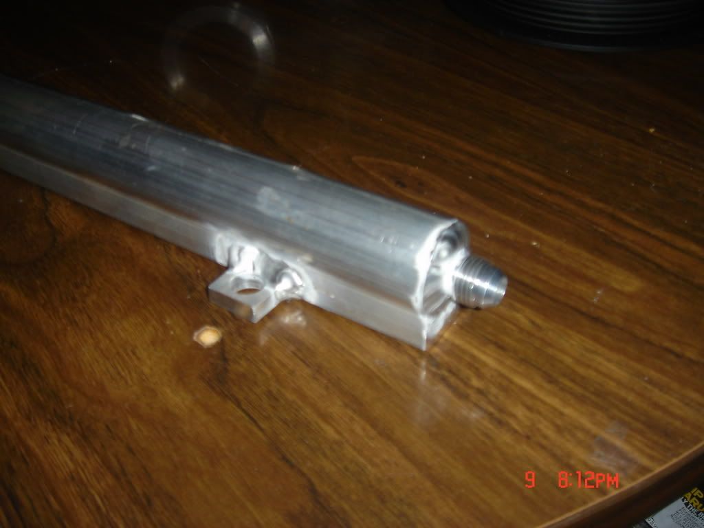

Today i picked up my fuel rail from the welder it looks great.

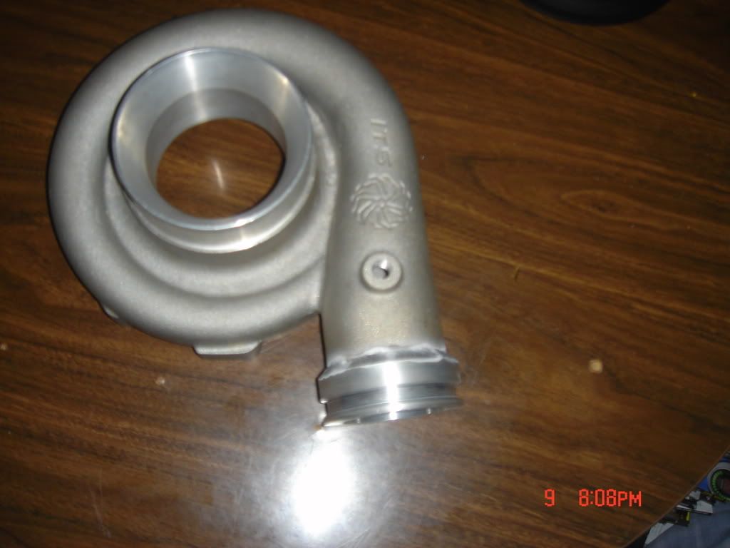

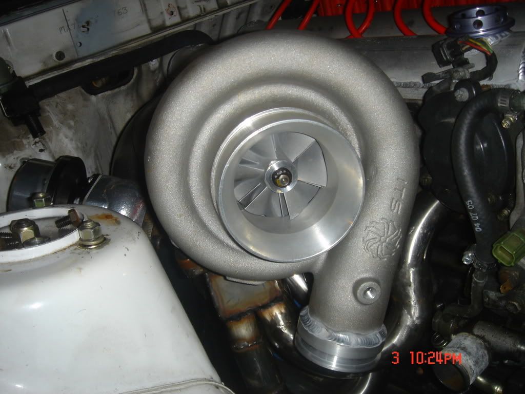

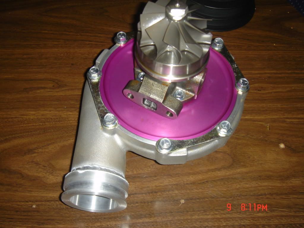

And i got my turbo housing back.

Ey Wes, your Fuelrail look pretty cool, i have done also a custom one, i only have weld it together. But i feed it from both sides with D-06 and one central return also in D-06. THe feed Line from the pump is a D-08. My inner diameter is 17mm

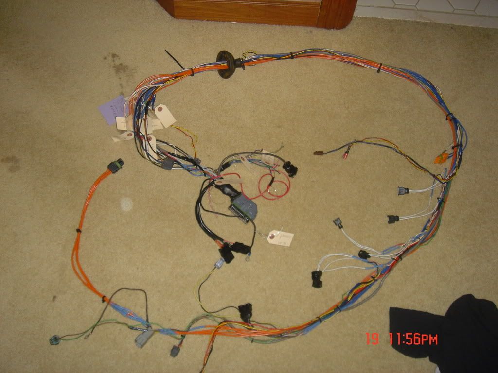

Ok i got my ecu harness back from utah jason finshed splicing the two toghter for me cuz i cant understand them damn aussie instructions.

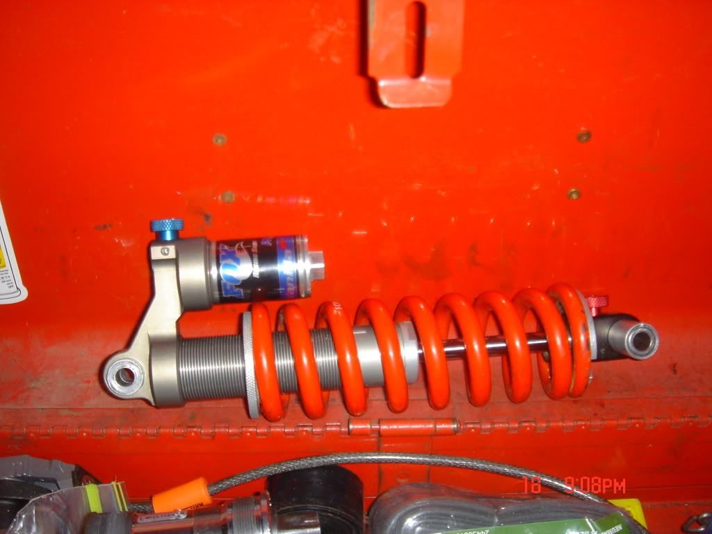

And here is my new toy well kinda its new to me. I decided to get back int biking and maybe race some this year. My bike should be done in a few weeks but my car on the other hand well........:3d_frown:
And the rear shock.

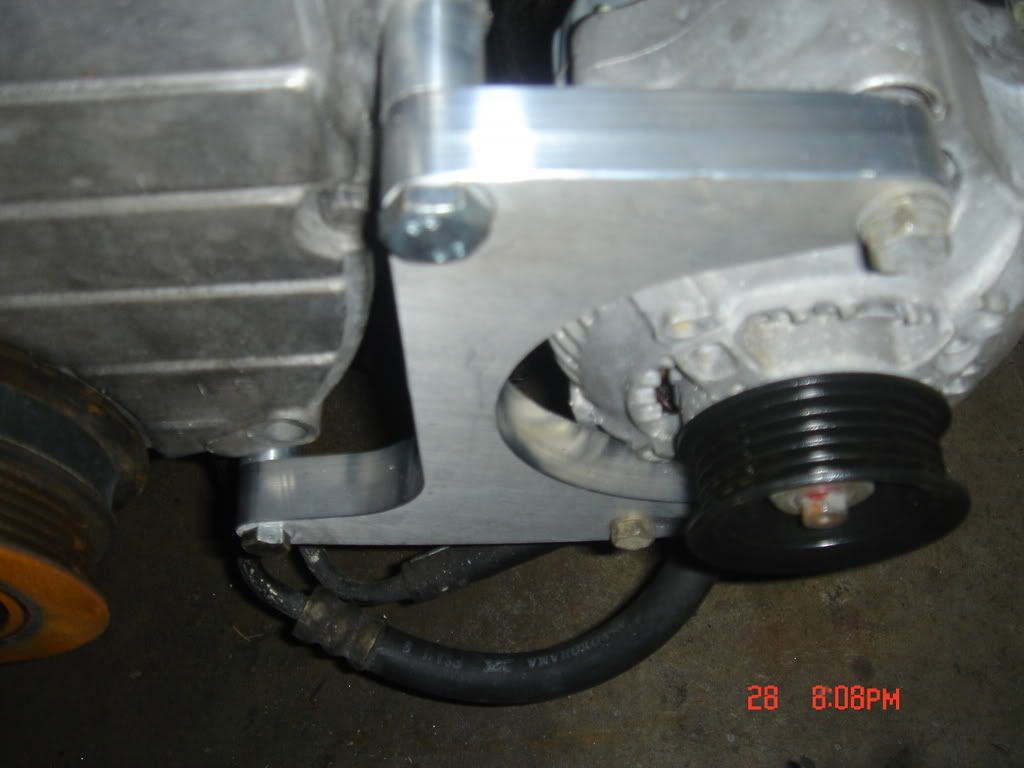

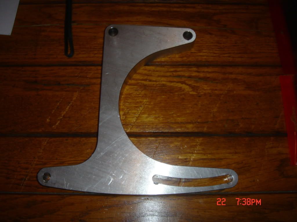

And i finaly finshed my alternator relocation bracket. Well kinnda i still have to figgure out the spacers and get bolts but its almost done.

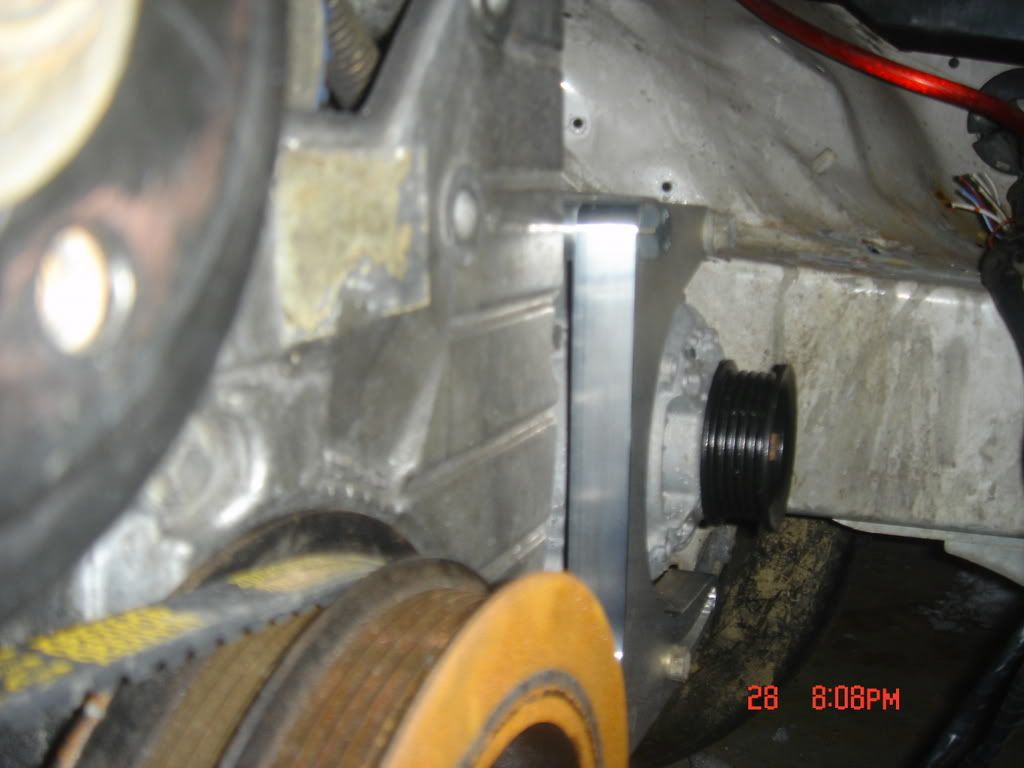

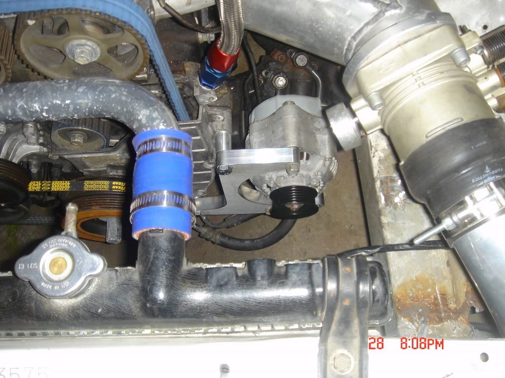

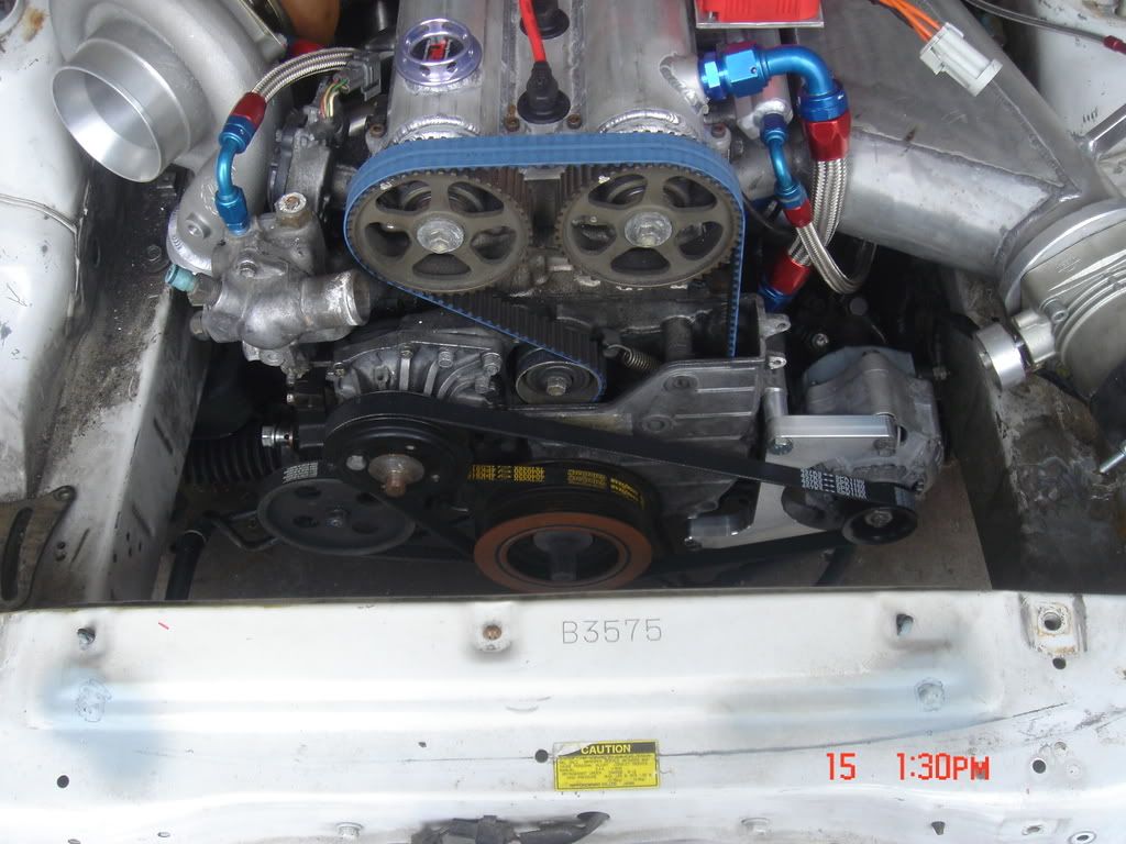

Ok well i went out ther last night and worked on the car for a bit. I removed my old altenator bracket then instaled the new billet one and put the altenator back on now i just need to go get my new belt.

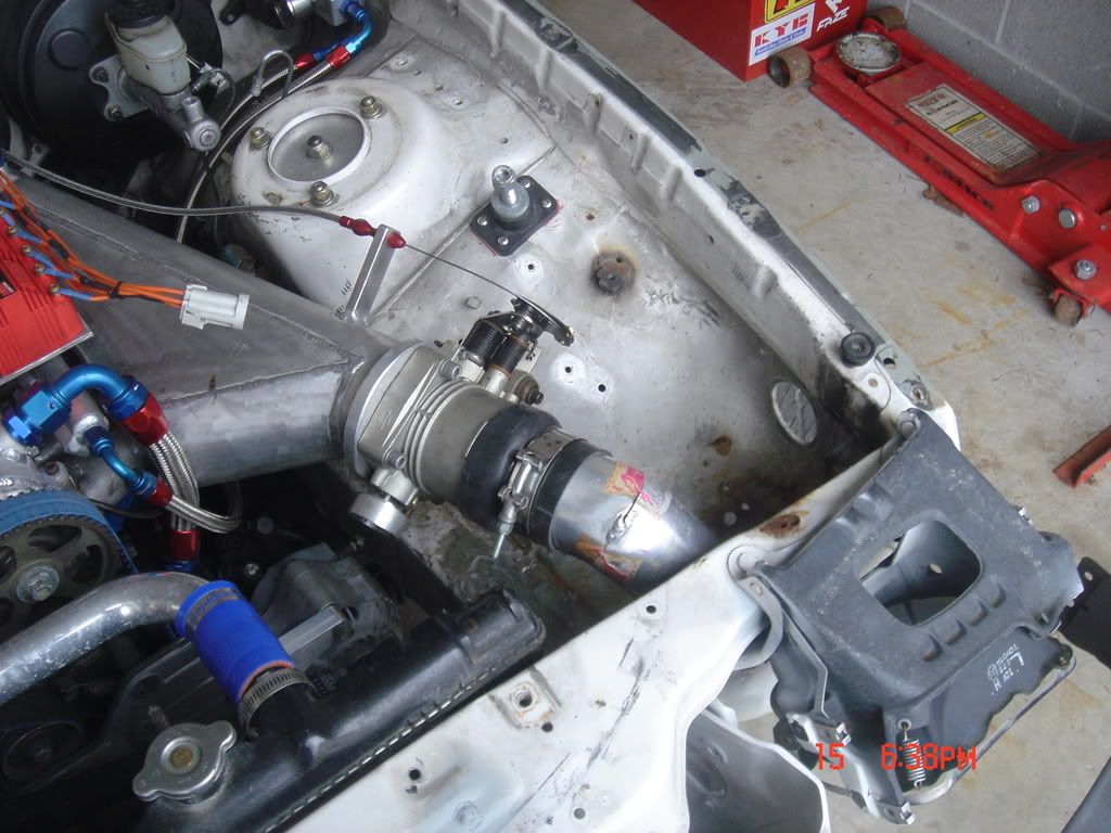

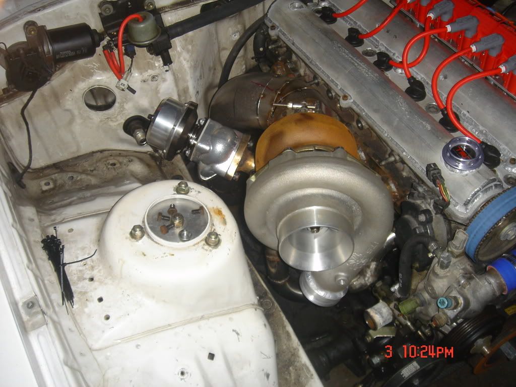

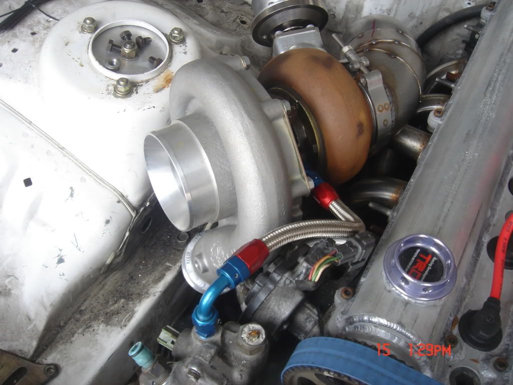

Ok now for a real update i put the turbo back on today and started some ic pipes got pretty far. They are over at my budies house geting tacked up.
Got more an fitting and many more to come.

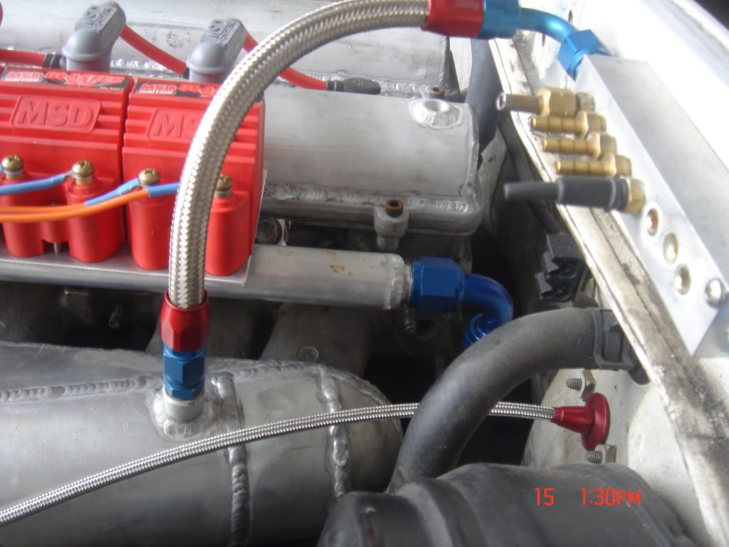

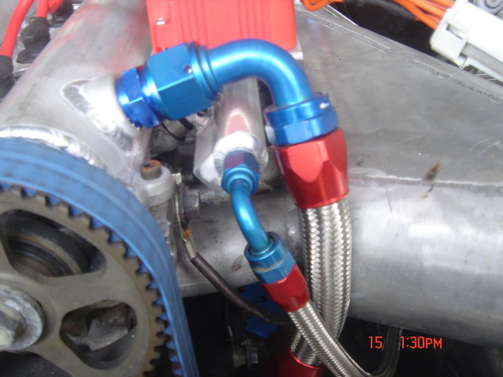

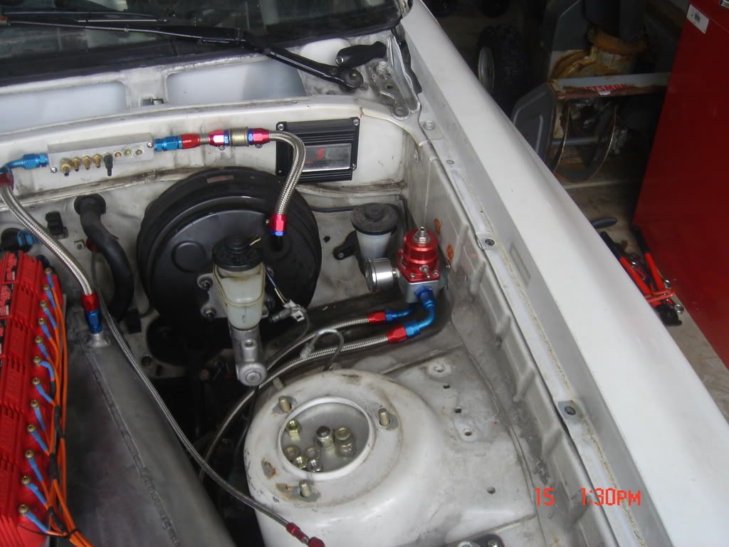

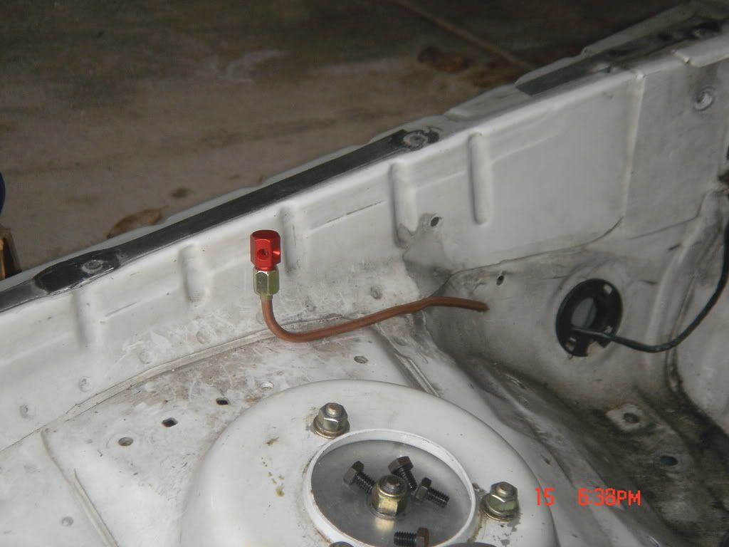

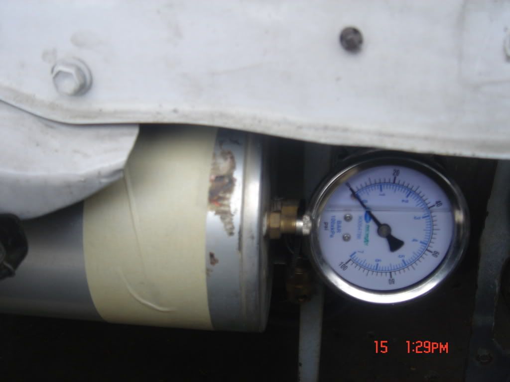

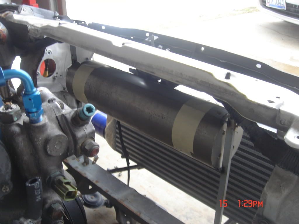

Well i did a bit of work on the car today. I fabed up the mount for my oil accumlator. Now i need to order the tbolt clamps for it.
Ran one of the coolant line for the turbo
Put in the massive fuel rail.
Made and ran more lines
Pulled out the fuse box the right way unpluging all the wires not cutting them so i can relocate it.
And i started plumbing the fire suspression system.

did you weld that fitting for the AN to the block? keep forgetting wat the correct name for that hose is...
