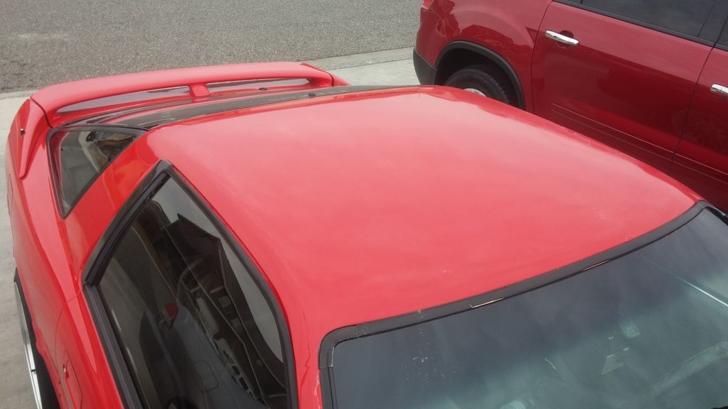

I went through all of your pics but can't seem to find a clear shot of the roof. Is your car a true hardtop? No sunroof/moonroof?
I ask because people would say their car is a hardtop but would actually have a sunroof. Hardtops seem rare as is, let alone on the 90+'s.
sheedy126
Boost Addict
Apr 30, 2012
716
kennewick
Yes sir, it's a true hardtop with no sort of sport roof. Although I'd love to install a sunroof, I don't really want to mess with the factory aspects of the car to that degree.
I snapped a picture of the roof for you.

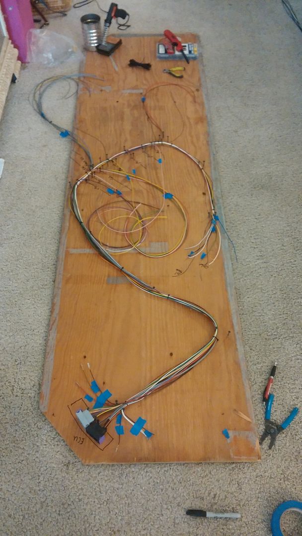

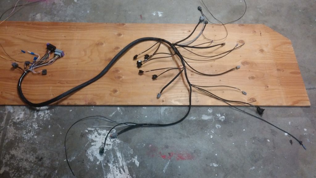

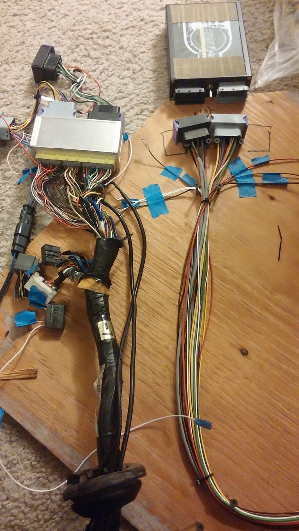

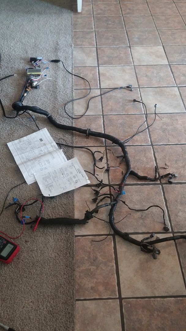

I also got quite a bit done on my new wiring harness to the Emu. I eliminated a ton of wires that weren't needed too

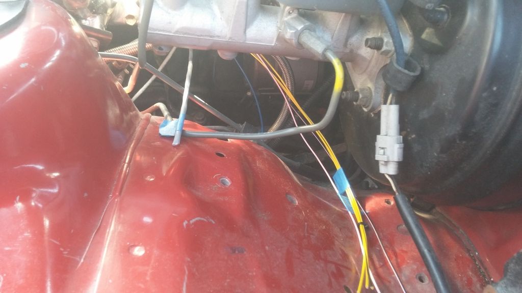

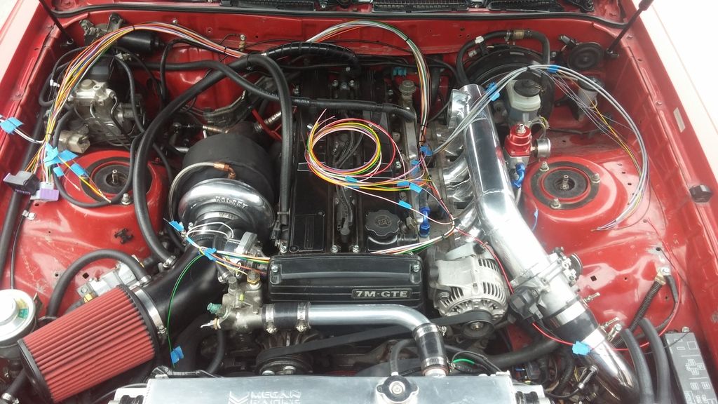

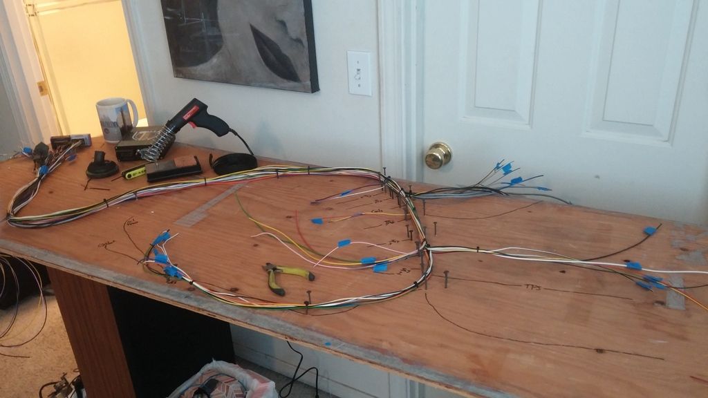

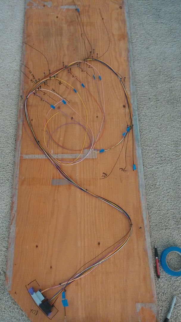

I laid the new harness out over the engine and start marking /cutting each wire to length on each sensor. I added a couple inches to each, already somewhat long, wire just in case I decide to move the harness to a slightly different location.
I'll be using a 3 pin deutsch connector for the CAS. I couldnt find any factory 2jzge distributor connectors sold in a single pack, only 10+ minimum order unfortunately from some website I've never heard of.

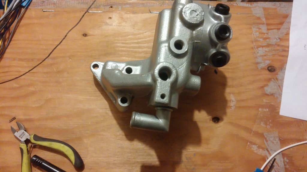

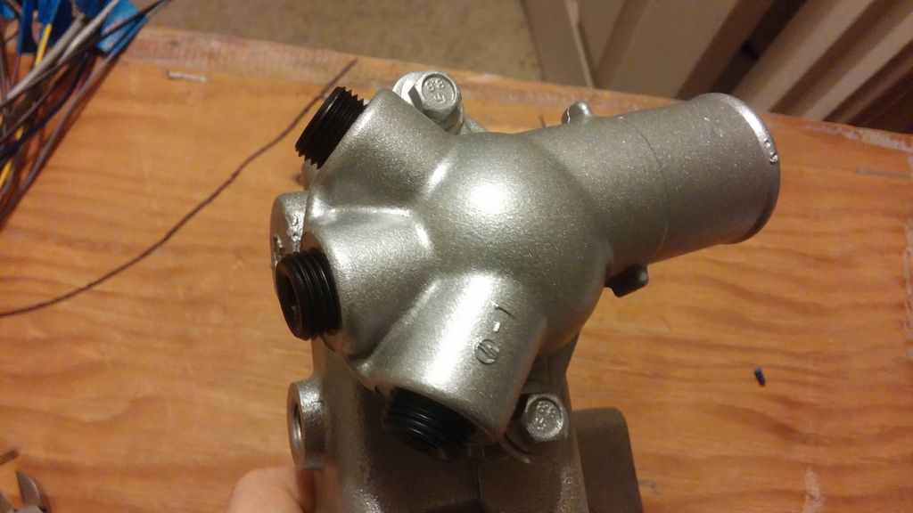

My water neck came back from Powdercoat too. I think the color turned out great! It's a silver/aluminum metallic color and really sparkles in the light. I can't decide if I want to Powdercoat my lower intake manifold the same color, or Polish it to match my upper runners.... Decisions decisions..

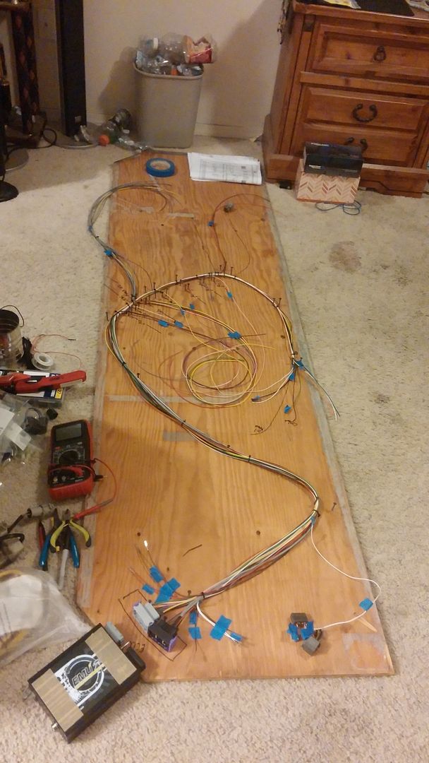

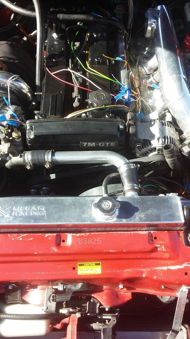

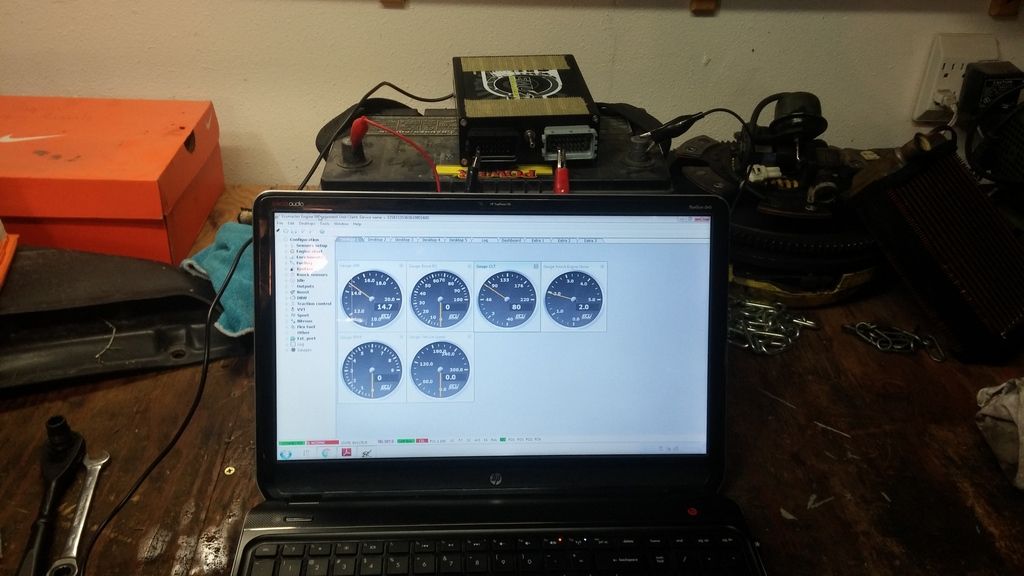

ID1000cc install - CHECK
Updating firmware on EMU - CHECK
calibrating new sensors/injectors in the emu software - CHECK
man im glad i picked up those injectors when i did, i couldnt imagine paying 720$ for them.
i got the harness done and pins connected but i didnt wrap the harness or put connectors on yet.
the plan is to plug the clips into place, only the bare minimum to make it run, then fire it up and make sure its working properly.
once i know the harness doesnt need to be rearranged, i will wrap the harness and put the connectors on to its final state. man i sure hope everything goes well and i did this properly!

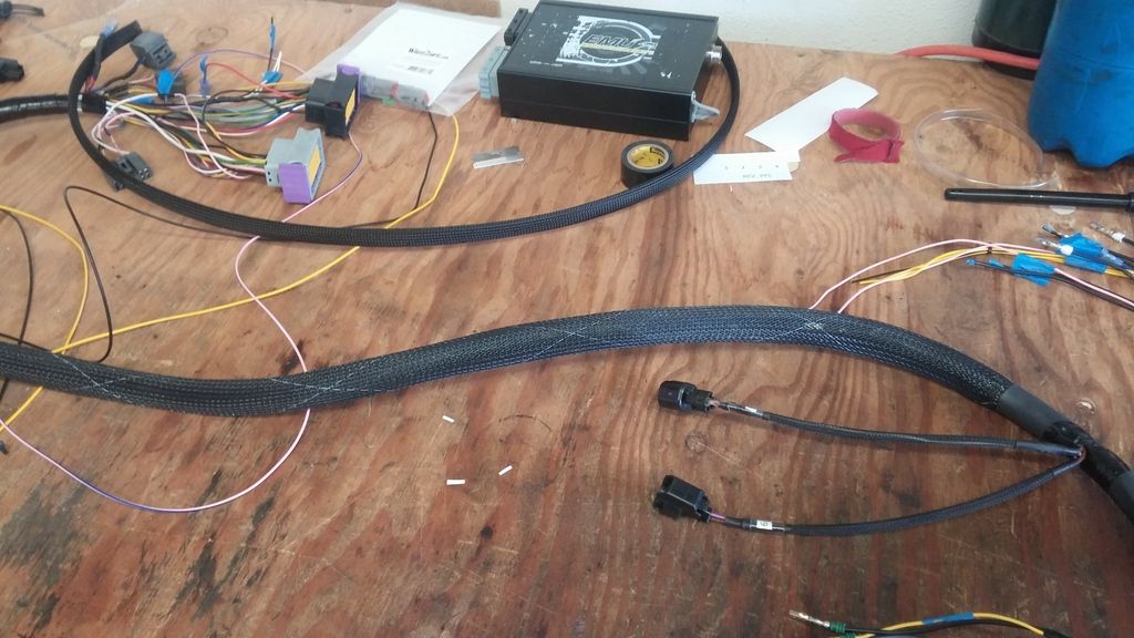

Car fired up for the first time today on the new engine harness.
It's still Un wrapped and exposed so the next step is to button it all up and put the nylon wrap over it.

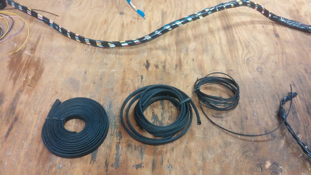

with the amount of time spent on it, i will probably have one made next time. its a good feeling have tackled a big job like this, but i think once is enough for me haha.

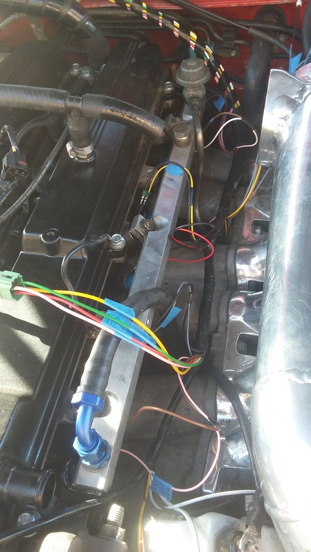

the rest of my nylon sleeving should be here on Monday, i thought i ordered the high head/flame resistant wrap but instead got the standard wrap. oh well, its not too expensive anyway.

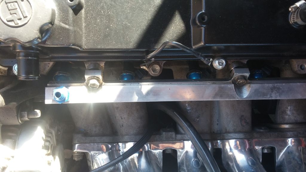

also polished up my fuel rail a little bit, much better than the crusty old piece.

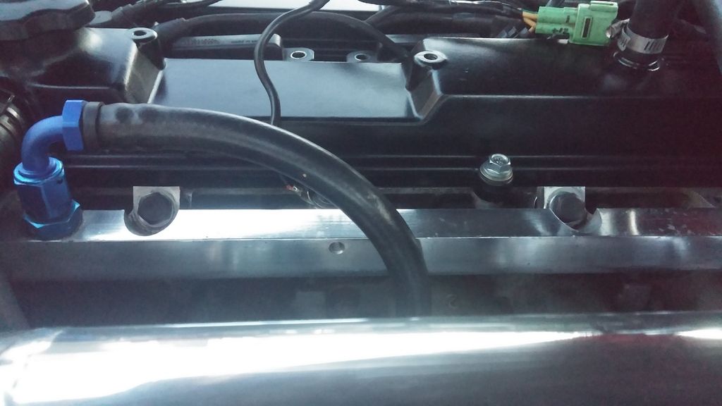

im looking into this catch can, its baffled with dual 12AN ports. 1/2NPT to 3/4 barb fitting will be threaded into the valve covers, i dont want to weld them on since they were just recently powder coated...
since im going to be running more boost, i figure i should upgrade my PCV system too
didnt note it before, but one of my favorite recent parts is the old school toyota logo oil fill cap. i took it off an old 20R toyota pickup engine i had laying in a parts box, i think it fits in perfect

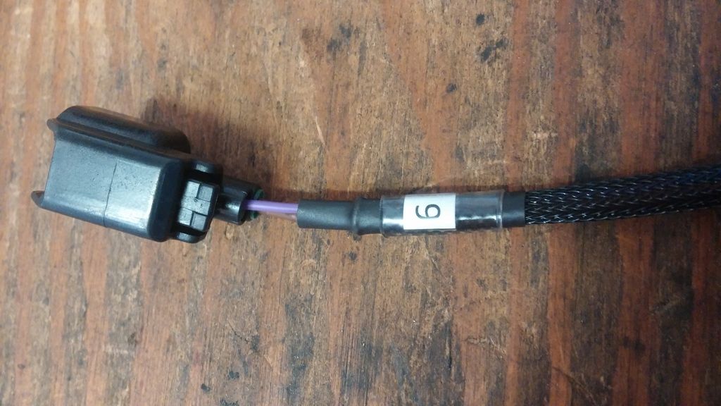

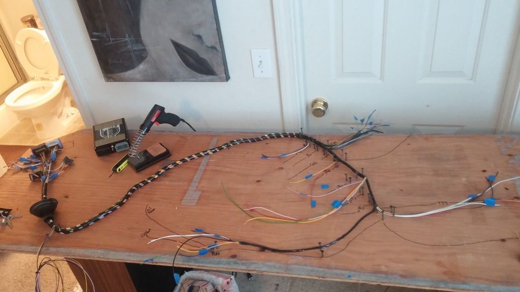

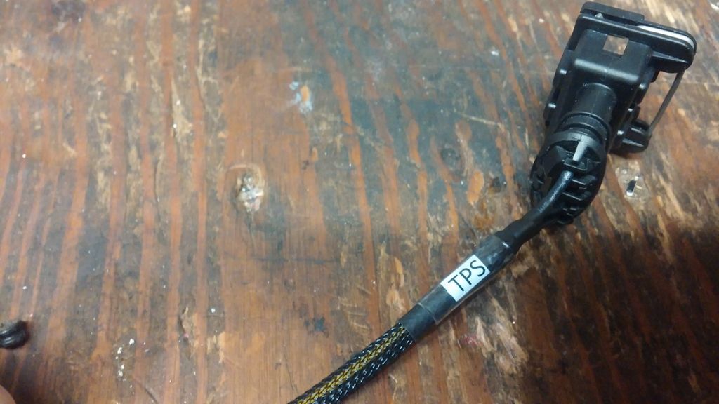

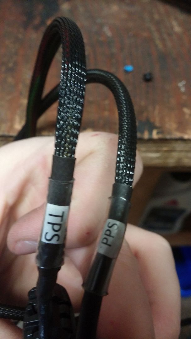

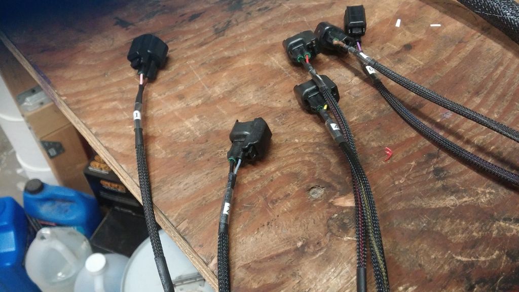

Some parts came in today so I put them to good use.
The tubing went on very well and I also labeled the injectors, tps, pps, and Cas sensors. Aren't really needed, but it adds a nice touch

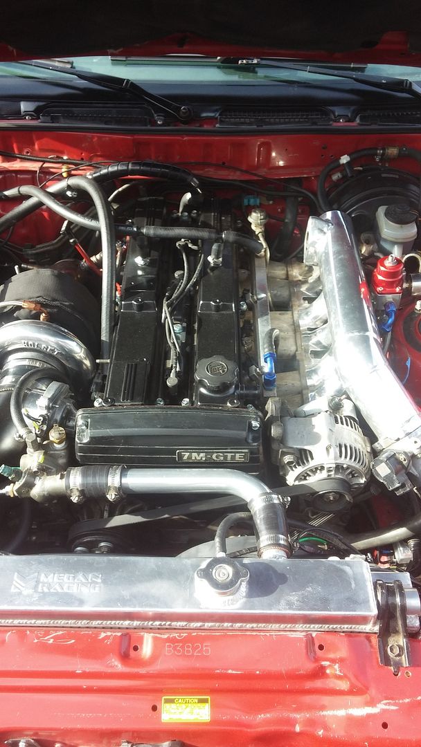

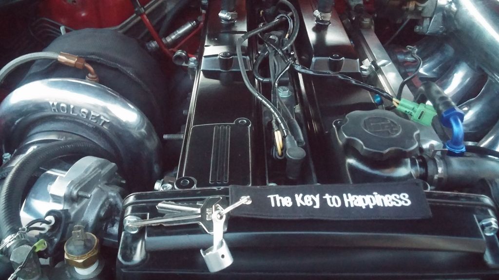

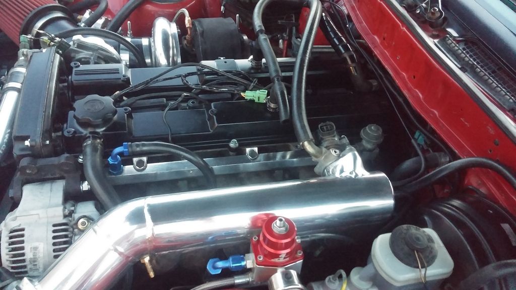

Just finished it up. Man, this has really paid off. It definitely turned out much better than thought it would have and cost 1/4 the price.
Next is to put the walbro 400 in and go back to psi for a tune. 500hp or bust. I think it'll handle that
Before :
After :
