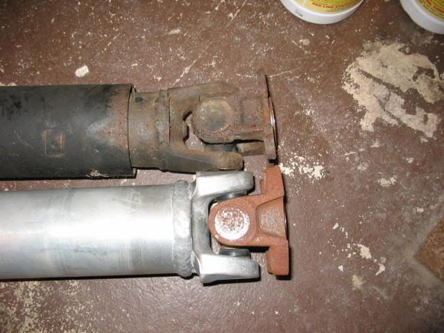

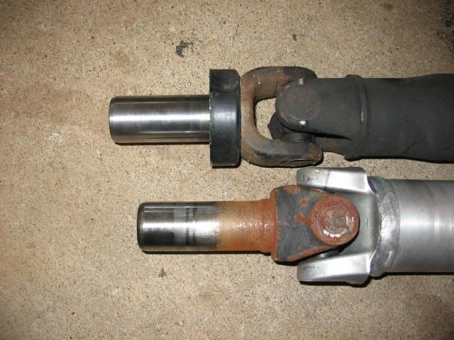

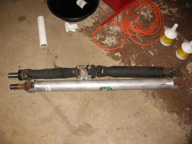

So, the DSS is out and I figured I would lay it side by side to the stocker and sure enough...
Of course I have some really high res ones if they request them as well, if you look really close you can see where the seal sits on both of them and how much less enguagement the DSS one has.
From end of output shaft to diff face is 46 3/4 in, and from seal to diff face is 47 1/4 in.
jdub
SM Expert
Feb 10, 2006
10,730
Valley of the Sun
I've heard that DSS makes them short...well, here's the proof. Sure am glad I got mine from Jaws :x:
