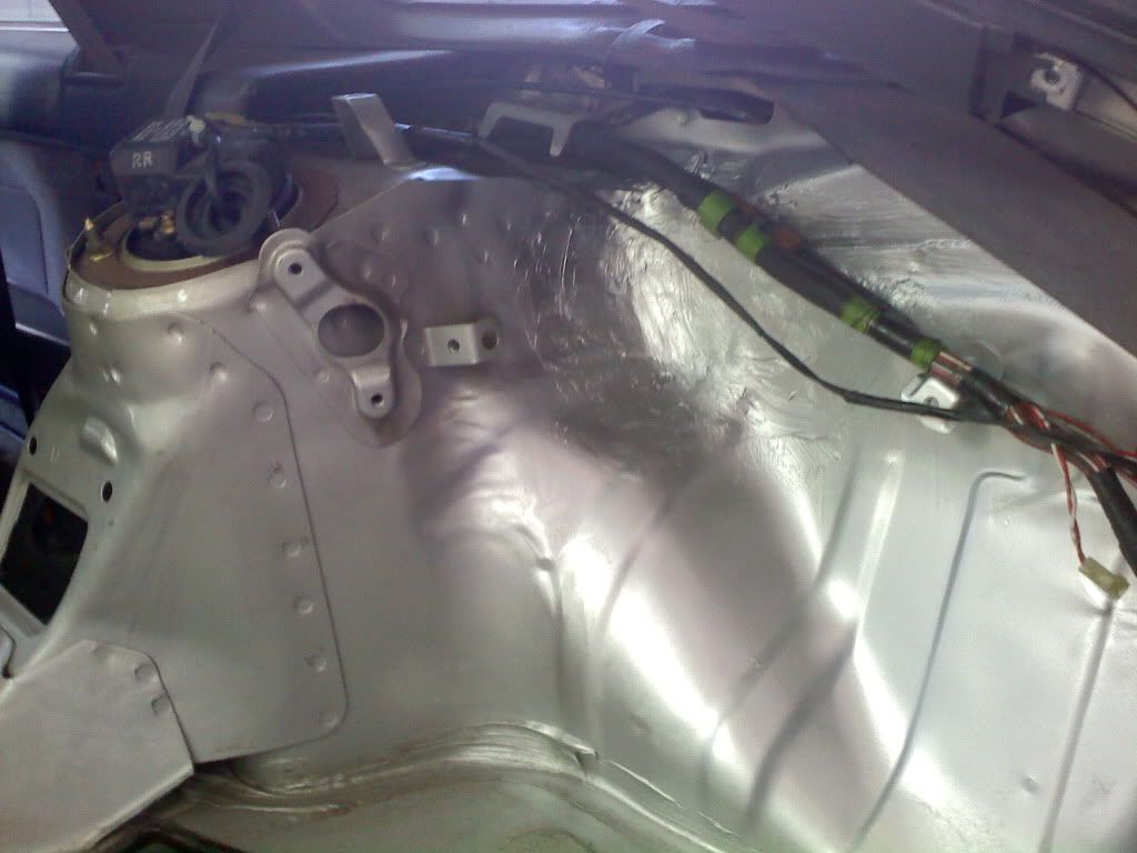

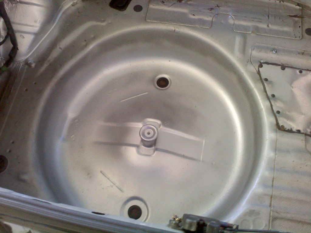

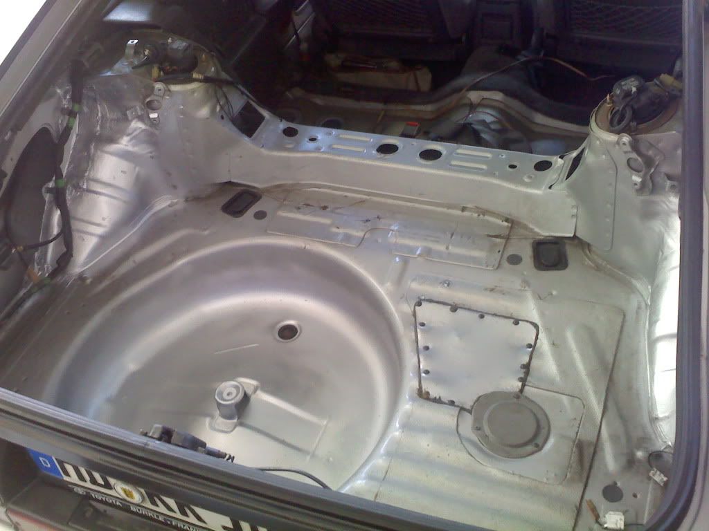

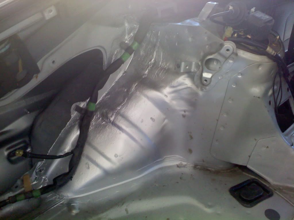

Just found same crap on my Supra 2 days ago! Removed the rear speakers and found the cancer but the amount of rust was small.
Didn't waste a second. Took the car this morning to the body shop (don't have the tools or the knowledge to repair it myself).
Just got it back (paid the shop $200). Rust free! Got some pics.. They did a nice job.
Anyway... If it is not very bad with only a small amount of rust,everybody should repair it! Not just to save another mk3 Supra from
the scrap yard but because it's your car and you like it and you'll do whatever to keep it clean and in good condition....rust free indeed.
Left side
Right side
Spare wheel location
Trunk view
Good luck with your car man. I know that the final result will make you happy!
