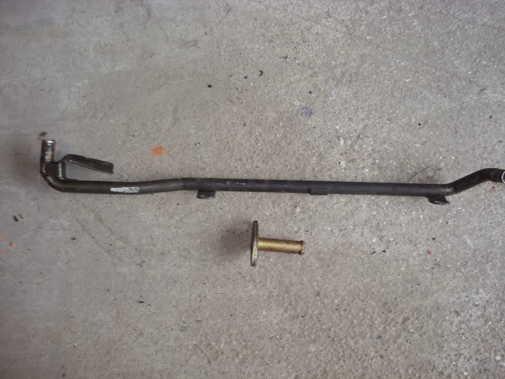

The person I got my GTE from had the coolant bypass tubes modified to cut out the heater circuit. Here's a pic of the modified upper tube, and blocked off lower tube.
(I still have the tubes, and I'm open to offers if you want them).
