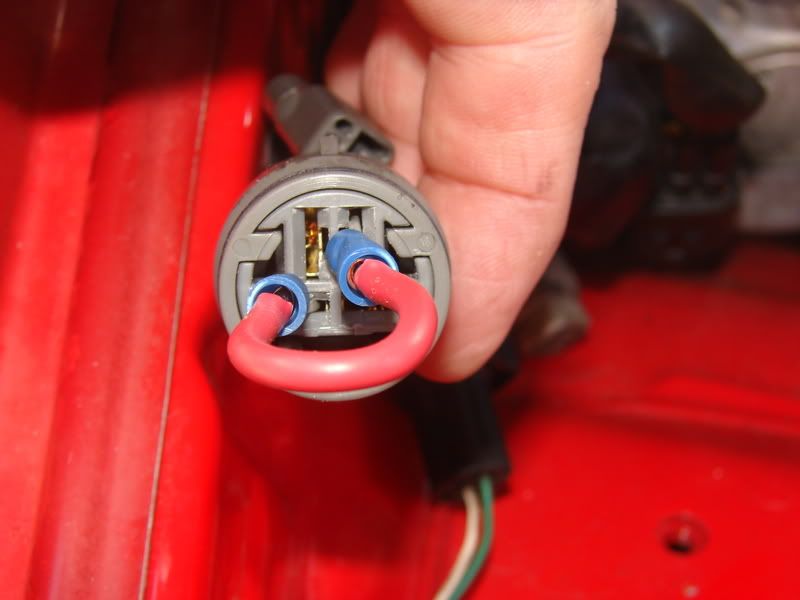

Here's a jumper for the fuel pump relay. If we jumper them all, you should get fuel, right?:biglaugh:
i am not getting power there. i checked the main efi relay and it is sending power out but for some reason the fpR is not getting power to open the cor....so what now...
